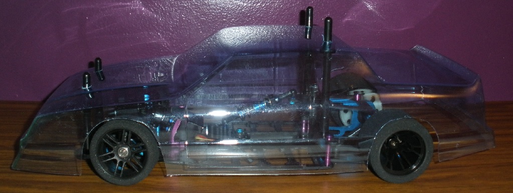

Not your everyday pan car...
I decided to go with this body, downforce won't be as good as the usual pan cars you see, but still should be pretty good...and once I've painted it up like a Buick Grand National, it'll probably be the most bad-ass-looking car on the track.

If that's the TBG, I sent them that one

It is indeed. So, thank you too! It'll take some work to make it *not* look like a 'Carlo, but I have some plans up my sleeve. Oh and by the way, the body fits this RC12L3 chassis & wheels almost perfectly! Tires nice and almost flush with the wheel-wells.
