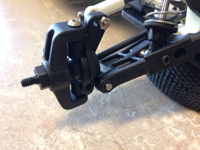

Progress report for today...
Trans spaced out, topshaft braced and no machining or special parts needed except my brace
Front caster block modified for width and caster. Currently at 6 degrees measured on the car. This part will be one of the custom parts made for this version, along with the trans case and possibly the rear bulkhead

Nice work on the motor mount spacer/support.. what size bearing is that in there?? I have a jrx2 that I want to add a bearing to support the slipper shaft... also the front trans looks great.. I have been looking at pictures of the MIP part to see what they did to get the profile lower in their version.. going to see if the instruction manual is available in the scans section or online.. I think I remeber seeing someone who did a model of theirs on here.. I am going to keep searching to see what they did to help in the developent of yours..
