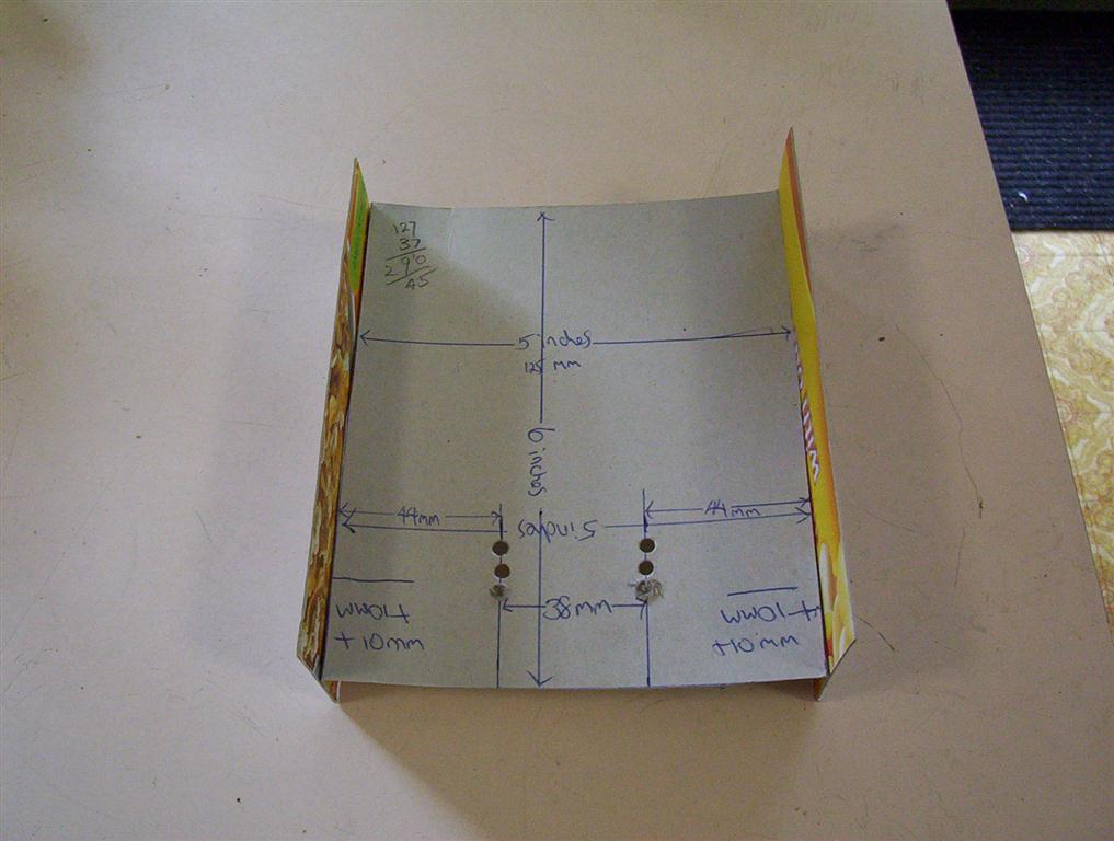

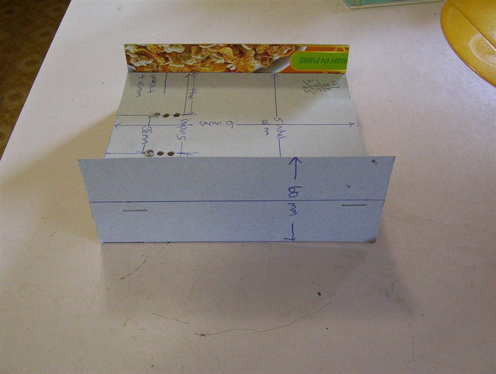

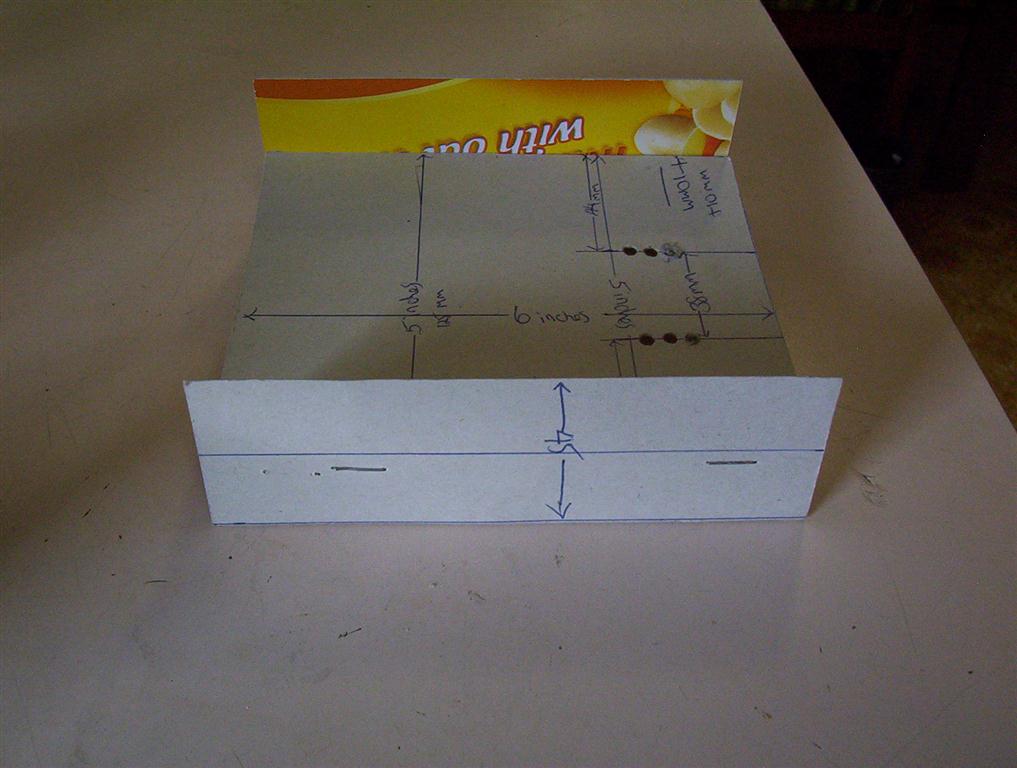

Re: Dave's BBT Sprint Car Project
Hi Guys,
I thought I would post a pic of the design for the wing for my car, I tried to make it as close as
possible to the car in this magazine review.
http://www.rc10talk.com/viewtopic.php?f=80&t=12699
As you can see it is a very simple design, that's o.k by me should be easy to make.
Cheers, Dave.

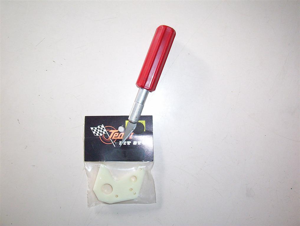

Hi Guys,

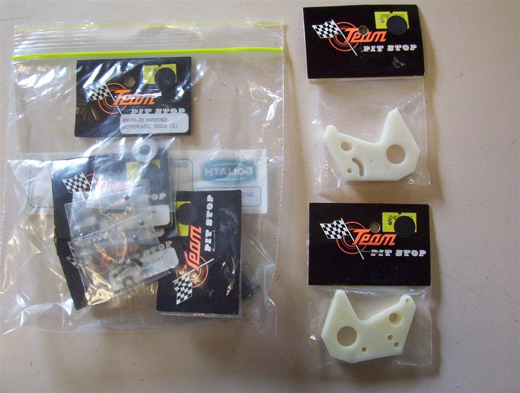

The TPS trans parts that Stephenianjames kindly gave to me have arrived.
Thank you very, very much Steve.
Now I have a problem the trans cases are NIP and I'm having trouble convincing myself to open the
packets to continue the build, has anyone else had this dilemma?
Here is a pic they are only NIP once!
Cheers, Dave.

What a top bloke that Steve James is
Mate, you'll probably laugh at this but my remaining 2 case halves are out of the packet! I wasn't fussed so sent you the NIP ones...open them...OPEN THEM NOW! Re-seal the wired-together parts in the pack and only a trained eye could tell the difference....

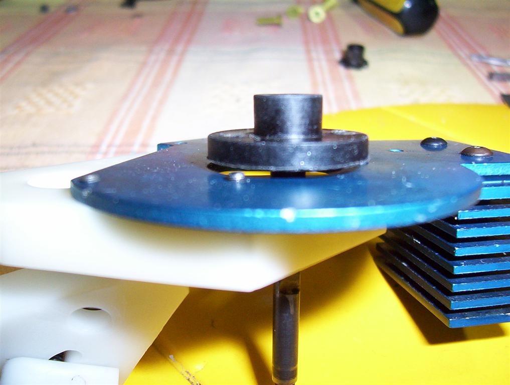

Hi Steve, Hi Guys,

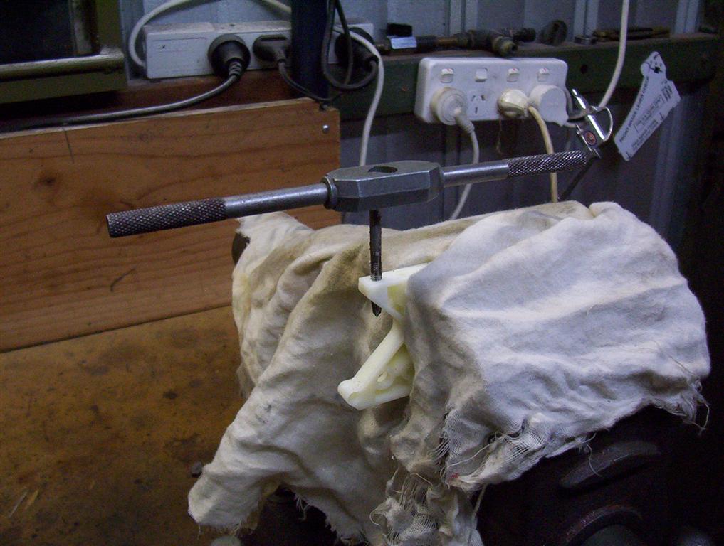

I had a cup of tea, and a lie down, after I got up I still could not open the packets.
I took my dogs for a walk, made my dinner then after dinner I sat down looking at the packets.
My hands shook but I knew it had to be done, anyway I could always blame Steve, he said to do it
After the deed was finally done, I did tap threads into the screw holes, the plastic is very thin around
the holes, so just forcing the screws in would just cause it to split again in the future.

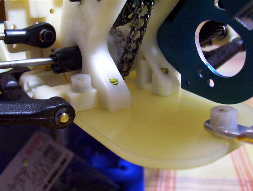

In the second pic, the top shaft had a lot of end play, an associated 4-40 aluminum
washer fitted perfectly behind the top shaft bearing on the motor plate side, I just had to take the
hole in the washer out to 4mm.
That fixed the end play and also stopped the spur gear hub from rubbing on one of the gearbox to
motor plate bolts.
Cheers, Dave.
motor plate bolts.
Cheers, Dave.

Beautiful!

Very clean, nice work!

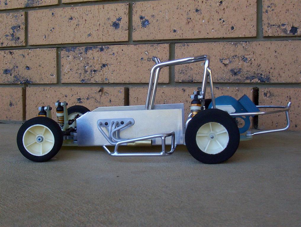

- Posts: 1254
- Has thanked: 750 times
- Been thanked: 26 times
Hi Guys,
Thank you for the vote of approval, it means a lot to me.
I have made the wing and sticker-ed it, I will try to get a pic later today on the car.
Cheers, Dave.
Cheers, Dave.
