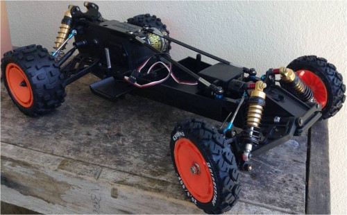

A few pics of the Kyosho Raider Pro I am rebuilding. Just started this a few days ago. Working on cleaning it up and checking for any broken parts. She is mostly complete but I need to find a few things. I didn't have my DSLR with me so I used my cell phone camera, hence the poor quality.

Looks like you're off to a good start. Parts for these are plentiful so you shouldn't have much of a problem in that respect.

Well I scored a whole bunch of spare parts for a Raider on Ebay yesterday. Should be just about everything I need to finish this build. Finished cleaning and rebuilding the entire suspension and gearbox so not much left to do. Hopefully I have it finished and running by this weekend!

Got mine from a flea market, got everything, the manual, the body shell, battery and controls. This thing is in brand new condition. From the looks of it, it was only built and never run. I did not know anything about kyosho vintages and got it for those gold shocks, got it for $30 only. I was surprised to learn that these were not kyosho gold pressure shocks, but they are just as good I would say, smooth machined shock bodies and all. I have taken the MSC out, cause I plan to put in an ESC. Keep us posted with your project :D
