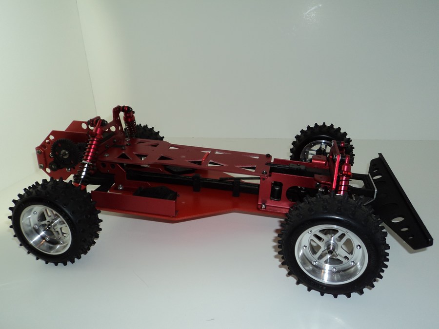

Hi Guys,
Needs some opinions and help here.
I just purchased an incomplete Hot Trick optima. Car is missing the main chassis, shocks, bumper, wheels and one front hinge pin. My main concern is the chassis, can I use a standard optima chassis? Ideally I would like to make a carbon fibre top and bottom chassis but would need a hot tricks for a template,are these hard to find? below are the pics I pulled from ebay as I haven't received it yet.
Thanks
Rob

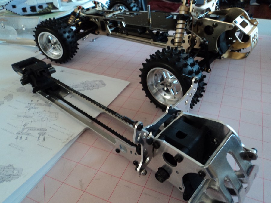

RedScampi
Posts: 2157
Location: Bonney Lake, WA
Re: Hot Tricks optima
Post by RedScampi »
I do not believe that the Hot Trick pieces will work with the standard Optima chassis rails. Take a look at the manual (avail online) to see how the front and rear components fasten to the rails. The Hot Trick parts have an "L" at the bottome to accomodate the flat chassis pan. See this for comparison:
Gary

RedScampi
Posts: 2157
Post by RedScampi »
One thing to remember when using Easy Off is to not let the parts sit in it too long. It will attack the aluminum in a short period of time and make a real mess of it. Ask me how I know!
Gary

Coelacanth
Posts: 7421
Location: Alberta, Canada
Post by Coelacanth »
RedScampi wrote:One thing to remember when using Easy Off is to not let the parts sit in it too long. It will attack the aluminum in a short period of time and make a real mess of it. Ask me how I know!
Good point...it really doesn't take too long for the anodizing to come off, and a toothbrush can help remove it from the more hard-to-reach places with less time to soak in the Easy-Off. As soon as I was done removing the anodizing, I would rinse off the parts in hot water. I later wet-sanded and polished the parts before sending them off to be re-anodized, but if you prefer the dull matte finish, I'd wet-sand them with 400 grit and call 'er done. If you want shiny anodizing, and you want to remove flaws like minor scuffs & scrapes, it's a lot of work--but well worth it in the end. Anodizing doesn't hide any flaws; if anything, it enhances them.
caesar
Posts: 368
Joined: Fri Oct 21, 2011 6:04 am
Location: Melbourne, Australia
Has thanked: 183 times
Been thanked: 174 times
Post by caesar »
It's been a while, but I finally got a chassis for this. I still need to remove some stubborn red anodizing and finish polishing before sending it to get anodized in gold.
Chassis and shock towers are going to be made in carbon fiber, just need to find someone to do it.
