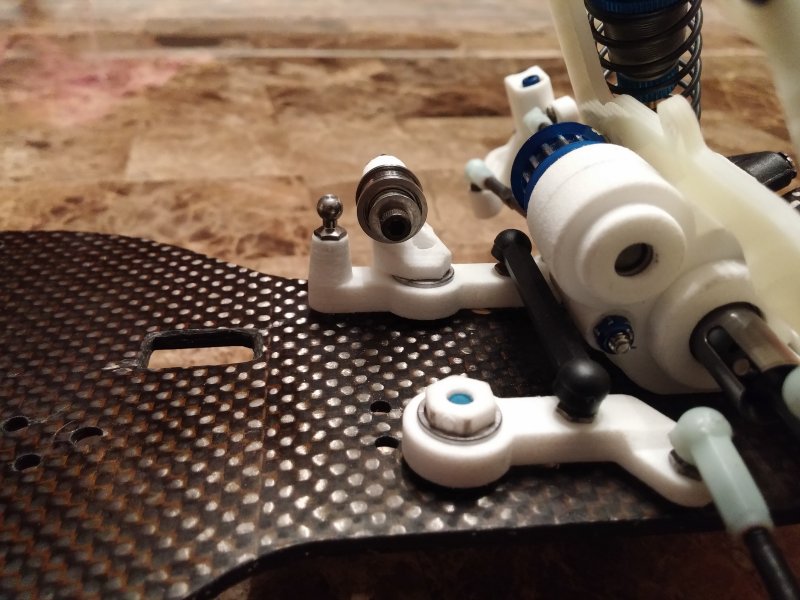

Ok, I think have something better than the shock tower tensioner mount. I designed this one to go off of the steering nut. I mounted the tensioner on my rere and took measurements in relation to the steering nut. Should be very close to same location and more stable with no flex. I'm going to order both to see what I like better.

Since you have to run the servo horizontal to the chassis centerline with that bellcrank, I think I would design a servo mount that incorporated it (if it would work). There would be at least 3 mounting points in it so it should be solid.

the MIP setup if you recall used a stick on idler/guide on top of the servo, so yeah, integrating into the servo mount makes sense to me too. your idler part looks innovative, but maybe subject to loosening and twisting during use?

Shapeways finally delivered my left steering block and belt tensioner. I think this is going to work out real well. I have a few other designs printing now to see what works best. Now that I have the driveline all together, I measured 564mm for the belt. Jeff had said he measured the short chassis configuration at 573mm. So I'll order my measured size first and see how that fits.

Wow, that looks great! Nice job on the tensioner mount, looks like it should work well.

I'm surprised how good the mount looks in person. The 3d rendering definitely makes it look goofy

That looks amazing! I wonder if your tensioner could be twinned and mirrored, to tie into the other steering post? That should eliminate twisting.
