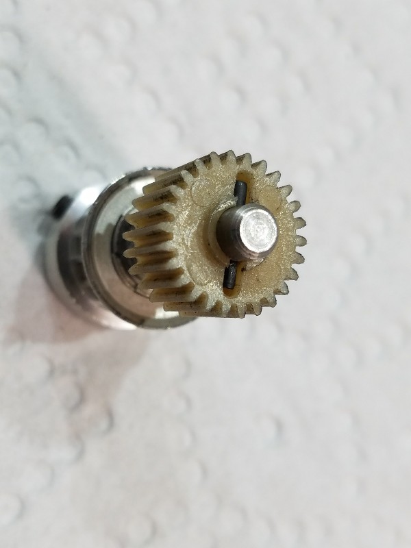

The Robinson Racing Ten4 shafts haven't been available for a little while. So I've decided to make my own. That opens up some possibilities, like adding a one-way bearing to the front pulley. I also found another source for the pullies that use readily available Imperial sized belts. I'm going to try a 1/8" belt/pulley system and see how it holds up. The first gen Ten4 used a 6mm belt, which is just a tad under 1/4". The thinner belts should result in a more efficient driveline.
While I'm at it, I plan to develop a new belt tensioner system. I might play with the front end geometry as well. All these changes together will be the Ten4.1 version. It should be pretty easy to convert an original Ten4 to a point-one for anyone who wants to.

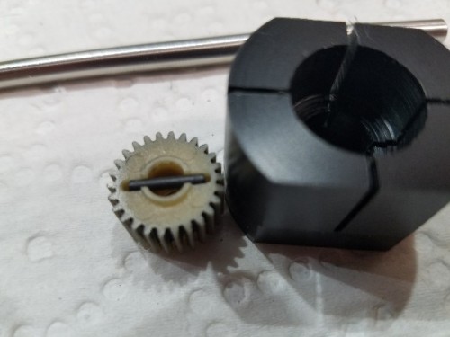

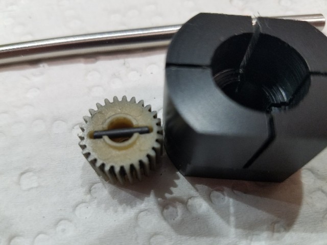

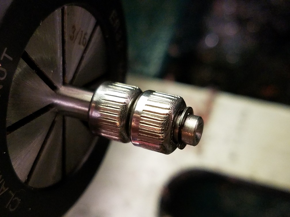

So far I have developed the fixtures for pinning idler gears to extended shafts. I also turned down a 3/16" shaft to 4mm to fit metric one way bearings. I also had to make a grooving tool to put the e-clip groove near the end of the shaft to retain the bearings. I will ream out the ID's of the front pulleys for press fit with the metric one way bearings.
Shaft turned down to 4mm with the e-clip groove added. I made it to use standard RC10 e-clips. Two one way bearings are a perfect width for the pulleys.

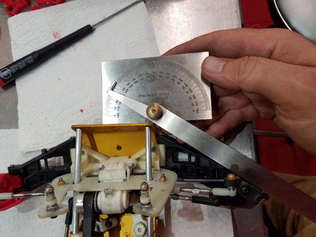

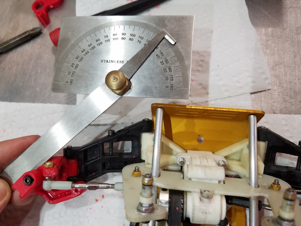

I made a little progress on the Ten4.1 recently. First, the steering. I modified the bell cranks, caster blocks, and steering blocks to get more steering out of it.
The Ten4 setup was only getting about 35 degrees of steering at full lock. This was due to the bell cranks hitting the transmission case and at about the same time the steering blocks hit the caster bkocks. The Ten4.1 parts allow a full 45 degrees of steering The new bell cranks are a bit shorter and swing further before coming into contact with the transmission case I spent some time working on a new belt tensioner concept as well. The Ten4 tensioner system is a bit hard to adjust and there is nothing to keep the top and bottom of the belt from hitting itself. Here's the new concept, which uses two bearings, one to space the top and bottom of the belt apart, to other to tension the belt from the bottom The new tensioner mounts to the front tube screw like the original one, but is an arm instead of an eccentric, and the tension is adjusted with a screw that extends down to the pan (I'll put a "foot" of some sort on the bottom of the screw so it doesn't mar the pan). Adjusting that screw pivots the arm to raise or lower the bearing, which makes it really simple to fine-tune the belt tension.

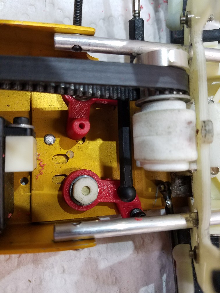

I still have some details to work out on the new tensioner, but I think the concept will be a big improvement. Not only much easier to adjust belt tension, but it will keep the belt separated the whole length of the car

I think you are overthinking the tensioner. Just do what 3D printers do

Maybe you could make a front servo mount that serves as a tensioner? Something that could be adjusted with shims. Not very practical but probably cleaner.mk-Zero wrote: ↑Sat Nov 25, 2017 11:29 am

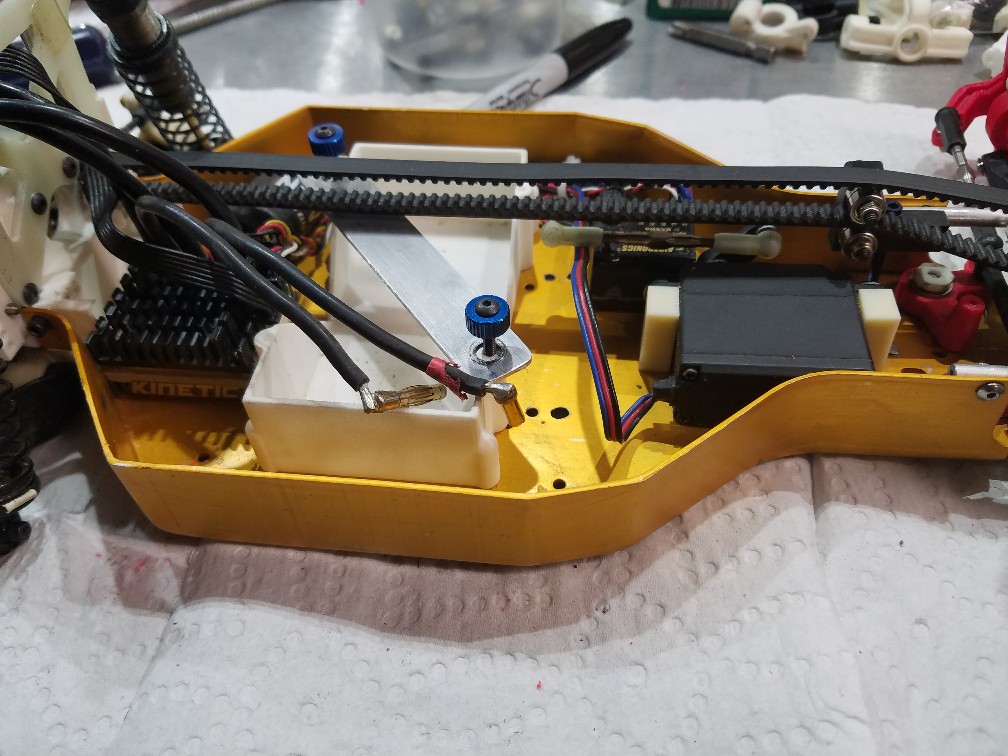

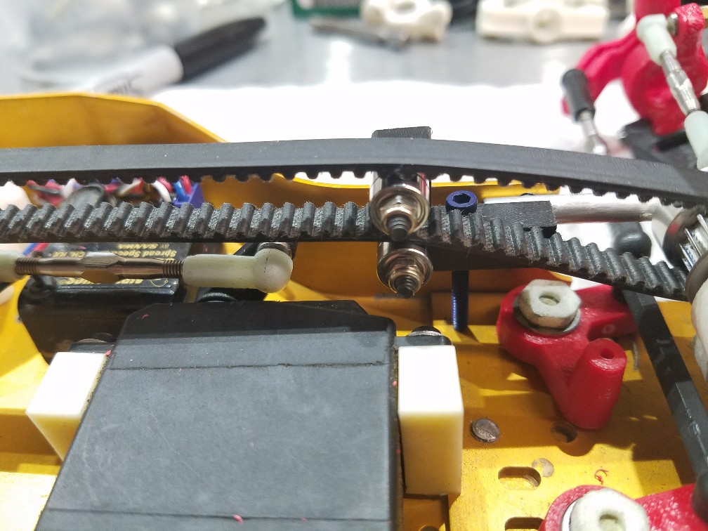

Also, regarding that second tensioner; maybe you could use a low profile servo turned 180? That could give you clearance under the belt and maybe you wouldn't need the upper tensioner.

Part of the reason for needing to get the belt up is to clear the battery as well.
