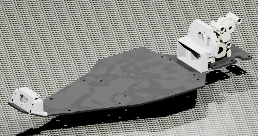

Well im starting to get somewhere. as an effort to help verifying my models. I've taken to printing out the faces at a 1:1 scale and comparing with the actual parts to verify the models.
I think I've gotten a version of the rear bulkhead that I like made up at this point trying to keep some influence of both nix and ten4 in it.
looks like a new top plate will be needed. its gonna be interesting to get the belt to go completely over it and back down to the transmission. If there is a way to add a pulley on the teeth side of the belt without messing it up; I'd sure like to know.
getting the carbon fiber parts added in is my next goal, then trying to get the front bulkhead figured out.
- Posts: 12335
- Has thanked: 1129 times
- Been thanked: 3917 times
Re: Dmat's Nix91 + ten4 build
You can use a standard toothed pulley as an idler, you just want to try to do most of the moving of the belt on the slack side under power (on the ten4, the top tensions and the bottom slacks) That makes it hard. Still, it can be done. You could always do a two piece upper like the first Lazer, one on each side. Then the belt wouldn't have to be moved. You could also do it like the A&L stiffner kit. Where the two braces are upright. Just some things to think about. It looks great!

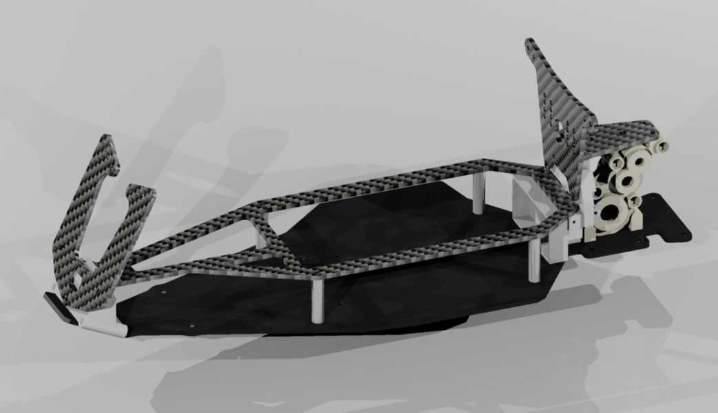

Got my carbon fiber bits added in. now to see about getting a front transmission in there. doubting it will fit with the top deck like it is though. it can be modified though.

Wow that is a serious endeavour! Looks like the top deck has been flipped 180 degrees?

so front transmission wont fit with the top deck as stock. seems like there is 2 ways to go about making this thing in the end.
1. raise the top deck enough to let the transmission sit in there. cutting bits of the top brace off will be required.
2. new top deck altogether.
no clue if anybody else might attempt to make this but I could use some opinions on this. I would think keeping the original top deck in tact would be the best way to go but a new top deck will also require someone willing to make them.
- Posts: 176
- Joined: Fri Feb 26, 2010 3:25 am
- Location: British Columbia
- Been thanked: 5 times
Looks pretty tight up front, you may need to integrate the bulkhead and tranny, but make it 4 bolt to not interfere with the diff.

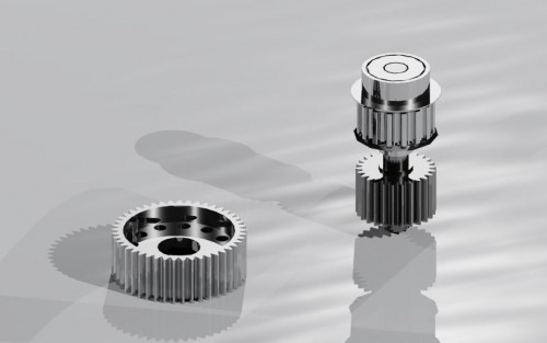

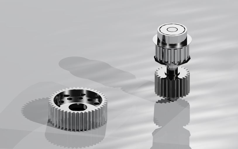

not much to really speak about. Just trying to understand the gear spacing in the transmissions since I was unhappy with my measuring results. decided to learn how they made and what controls their size and spacing. I'll get a topshaft made another day but for now this helps with the front transmission sizing.

just a few pictures of the almost completed transmission. I'll have to buy some parts if I want to finish it. Imaterialize will probably get an order here soon.
