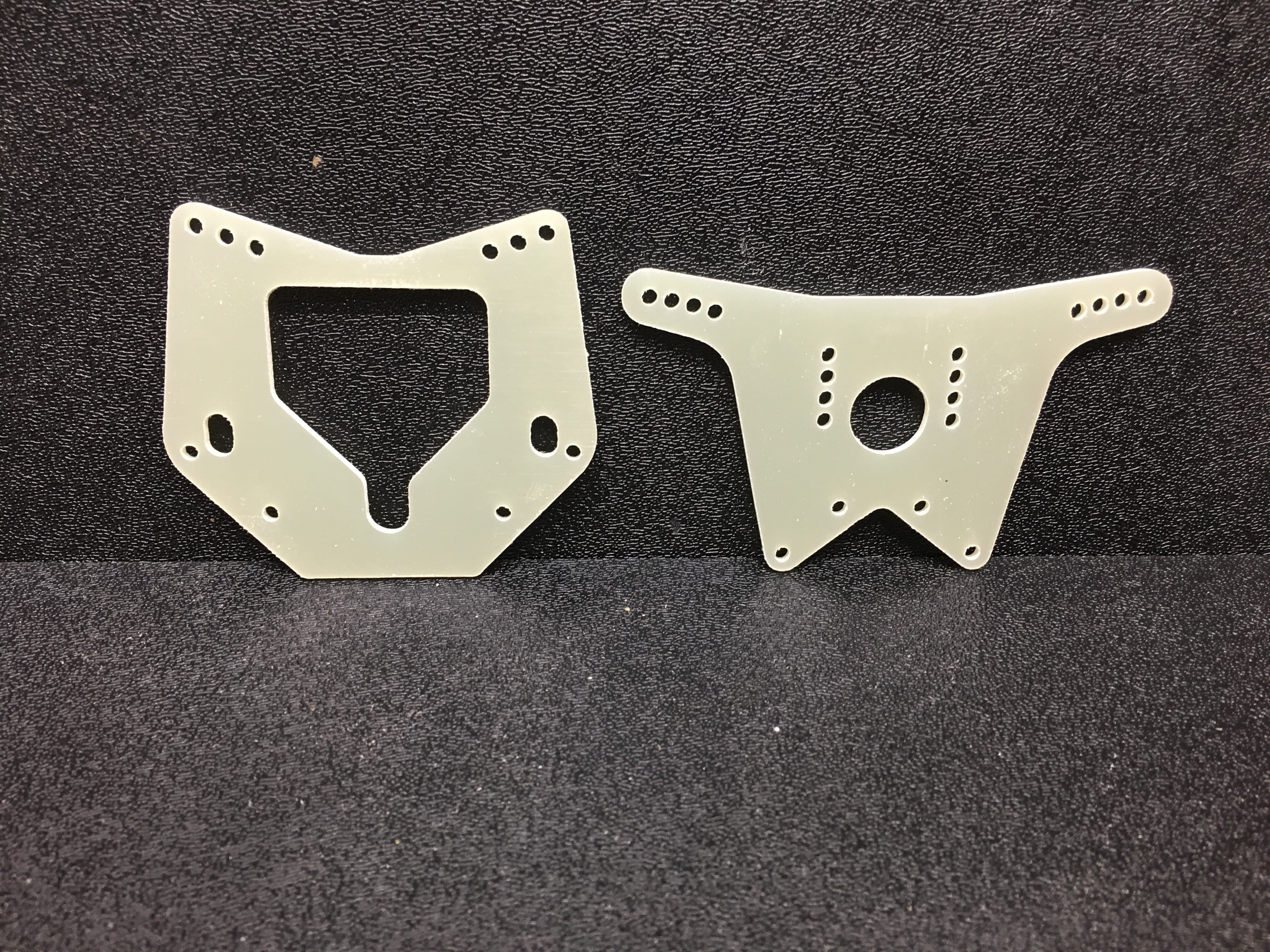

You will need a custom tower for buggy shocks. The printed template is for cutting your own for .71 shocks. GoMachV sells .71 or .89 custom towers pre-made.Dr1ven wrote:Will the Associated 7215 shock tower for T2/GT work for the conversion?

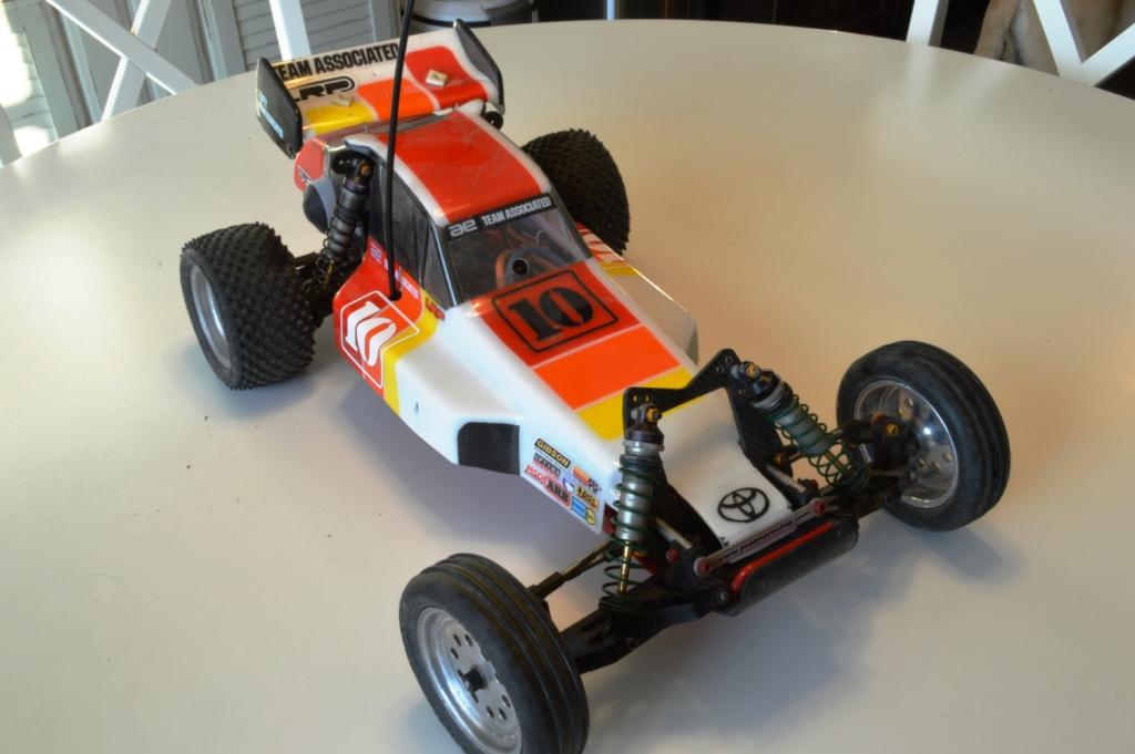

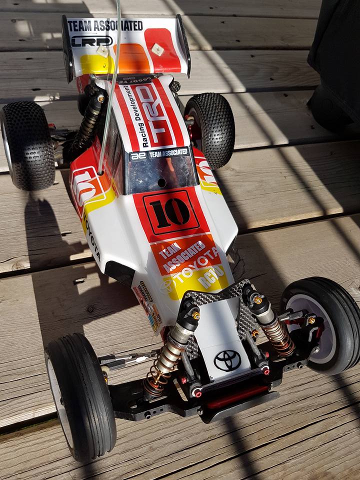

Lately I've been looking at my OIN build that I did many years ago and realized it's been a long time since it's gotten any attention. I think the thing to do is make it into a quadra-symmetrical RC10 so if I ever do make it to a VONATS than I can have a backup if the NIX91 breaks.
QUESTION: Can you use the first 3 holes in the nose plate (short wheel base) or do you use the last 3 holes (long wheel base) to achieve the correct symmetry? I think I already know, but don't want to buy another nose plate lol.
A pic for those not familiar with the car.
Recent changes while deciding what to do for updating it.

That's one of the best paint jobs I've seen in a while. Both original and eye pleasing.

If you need to proper Nix towers, I cut them. I can do carbon if that is what your after. G10 (natural or black color) is just a lot more forgiving.
The 119 tower you mentioned is for .89 shocks, where the quadra was set up for .71 worlds fronts. If you are going to run the longer .89’s that tower should work. Mine also come in all the lengths, including one that would reuse your 1.02 truck fronts (basically a RPM tower)

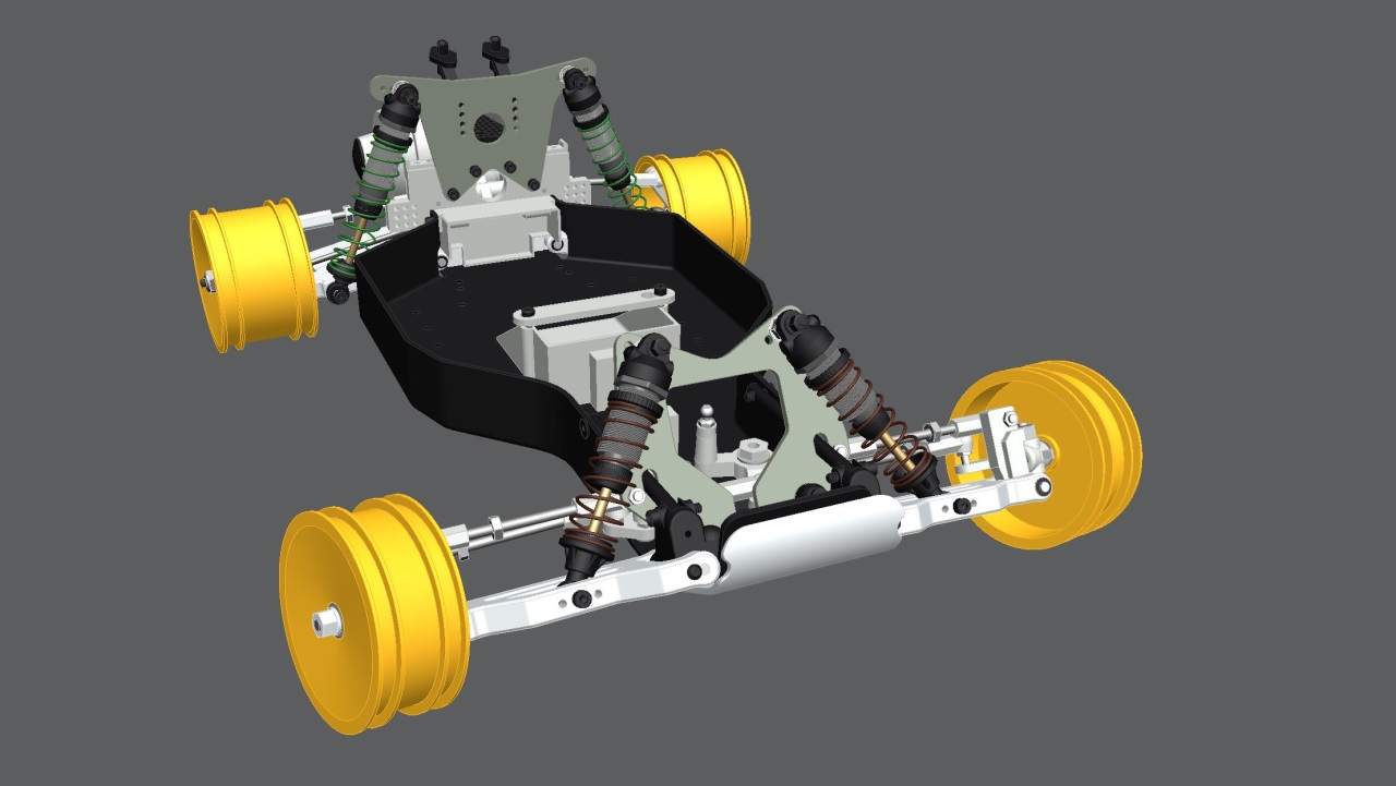

#9672 bones + #9755 axles + #9890 hexes together with zero degree rere-Worlds rear hubs (#7364 or similar).
New printing technology MJF now available on imaterialise. It's better than SLS. Also free shipment until Cyber Monday.
https://i.materialise.com/shop/item/quadra-v2-rc10-arm-set

I can make the towers for any size shocks, but the original spec is for the front .71 v2 shocks from the rere worlds car.

Towerhobbies says "Late Nov" for #7364 hubs. It's easier to work with original hubs (if available). SLS or MJF hub bearing housing most likely needs finetuning. It can be done but personally I don't like it. Sometimes there just is no option.

Drawing sent to GoMachV.
