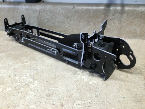

Re: Rear wing for Optima??
Clearly the easiest way is to simply reengineer the whole platform
(But the tower fits a stock car also and adapts modern wing mounts)
