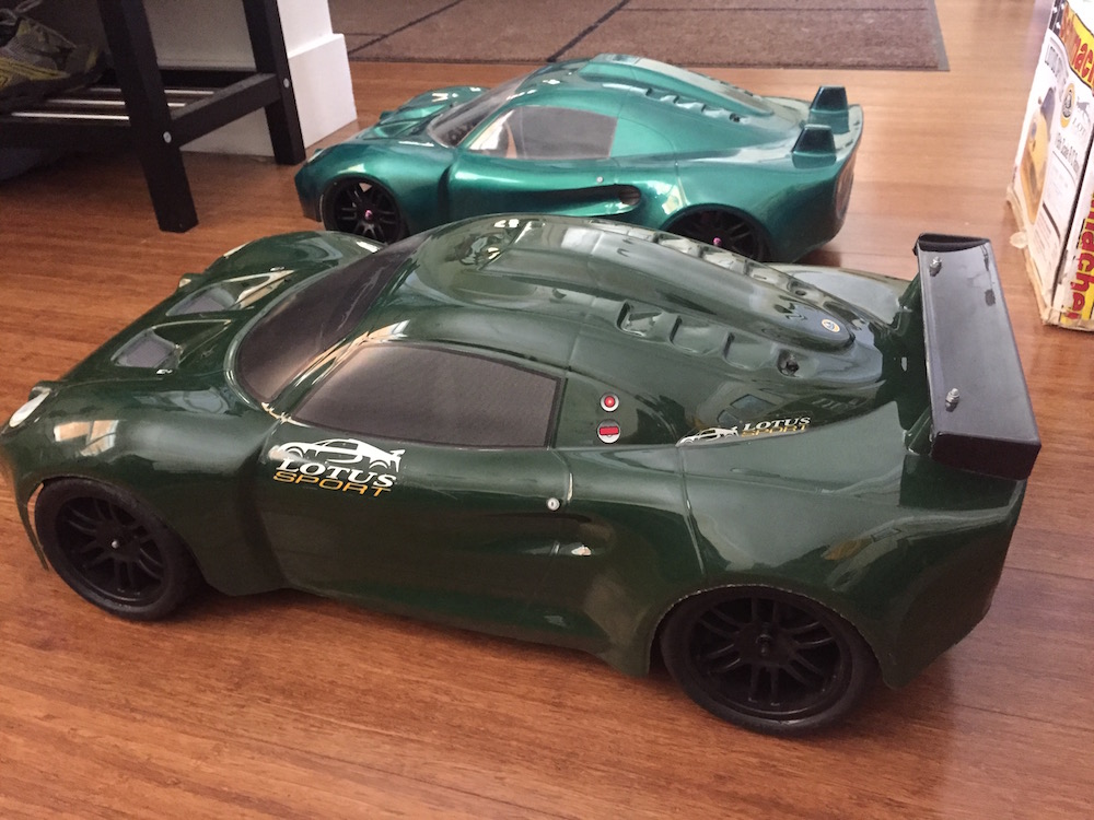

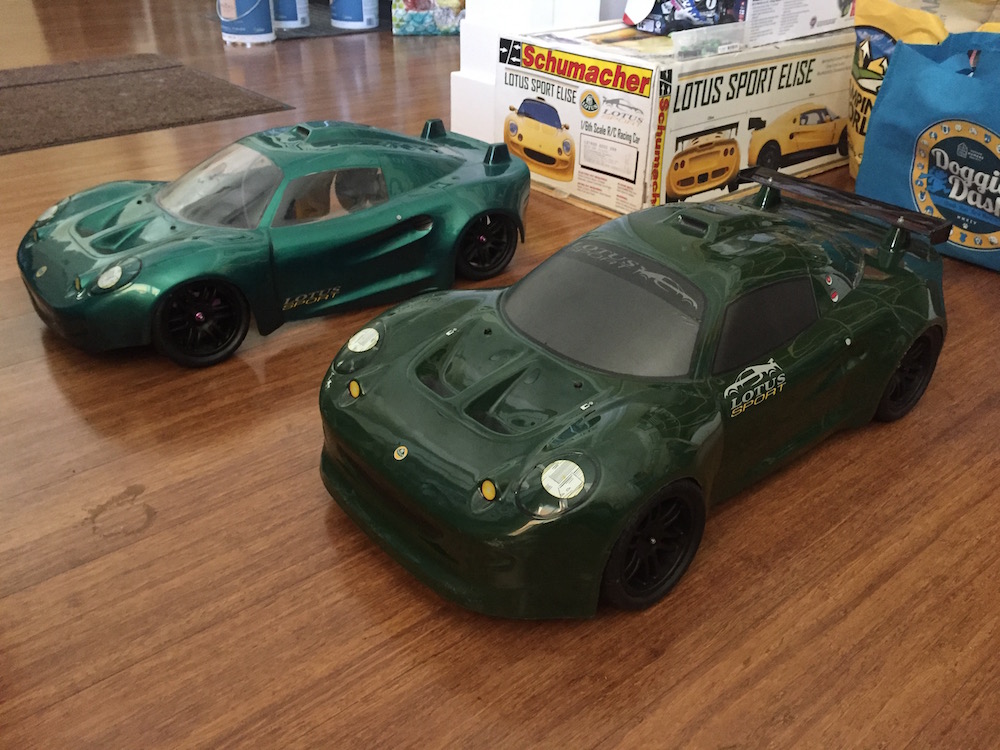

I brought mine back from England about a year ago - thanks FB for the reminder! Finally it is running and I am having some fun with it. So much so I bought a 2nd on eBay and got that tricked out! The plan is the bash around with friends in big car parks!
Still working out the battery strap situation, bought some RC10 Lipo holders that will get stuck in :)
I think theses are so much fun. Simple cars, minimal set up tweaking possible, run pretty quick. Only down side is they are a little fragile (I am stocking up on hub carriers and front arms!)

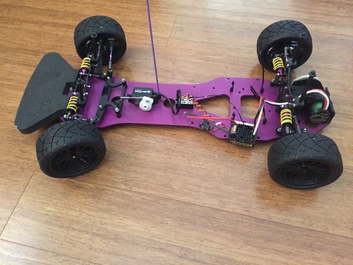

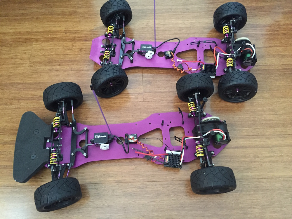

Lots of hopups:
Venom tyres
Ultrashort shocks
purple turnbuckles
Airtronics (Sanwa) receivers
Castle creations Sidewinder 3 4800kv ESC/motor combo
Savox 1258GT servos with medium Kimbrough savers
I think that is about it :)
Just missing the spur gear cover for the newer one.
Thinking about adding a slipper to each as the motors are a little warm for that old ball diff!!

I was thinking of one of these, throw a 1:8 motor in there and see how they go. would the gearbox hold up?

Back in the day I used to run a quad15 in it. It was a beat up motor bought from the track I used to race my B3 at. It handled that fine. So I would say you are fine down to a brushless 13.5 and if you are careful a 10.5.
Remember this uses the original cougar ball diff and has no slipper... In fact, I think the transmission has bushings not bearings! Lol!

Those are pretty cool, I also like the simplicity of that chassis. But someone put the headlight stickers on wrong on one of those bodies...probably the front one, it looks like it's gazing skyward. :mrgreen:

Coelacanth wrote:Those are pretty cool, I also like the simplicity of that chassis. But someone put the headlight stickers on wrong on one of those bodies...probably the front one, it looks like it's gazing skyward. :mrgreen:
I have never noticed that, but clearly you are correct! lol!!! I wonder how I can remove/replace???
The one in the foregournd actually came that way when I bought it..
How odd!! :lol:

I used to have a Big 6, and selling it is still one of my biggest regrets.... was my go-to vehicle for velodrome running, although it really would have benefited from the addition of that large foam bumper, to stop it trying to suck the front of the body under at speed!!!
I ran mine at the start of the brushless era, with a Novak GTB and matching motor, with twin NiMH battery packs in parallel for extra oomph. Ran pretty quickly, but used to melt the solder on the Deans plugs due to the heat!
I had upgraded to alloy front hubs for security, but hadn't touched the transmission... if needed, there would be upgrades that would fit, as most of the gears in the electric version were just Club 10 mk 2 parts, apart from the diff (and matching gearbox casings). Note that the nitro version was a completely different gearbox....
Removing it cleanly is easy, just warm up the sticker with a hair dryer and carefully lift an edge up with an X-Acto blade--maybe a blade with part of the tip broken off so you don't accidentally slit the sticker--and use a tweezers to pull it off the body. Hopefully the adhesive will remain on the sticker and you can re-apply it. I've been able to reposition stickers like that but sometimes the adhesive doesn't stay on the sticker, so good luck...no guarantees! Maybe someone else here knows of a way to re-stick on a sticker that has lost some adhesive?
