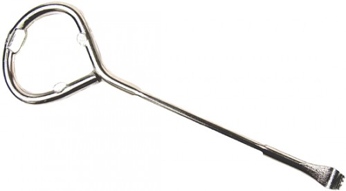

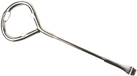

Original silver cans: Break in the motor running in reverse and dipping it into water (caused it to break in faster). Polish bushings with chrome cleaner or some other abrasive polish so that they were smooth and almost worn out (this was done by driving the new motor with a slave motor). The armature shaft didn't have splines on it so lock the motor into a vise with a long motor screw (to keep the rest of the armature from moving) and using a pair of vice grips you could advance the timing some. Too far would damage the wires going to the comm and wreck the motor (okay, this was questionable as to legality). Crush the can in the same vice to get the magnets closer to the armature (also questionable). I also remember there was a special tool that could go inside of the vent holes and move the brushes advancing the timing (definitely illegal). Also it was possible to open the cans by dropping them on the shaft or with a tool, but if there were ANY marks on the locking tabs the motor was declared illegal (and some came with marks from the factory). The steel sleeves were fairly common...either alone or under the motor heatsink. Also rezapping was something that every motor had done. The original magnets had very little magnetism so they had no torque.
Later 'rebuildable' open endbell motors: I'll have to see if I still have any of these tools (I may have). There was the brush hood aligners that had a shaft that replaced the armature and a square aluminum part that went through the shaft and brush hoods. I also had a brush serrater that was used on EVERY set of brushes. As for drilling holes int he brushes, once again, it was done by everyone and common knowledge. Drill hole, serrate brush face, fill with comm drops, race, then do it all over again before the next race. Nothing illegal here that I recall. I do remember having a brush box with at least 24+ different compounds of brushes in it. 'Tweeking' a motor was a combination of finding the best brush/spring/cut for the conditions.
I do recall one other exaggeration of the rules that we were doing at the ROAR On Road Nats (?) one year. People were dezapping the magnets (removing the magnet field) and then moving the motor 25-30 degrees and rezappinig the motor, in effect advancing the timing. I wrote the race report for Xtreme R/C for that race and included that info in a side box so everyone would know about it and could look for it being done.
