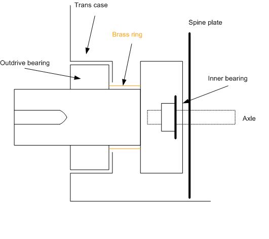

ok, hopefully this won't confuse you more, and will clarify. if not, I apologize, and you may slowly back away from the the drawing and forget it ever existed. this is a projected side view, so things inside the outdrive are 'visible'.
Re: Rebuilding the 6 gear transmission.
Are you kidding me? The drawing is excellent!! If the hole I made isn't too large then that would tell me that the brass tube would have to make contact with the outdrive bearing AND the outdrive gear or the tube would just slop around the hole. So does the tube make contact with both AND the tube would rotate with the outdrive? Is that correct?

yes, the brass tube contacts the bearing and gear at the same time, and rotates as part of the assembly. I think you got it now! the tube can't come in contact with the gear case or it will drag. the drawing shows distance between the case and tube.

Yep, I got it now!! Took me long enough!!
