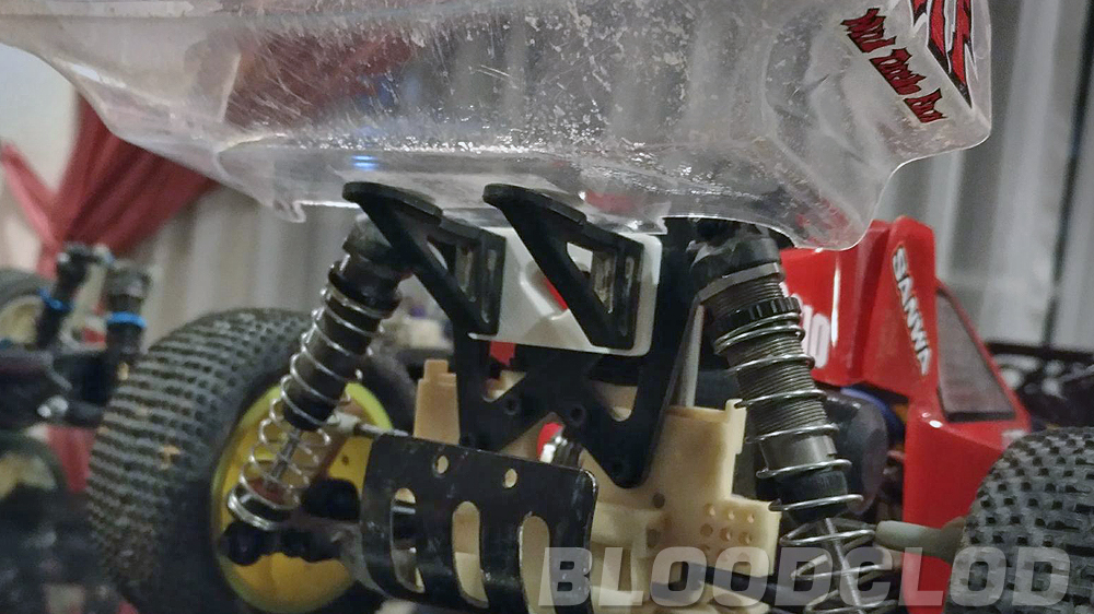

Figured out a way to get my harder front blue springs to fit!
Once again, thanks to the instant gratification brought to you by 3D printing - lol!
The front lower spring retainers on my RC10 were quite tall. I can't recall if these were stock but it wasn't hard to draw up some new ones in CAD and have them printed out. The lower profile should allow me to mount my blue springs with no issue!

Your welcome but remember my mid car was on high grip astro indoors, if you were outdoors/carpet I would go lighter on the oils 35/30wt but stick with Blue/Silver springs, the AE spring cups in the pic are the off set ones from the b44, the normal B4 ones will do the same job as the printed one

Understood. 35/30 on the #1 pistons seemed too light for me so I'm currently on TLR40/35 which seems to be in the ballpark. I might go a tad higher on the rear just to give it a bit more damping landing the big jumps. The blue springs now fit so I'm ready to hit the track again for track test #3!Headling wrote: ↑Wed Aug 16, 2017 1:12 pm Your welcome but remember my mid car was on high grip astro indoors, if you were outdoors/carpet I would go lighter on the oils 35/30wt but stick with Blue/Silver springs, the AE spring cups in the pic are the off set ones from the b44, the normal B4 ones will do the same job as the printed one

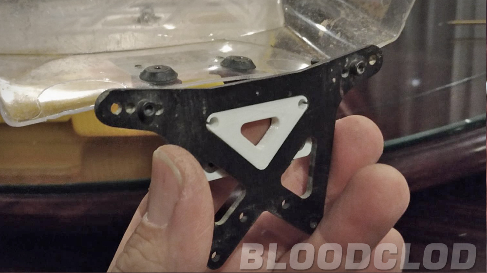

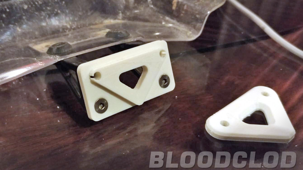

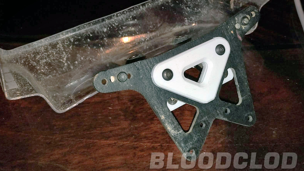

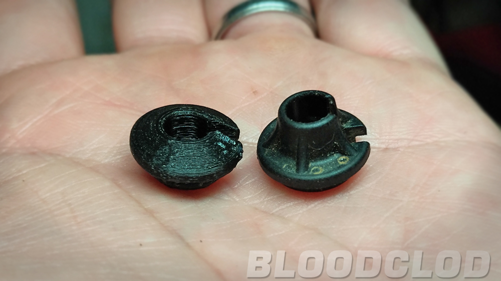

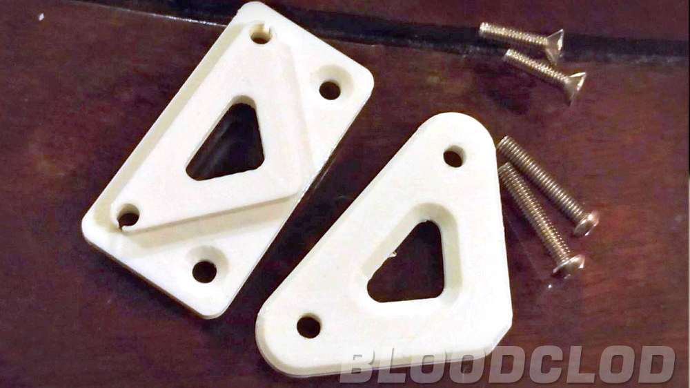

Have been busy lately but at the the last run the wire for the wing mount broke after a flip. Interestingly the car still handled pretty good without the wing but of course it was a little hard to adjust the in-air attitude of the car on the jumps.
Anyways, I had a little time today and had an idea I wanted to try out... and here it is...
The parts...
Step 1...
Step 2... it fits neatly!
Step 4... Then 2 more screws to put it all together.
Then mount everything back to the car and viola - wing mount!
Of course cutting a new shock tower to add the wing mounts would have achieved a similar end but this was easier to do then setting up the CNC... and it was a different idea so I'd like to see if it works! lol!

Thanks, I'm a 3D printing newbie so I'm learning as I go along... the way the part is designed and printed makes a difference to the way it handles stress. Version 1 of the waterfall was a different design and has evolved since... and the parts have been holding up so far and the track we run does put it through a good test. lol!slotcarrod wrote: ↑Fri Sep 01, 2017 11:45 am That thing looks great! Nice driving as well! Hope the 3D parts last for you.
But this new wing mount will be next to be stress tested!
