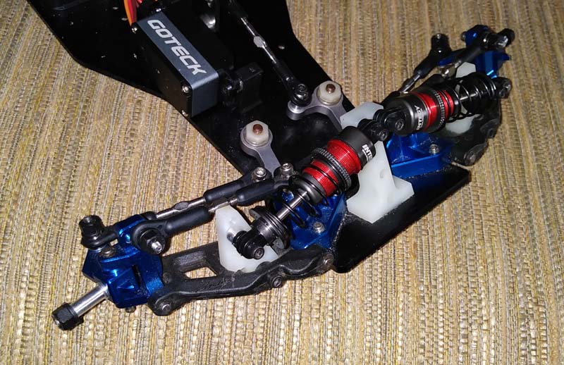

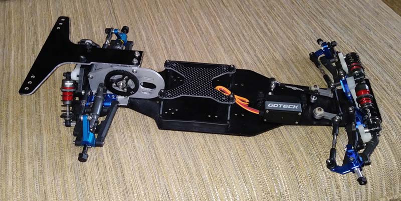

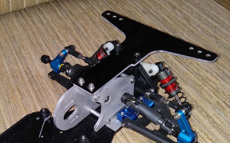

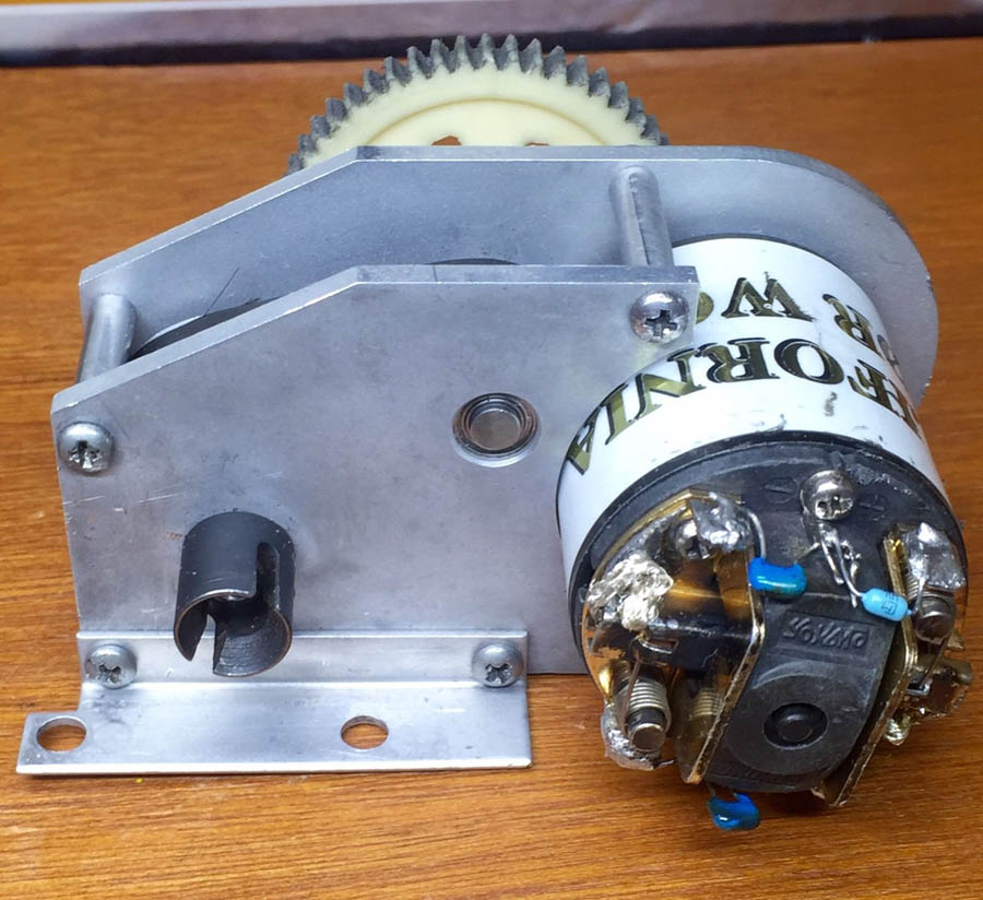

This was my winter project, an RC10 built with mostly vintage aftermarket hop-ups. The only Associated RC10 parts on the car are the front stub axles. The major upgrades are the mid-motor Trackmaster belt drive w/Raborn rear arms and Losi half shafts, McAllister lowering kit, Andy's front arms, RPM rear bulkhead, Sassy Chassis steering, a NIXconcepts aluminum chassis, blue Dhawk alloy pieces, and the only 'new tech'' parts - big bore Integy shocks.
I'd like to express my thanks to jwscab for the aluminum bracket that mounts the body mount to the belt drive and GoMachV for the fiberglass body mount/bulkhead brace. Anybody using Trackmaster transmissions might want to contact these guys, as the Trackmasters have no provision for a brace from the manufacturer.

That is one intimidating looking car.

Awesome. Reminds me of the old wedge car days. The only mid-motor config I had back then was my trackmaster equalizer oval car.

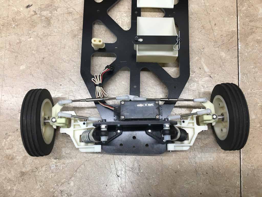

I have a set of HPI Super Star wheels with foam tires for it. With a couple shorty battery packs and a stout brushless motor, it should scoot... Still haven't decided on a body yet.

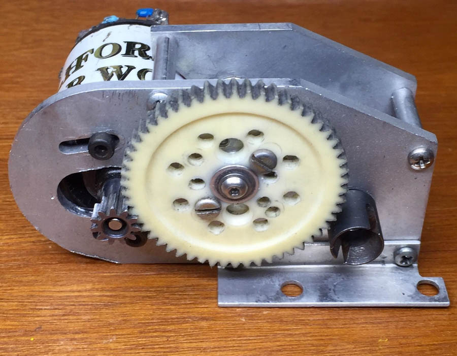

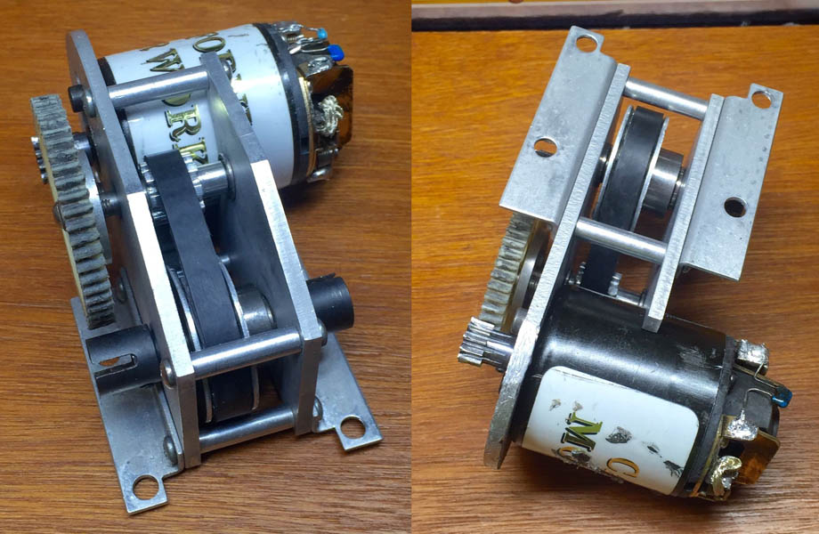

I would like to see some close ups of that transmission. It is pretty cool looking.
Re: It's back to the 80's - or What to do with a Trackmaster belt drive
These were pics from the original ebay ad. The trans consists of 2 side plates - they made aluminum and carbon fiber, a ball diff, a top shaft w/spur gear, and a cogged belt. Bolts to standard RC10 bolt holes and can be run as rear or mid-motor. The drive cups are made for dog bones, but I swapped those for Losi slider half shafts. I also added a bracket to mount the front for the brace/body mount. Trackmaster also makes a similar direct-drive trans w/diff.

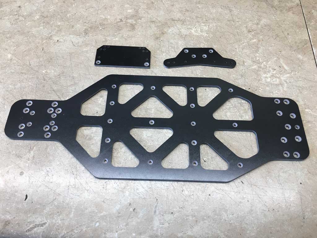

GoMachV makes a nice copy of the Trackmaster oval chassis and jwscab makes a bracket to mount a brace between the trans and rear bulkhead.
