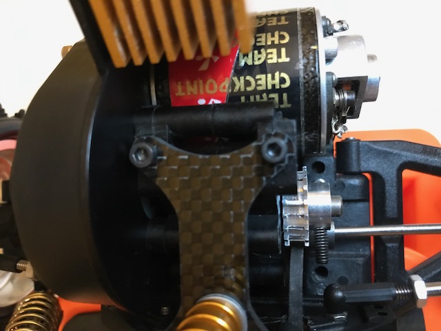

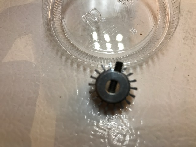

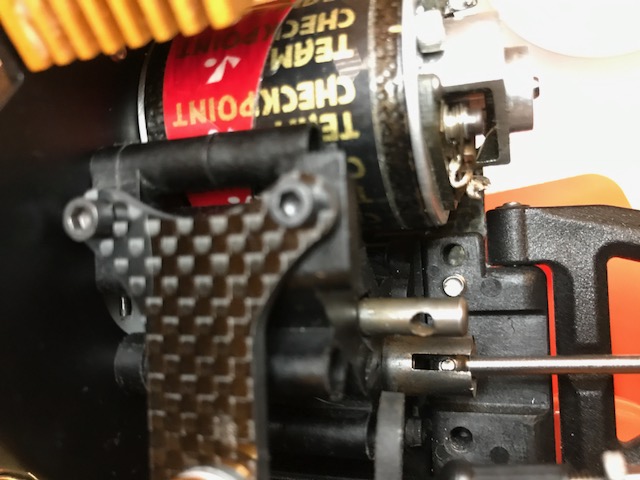

Here are some pics. Note, the pulley has a long setscrew that goes through the drive shaft. I am not installing the setscrew fully in these photos because it's hard to remove, and I don't want to deform the threads on the pulley. Once installed, note how close the pulley is to the transmission. There appears to be clearance, but there is not. The MIP logo is pressing against the back face of the pulley.
Inside the trans, there is one shim on each side of the drive gear. It may be possible to put both on one side and provide some clearance, but not enough - I have not tried this yet.
This transmission was originally chain drive, and the sprocket did not have a clearance problem. The belt conversion simply shows replacing the gear with the pulley in this orientation. I tried fitment on another MIP trans (used condition), and it has the same dimensions and clearance issue.
I could solve the problem by milling off the MIP logo, but want to make sure there is not something wrong with the parts or assembly.

Hi,
If you want to retain the writing.
Turn the shaft 90 degrees, mark with a texta through the grub screw hole of the pulley,
moving the pulley out so it just clears the writing.
Now remove the shaft from the gearbox, using a drill bit, the same size as the grub screw,
drilling only deep enough for the grub screw to be able to grab on the shaft.
Replace long grub screw with a short one.

Made some progress tonight. I carefully milled about 0.02" onthe MIP trans case, eliminating the pully friction problem. I also successfully drilled th graphite chassis for mounting the front MIp hardware. Guidance for drilling graphite produced very clean holes. I will post photos this weekend.
