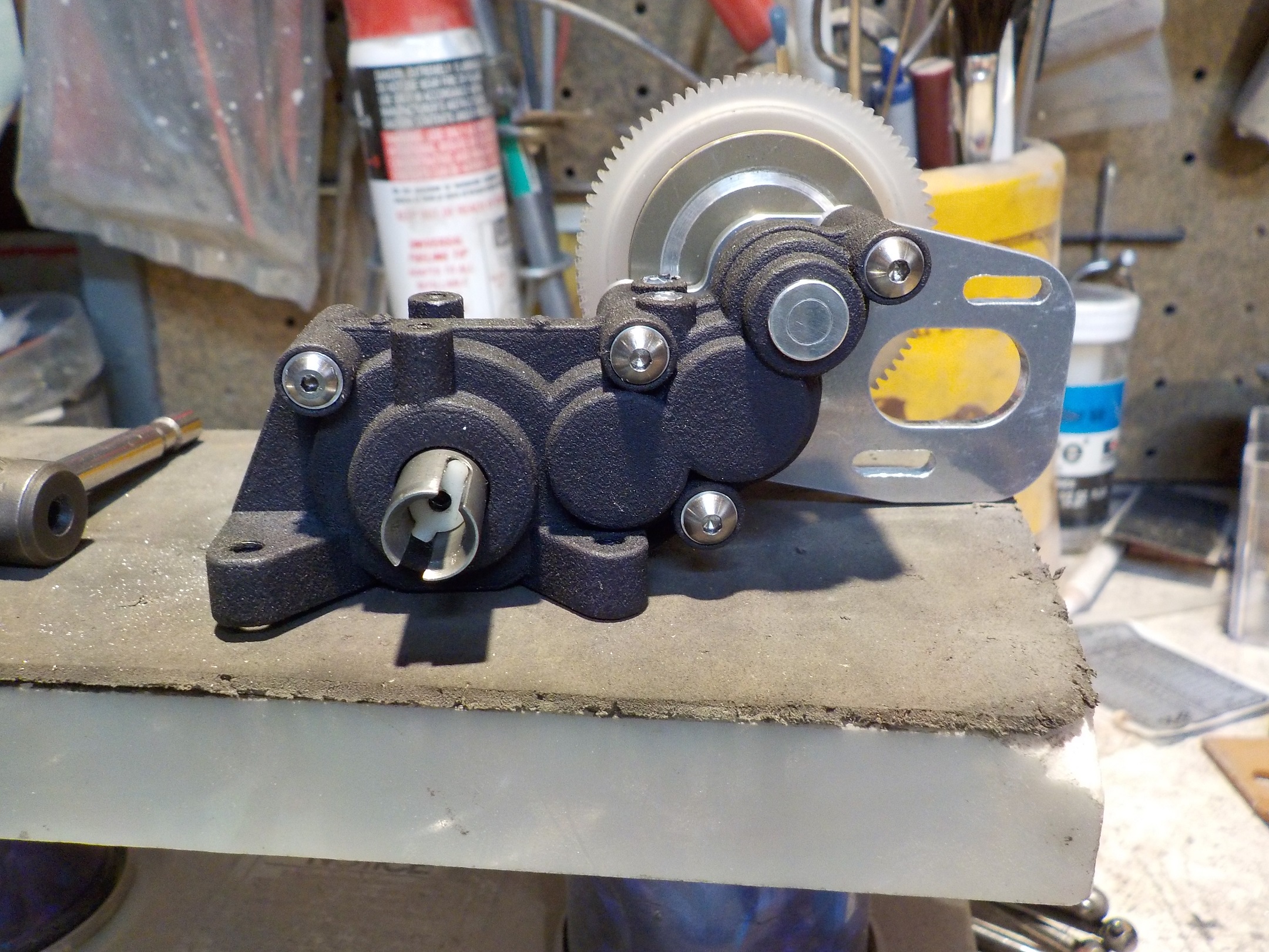

Those look like Lunsford to me 8)
vandal
Posts: 42
Joined: Thu Mar 09, 2017 7:05 pm
Re: gold pan A&L mid motor conversion
Post by vandal »
yep gomachv they are indeed lunsford :) stealth case screws had to grind 2 of em a tad shorter not to hit slipper back tho! V

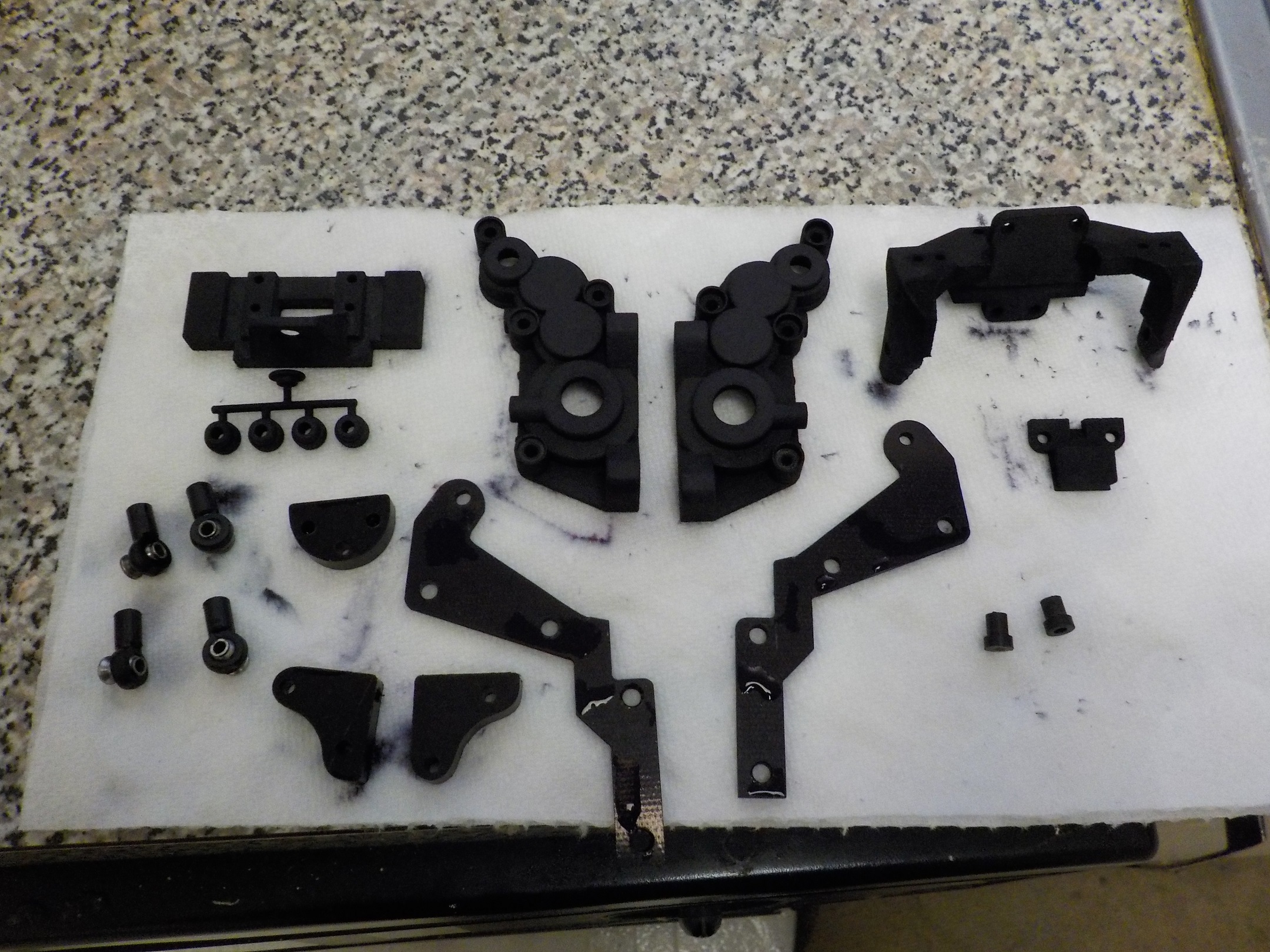

heyo mini update! got some free time and dyed my white parts :) found some 30 year old rit dye in the shop (leftover from when i dyed my 2nd rc-10) and it was still liquid lol as u can see it worked awesome!
more to come as i get time to work on it :)

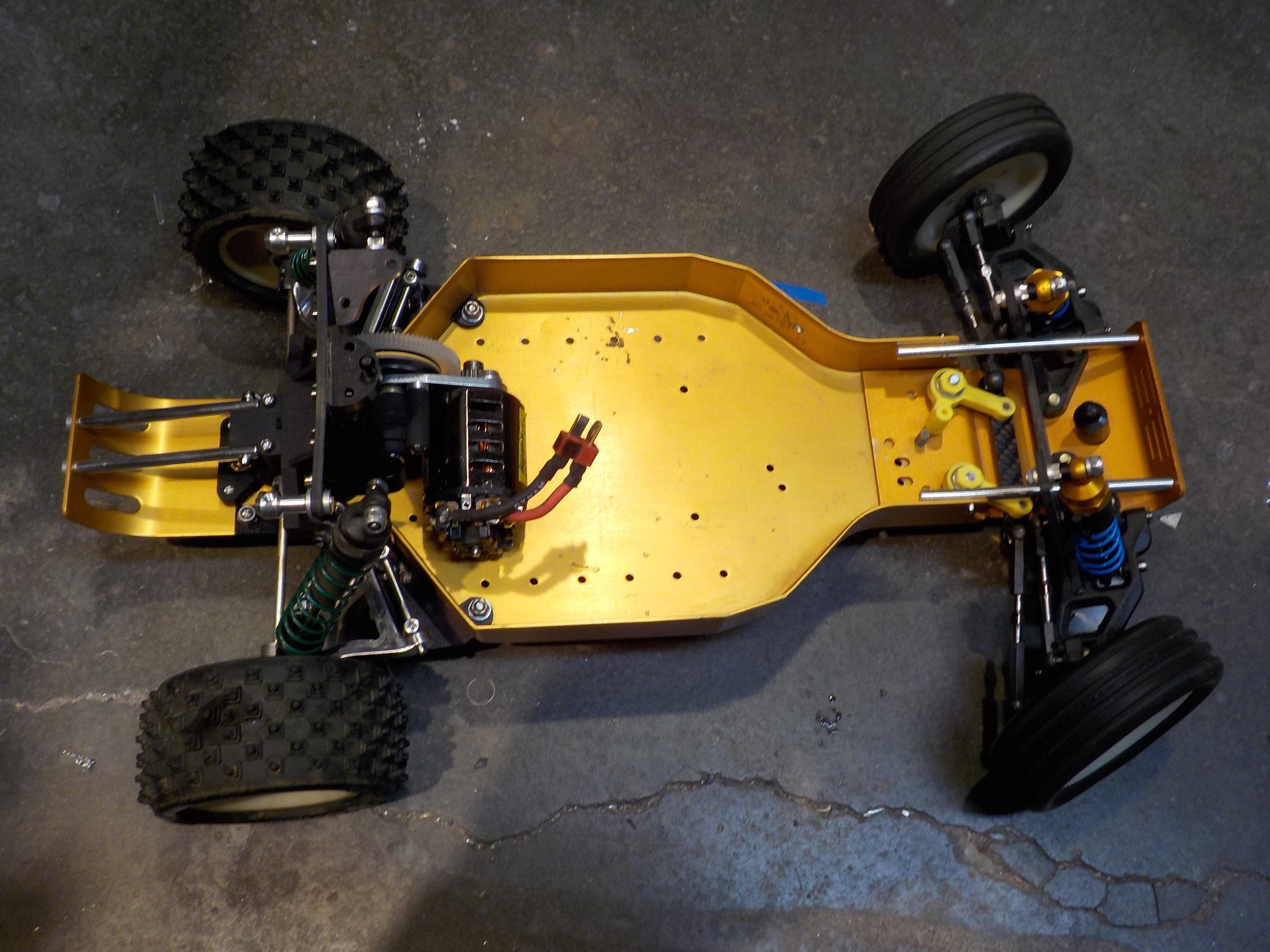

ok final build update! finished up finally was a fun build :) special thanks to factory works, and conklin design and of course lunsford racing ! had to limit the down travel of shocks to keep dogbones from rubbin on outdrives and re- cycled a really old body until i can score a new body :) used some vintage electronics and batteries (when i can swing it they will be replaced with brushless and lipo) for a radio i stole a 2.4 receiver and radio from a losi rtr i bought several years ago:) ok heres the pics :) thx for reading and looking ! :)
Posts: 12336
Been thanked: 3919 times
Looks great! You don’t see mid motor trailing arm cars much! Not since the MRP pro 10 anyway!
