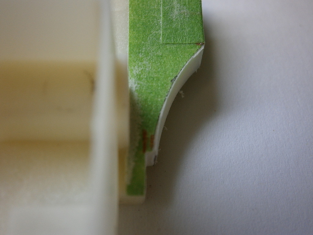

You could start this build anywhere you like, I opt for the bulkhead. The instructions that come with the kit tell you to do some cutting so the trailing arms clear. Being a bit anal retentive, I make my cut an arc, also making a triangular cut at the top. The triangular cut serves no real advantage other than look cool.
Some careful Dremel work. Patience pays off here, get as close to your guidelines as you dare and finish up by hand.
Once your happy with your work, go for the black dye bath!

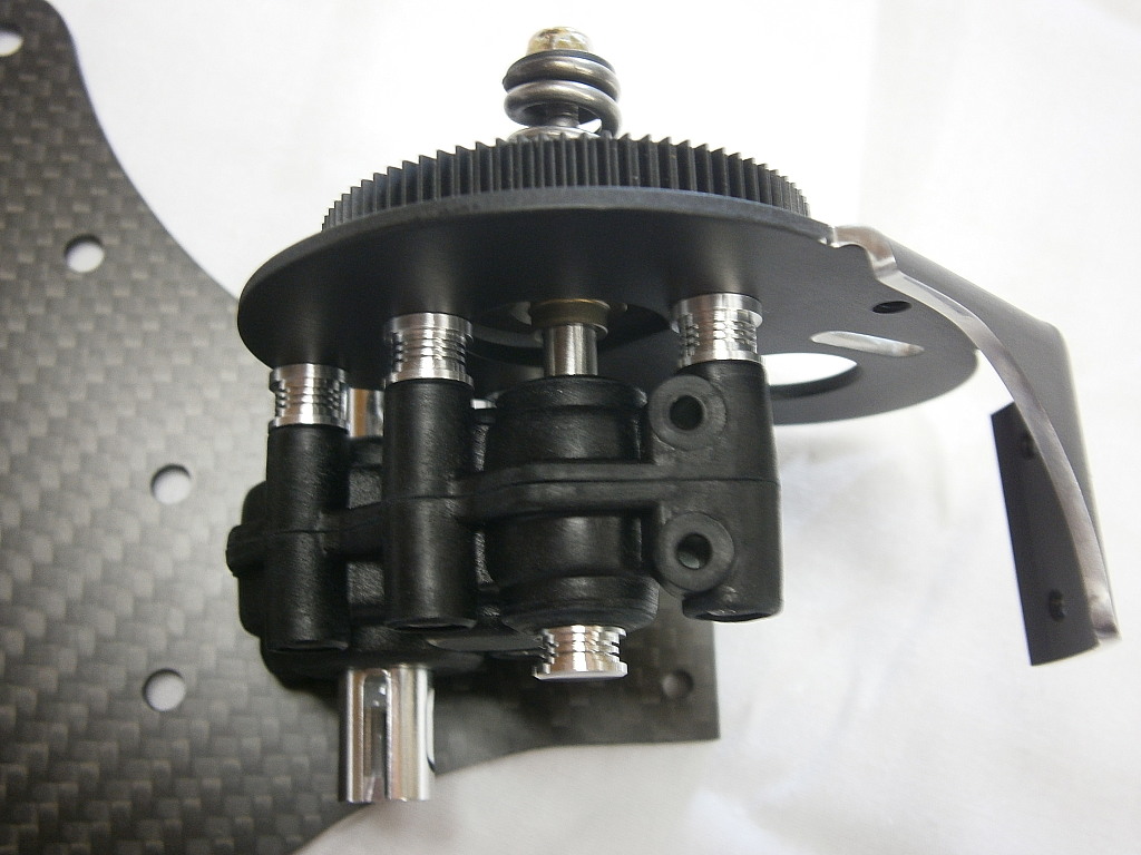

Transmission is complete. I've used the newer 6565 case (dyed black) with Avid brand bearings, carbide diff balls, and ceramic thrust balls. A 9601 top shaft with CPD aluminum alloy out drives make the trans smooth as snot. You can see, my own custom machined aluminum alloy trans spacers and top shaft cap complete the package. Next... get busy with the trailing arms. Waiting on some 1/4 x 3/8 flanged bearings, hopefully tomorrow or Saturday they will be here.

Can we have some side views of the trans?

DaveM wrote: Thu Apr 05, 2018 5:48 pm Nice,
Here you go Dave.

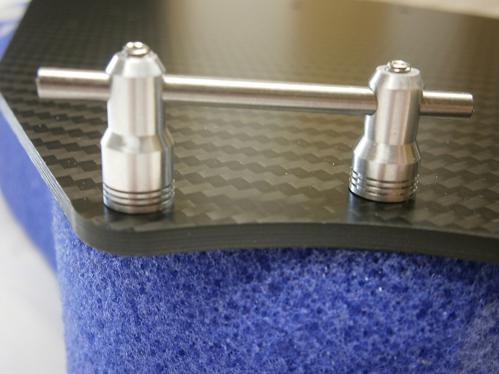

Steady getting the trailing arm parts ready to mount. The 1/4 x 3/8 x 1/8" ball bearings also came today.
I'm doing a bit of "tricking out" on the inner and outer aluminum posts. :wink:

After cleaning up the inner and outer posts I figured, why not cut some grooves in them 8)

NomadRacer wrote: Fri Apr 06, 2018 11:34 am After cleaning up the inner and outer posts I figured, why not cut some grooves in them 8)
Groovy 8)
