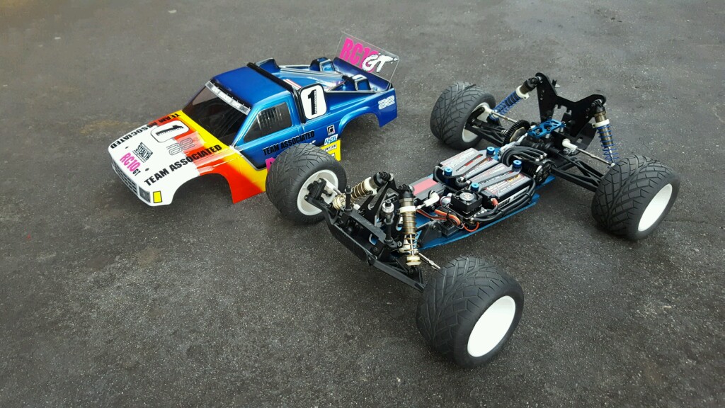

Here's the way I laid out my GT.

RC10th your car is super clean. I had mine all spiffy and then it instantly gets messed up when it goes flying down the street on its roof lol. I also have a set of those same speed hawg tires and they just do not grip at all for me. I've found these dirt hawgs to grip insanely well on the street, though it does raise the CG a bit and make it more likely to flip rather than spin out. By the way - what are those tie rod ends you're using? I'm still using the stock ones and they're really loose.
RC10th
Posts: 4705
Has thanked: 50 times
Been thanked: 1495 times
Re: Electrical connectors, layout, wiring, etc
Post by RC10th »
Thanks.
I'm using RPM white heavy duty rod ends, they also make them in black, blue, yellow and purple. The hub carrier rod end is just the newer style white AE shock ends.
The Speed Hawgs are my favorite road tire although agreed they don't grip the best. Road Hawgs grip the best out of the onroad tires in my opinion.
The other thing you could play with is since the receiver box is quite high, if you mounted the ESC on top of the servo and the receiver box where the ESC currently is you could route the wires down the side to give you more room.
Yours is the short flat chassis version, I re-drilled my long chassis to mount the gearbox further foward to effectively shorten mine, lol.
