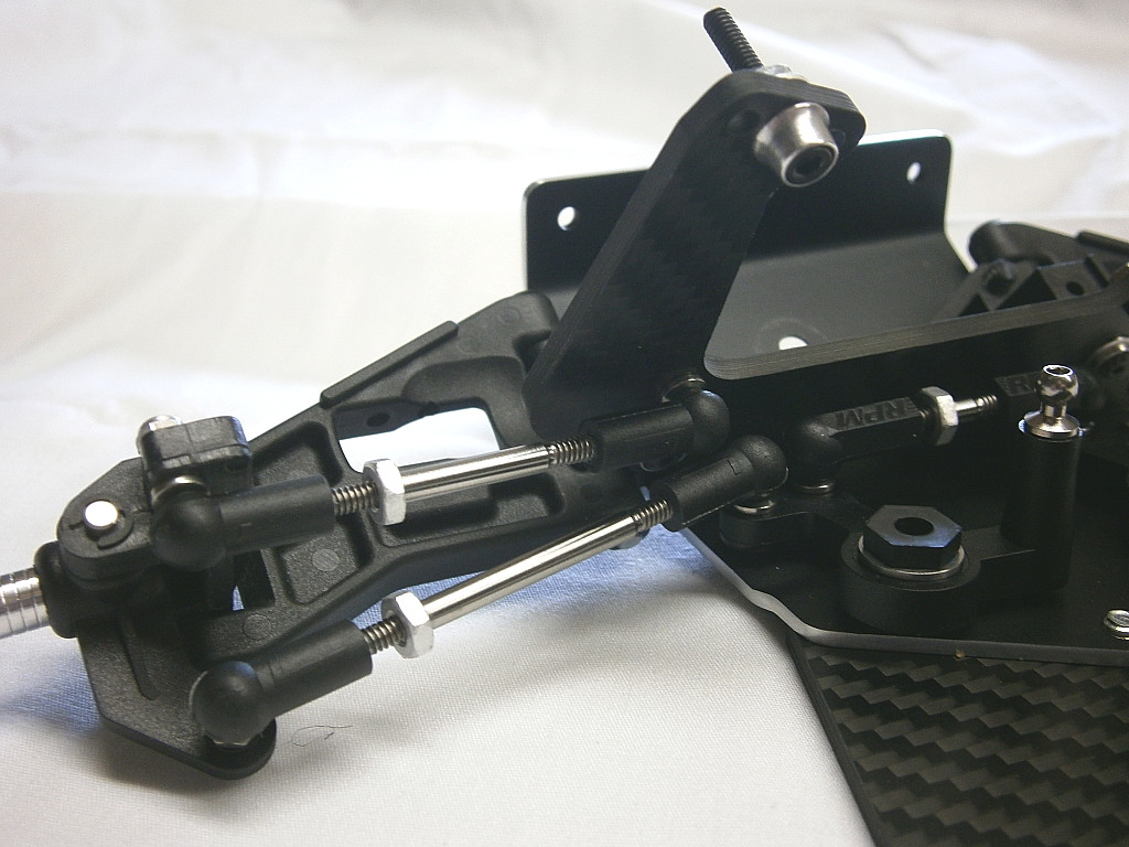

I ordered a new front shock tower from Factory Works for 0.89 shocks so now I can use those b2 shocks or even big bores if I manage to find a pair. While waiting for the tower to arrive I replaced outer ball cups with white shock rod ends. To me they look yokomo enough but need to get the balls polished as they are a bit tight. I can’t use them inside as they bind quite bad. Even the RPM cups bind so I need to find shorter ball studs somewhere.
Weather is getting better and outdoor tracks are already open so I really need to finish this soon.

Re: My RC10 Graphite runner
I learned, here on the forum that RPM ball cups are not RC10 "friendly" in the front end. My fix was to use Lunsford #7995 Punisher ball cups. There is no binding, everything clears nicely. Depending on what turn buckles you use, you may need to shorten/cut a few mm of the end of the ball cup.
Those were the closest thing to Yokomo rod ends I could find. They are a bit stiff though so I’m not sure I can use them. Does those Lunsford’s come in white as well?

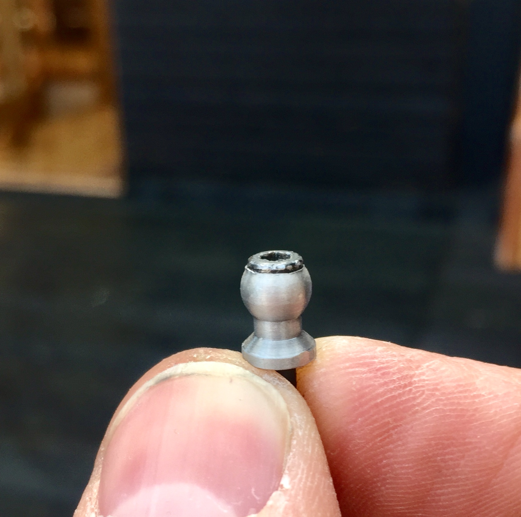

Lunsford ball cups are black only. The exception is their super duty (3.5mm) which are gray.
The tightness in the shock rod end with pivot ball can be fixed. Remove the steel pivot and polish the ball portion.
I polished the balls and now they are good. Maybe I should use rere white ball cups for the upper suspension arms as they are quite small and will clear all. RPM's really are no good. I actually have the same issue on the NIX10M car which is using B4 ballcups, they bind a bit even with shorter balls.
I got the towers today and they had second pair of upper arm holes. No more binding issues as the ball is just enough further away form steering arms.
