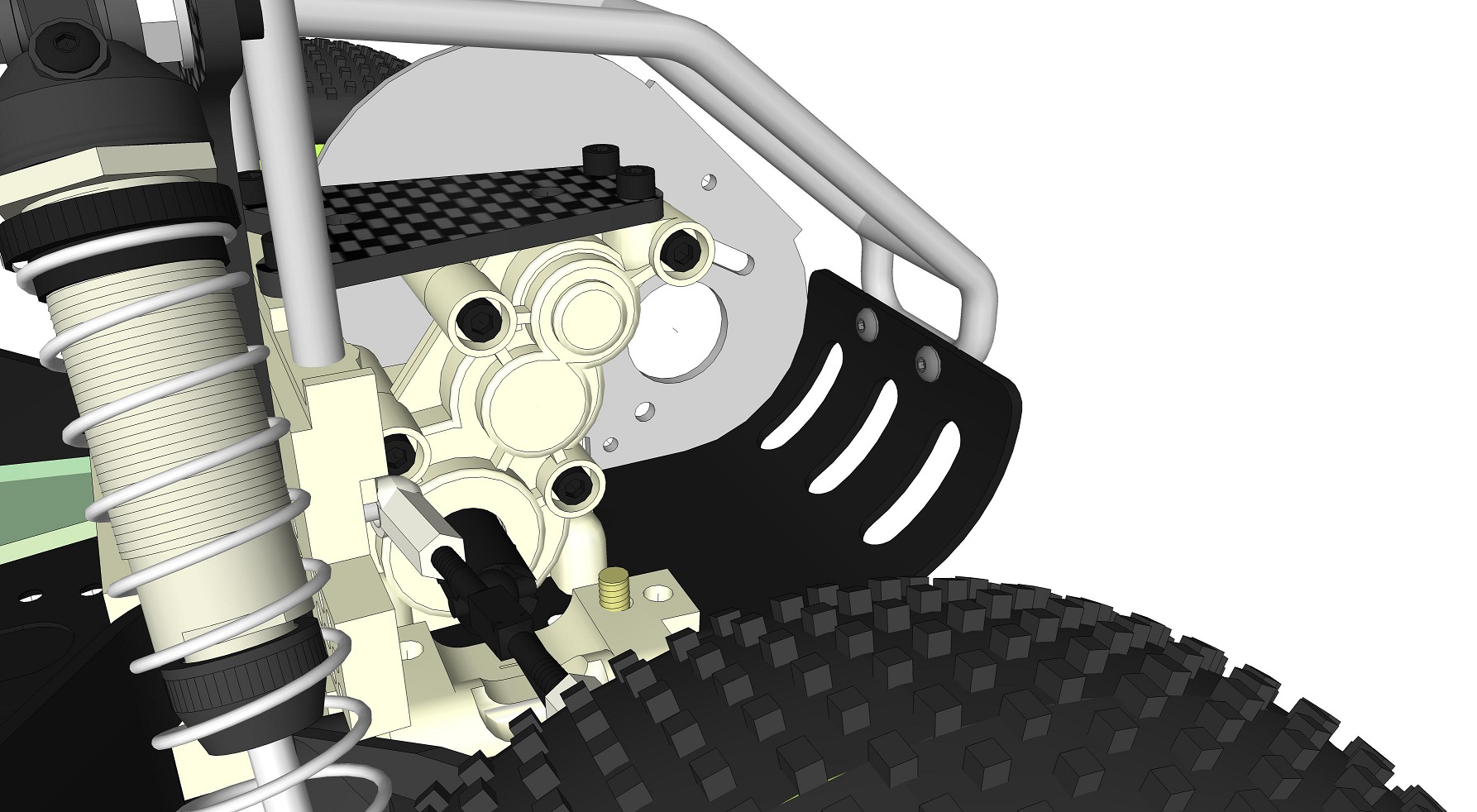

XLR8
Posts: 3307
Has thanked: 1659 times
Been thanked: 1170 times
Re: RC10 Factory Works C2 "Tuber" Build
Post by XLR8 »
NomadRacer wrote: Tue Aug 14, 2018 10:10 am Bending my life away :mrgreen:
I've come up with an idea for the rear, transmission guard tubes but not sure if it's going to stay, may re-do it, if so, need more tubing. :?
Hey Nomad.... Been giving this some thought. How about something like this?
Attached with button head screws from the inside
Those close bends at the back might be a real challenge.
Anyway, it's just a thought. :D
NomadRacer
Posts: 1467
Has thanked: 81 times
Been thanked: 79 times
Post by NomadRacer »
That's a good idea. I'll see if I can make those bends. It would look a lot better than what I have done!

XLR8
Posts: 3307
Post by XLR8 »
I have them spaced 1" apart but they could go wider if necessary.
I'm a bit uncertain on those two short cross-members. By chance, do you have some smaller tubing - maybe 1/8" perhaps? They seemed to be a little too thick - or maybe they should be moved or just eliminated completely. I dunno. Anyway, whatever you do, it will look awesome.
XLR8
Posts: 3307
Post by XLR8 »
Here's what they would look like at 1/8"
NomadRacer
Posts: 1467
I do have 1/8". It seems to me, kinda strange looking with smaller cross members. Maybe it's me though, being on the mobile, away from home for the weekend.
I think 1" is close to the measurement between the two tubes, maybe plus 1/4" or so.
Bum on Direct Deposit
XLR8
Posts: 3307
Post by XLR8 »
I think you're right, 1/8" is too small.

XLR8
Posts: 3307
Post by XLR8 »
jeepnut24 wrote: Fri Aug 17, 2018 11:44 pm Bend up both sides individually tig them together. If you want more strength, then sleeve the inside of the joint.
Excellent idea! Of course, the trick then would be to remove the weld so it looks like one piece. I'd bet Nomad could handle that with no problem. :D
XLR8
Posts: 3307
Post by XLR8 »
just for giggles....
