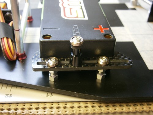

I got the battery (shorty lipo) holdown sorted out today. All I'm lacking is to mark and drill the 4 holes in the chassis plate to mount it. I used an Exotek brand #1827 system from AMain with a couple of mods and some 10mm tall hex stand offs. It looks pretty slick. You will be able to adjust it forward and back.

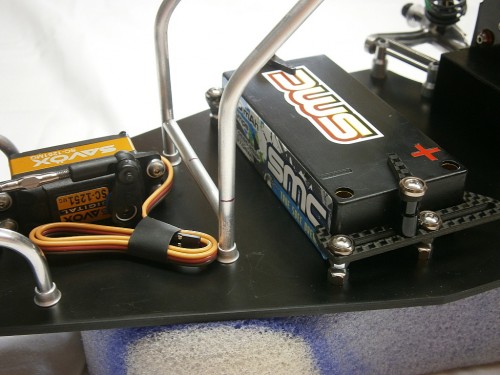

Battery holdown system installed on chassis plate. I was very precise with the drilling and everything worked out perfect, no movement of the battery at all and smooth movement forward/back.
Do I need nerf bars? YES! 8)

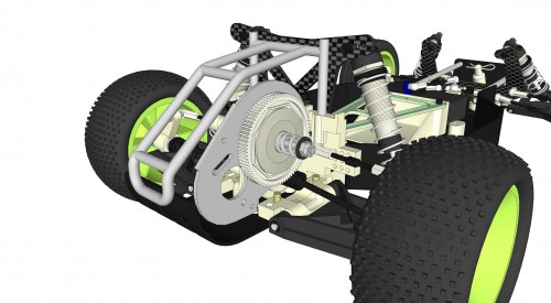

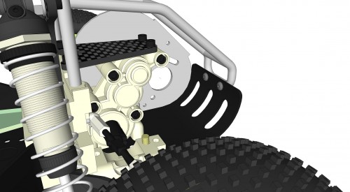

Hey Nomad.... Been giving this some thought. How about something like this?
Attached with button head screws from the inside
Those close bends at the back might be a real challenge.
Anyway, it's just a thought. :D

That's a good idea. I'll see if I can make those bends. It would look a lot better than what I have done!

I have them spaced 1" apart but they could go wider if necessary.
I'm a bit uncertain on those two short cross-members. By chance, do you have some smaller tubing - maybe 1/8" perhaps? They seemed to be a little too thick - or maybe they should be moved or just eliminated completely. I dunno. Anyway, whatever you do, it will look awesome.

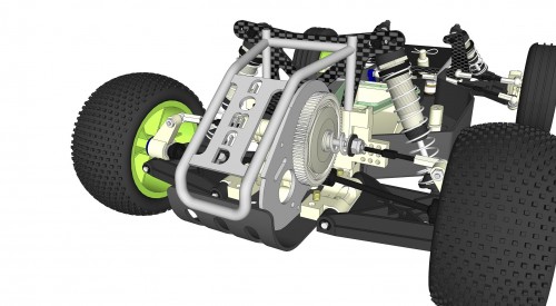

just for giggles....

That's how they sometimes handle it on 1:1 scale. :) Bevel the ends for a stronger joint and deeper weld.
