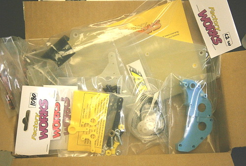

Got my order in today...
C2 Trailing Arm kit drilled for Lethal Weapon transmission
Blue Lethal Weapon trans. kit
BB Steering kit (less bearings)
Samples of some cool red fancy washers!
Thanks to GoMachV for taking care of me 8)

Those washers are "cool things" and they come in lots of styles and a few colors 8) They will be on the website eventually

GoMachV wrote: Wed May 03, 2017 4:19 pm Those washers are "cool things" and they come in lots of styles and a few colors 8) They will be on the website eventually
I really dig the button head style.

The large ones are good for the motor screws. Keep it from moving around
