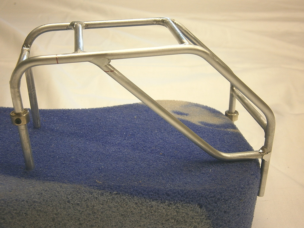

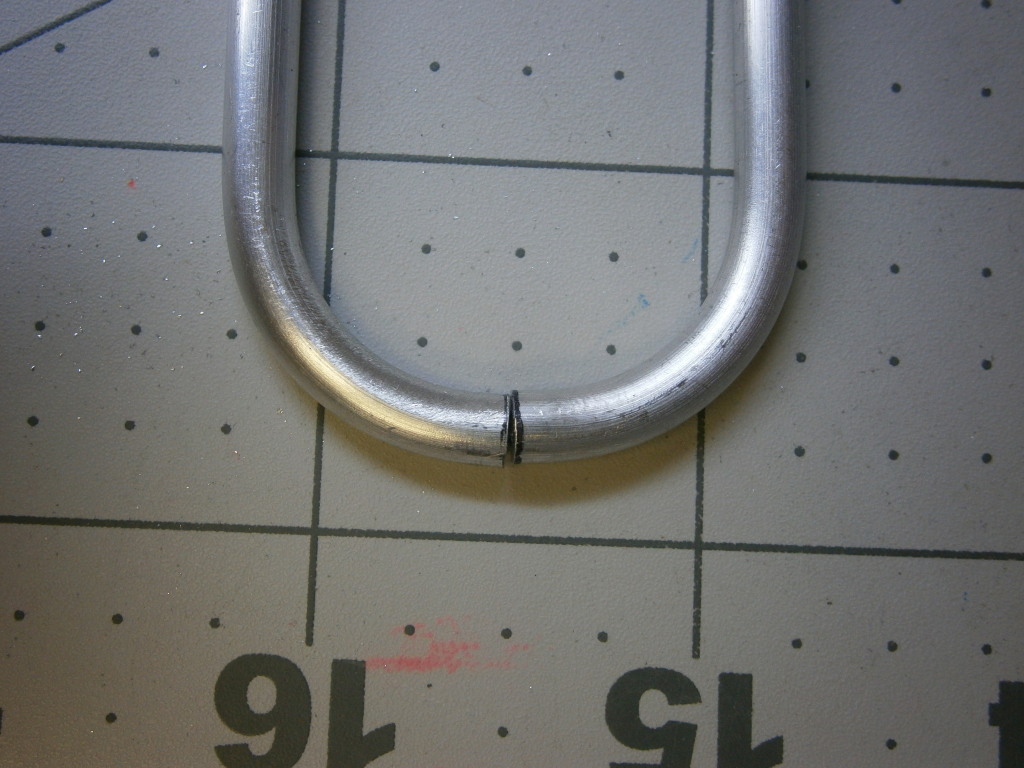

I tried out the rear tube guard...
I have the width, but the radius is to large
I'll try a different method to get it right. I really like this idea of the rear tube cage, thanks again XLR8!

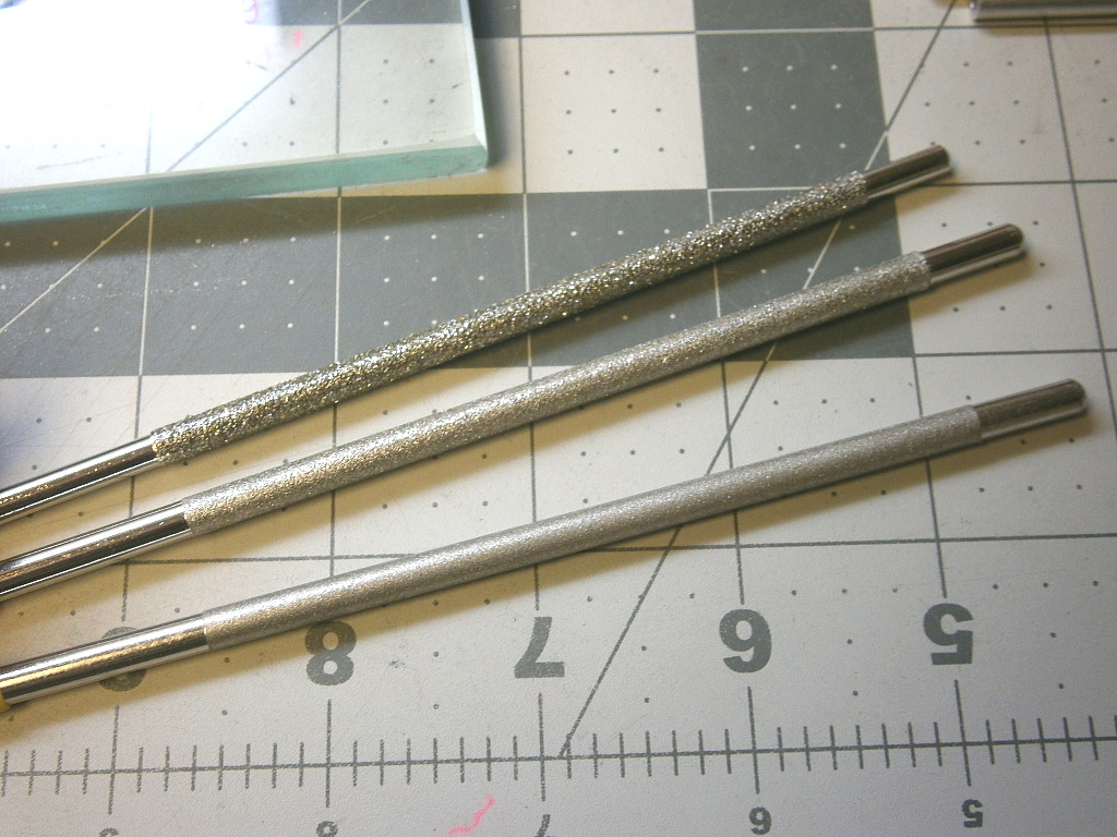

In the mean time, I got some diamond coated (three grits sizes) 5mm chainsaw files. These will make things go considerable faster. I has using 3 different sizes of files plus some 320 grit sandpaper wrapped around a rod to get close to the right size, what a pain in the butt that was!

Hmmm, round chainsaw files to notch the tube ends? I would never have thought of that. Brilliant!

A little out of practice but it turned out straight and not to awful bad. Lots of file work but I'll get it looking good.

Yes, looks kinda messy but it's cleaning up nicely. I had worked a little bit with a Dremel before the pic. Back at it a couple more hours so far...

Yes, it does work very easy. I'm having no problems getting the joints smoothed out to my liking. Getting close on the front two cross members. I''ll hold off on the back two, going to add some more tubes there and want to have the added security of more "meat".

I only got to spend a short time at the welding shop today (man was getting his gear ready for the work week). I got one side cross member done and spent some time cleaning joints up with files. I have the other side cross member ready to go.
