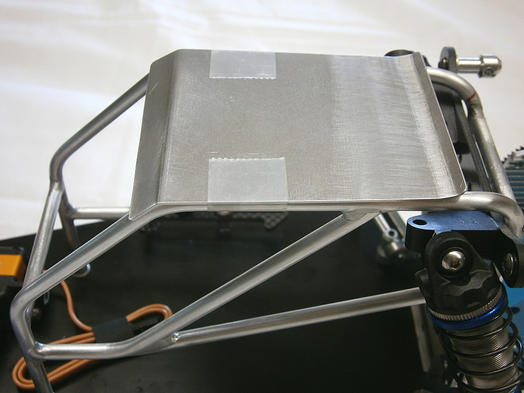

Not a lot of tube bending this week, soon though! I got the roof cut and bent this morning, looks fine to me :mrgreen: It's made from 0.032" K&S sheet aluminum.

Looks fine to me as well. Did you bend it over a piece of tubing? That curl at the trailing end looks really good. Will you screw it to the cage using some of your 0-80 hardware? The stainless screws against the aluminum will look great.
Can't wait to see what you have in mind for the rest of the car. Great work!! :D

Post by NomadRacer »
XLR8 wrote: Sat Sep 08, 2018 10:26 am Looks fine to me as well. Did you bend it over a piece of tubing? That curl at the trailing end looks really good. Will you screw it to the cage using some of your 0-80 hardware? The stainless screws against the aluminum will look great.
Yes, I bent it over a piece of 3/16" rod, then a little (2mm) "tweak" to the top edge. I"m super pleased with the trailing edge! I'm going to install some 0-80 bhcs's today. :D

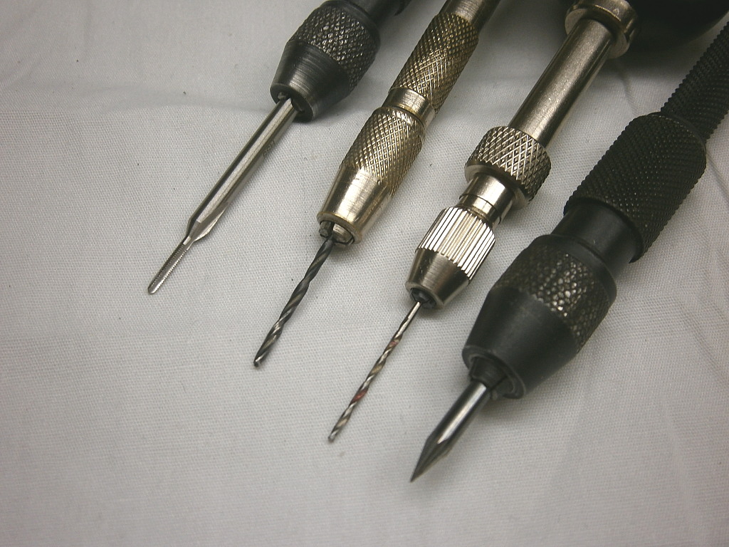

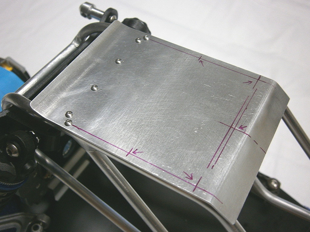

I got started attaching the roof with the 0-80 screws. So far, got the back done. I still have more to do...
These are the tools I'm using.

Nomad, I bet you could make a wristwatch. Am I right?
Great stuff! :D

XLR8 wrote: Sun Sep 09, 2018 12:32 pm Nomad, I bet you could make a wristwatch. Am I right?
Great stuff! :D
Hey Doug, I'd try!
It's coming along good, got the rest of the screws done now. Time to clean up the bench, got stuff all piled up! :mrgreen:

When I first began making parts for my RC cars bitd, I managed to break a couple 4-40 taps. I quickly learned to properly size the hole, use cutting fluid and run the tap in about 1/2 turn at a time and back it out often to clear the chips. I cannot even imagine the extreme care that must be taken to prevent breaking a 0-80 tap. Not to mention the consequences if you did break it; probably wouldn't be able to extract the broken pieces and the part could be ruined. You have some skill Nomad, there's no doubt about it.
