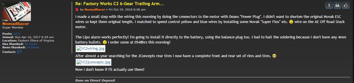

Hey Nomad, are you able to view your recently posted images? This is what I'm seeing.
I'm not seeing others who have posted images starting yesterday but I can view Justin's photos from his post today. Not sure what's going on but it just started yesterday.

Yes, I can see that. Thank you Lowgear.
