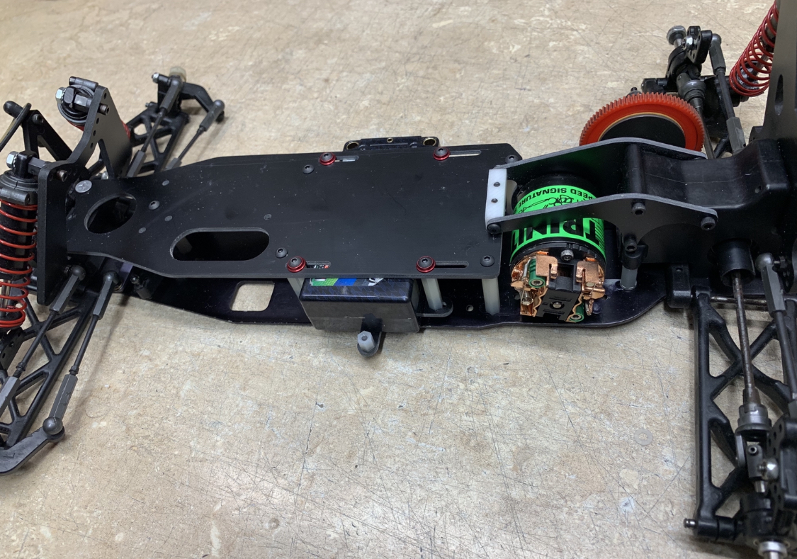

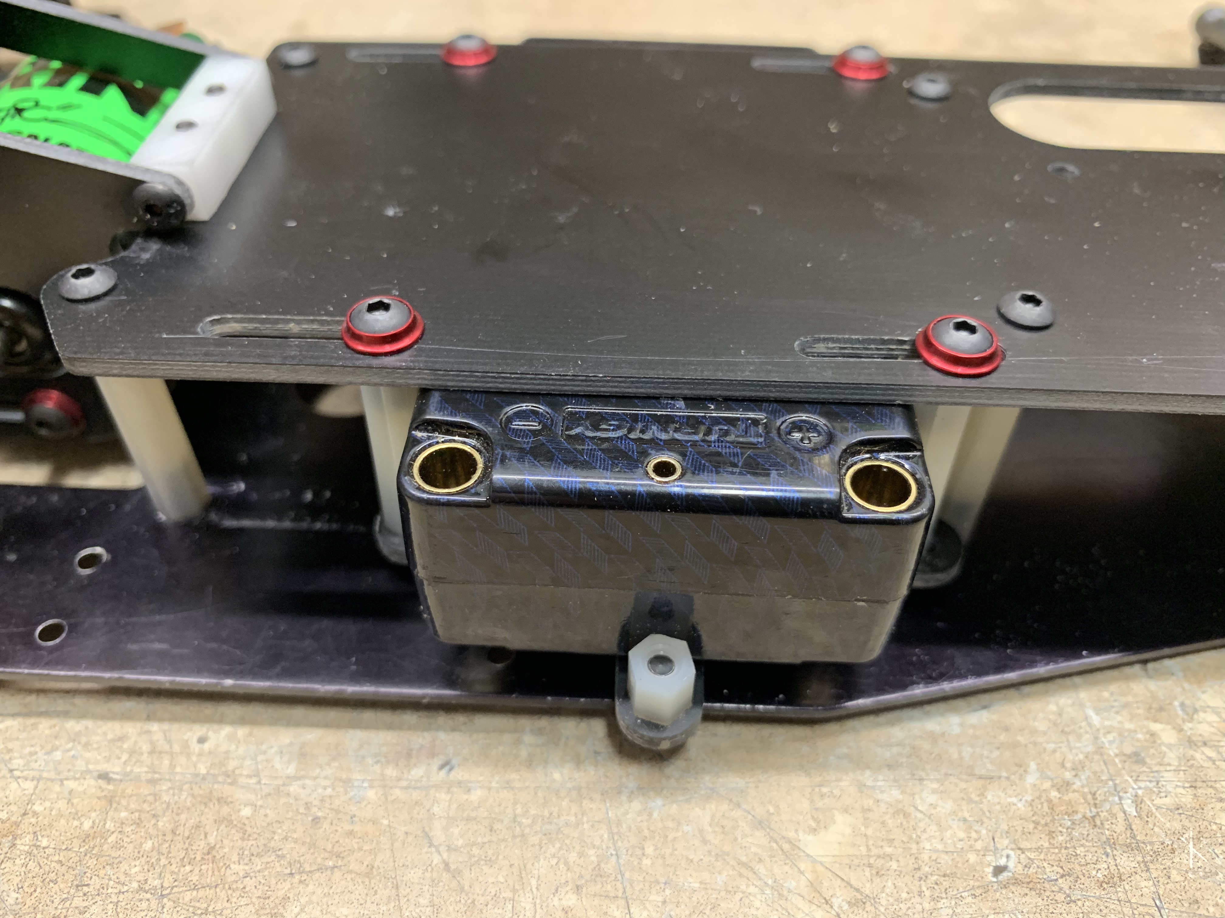

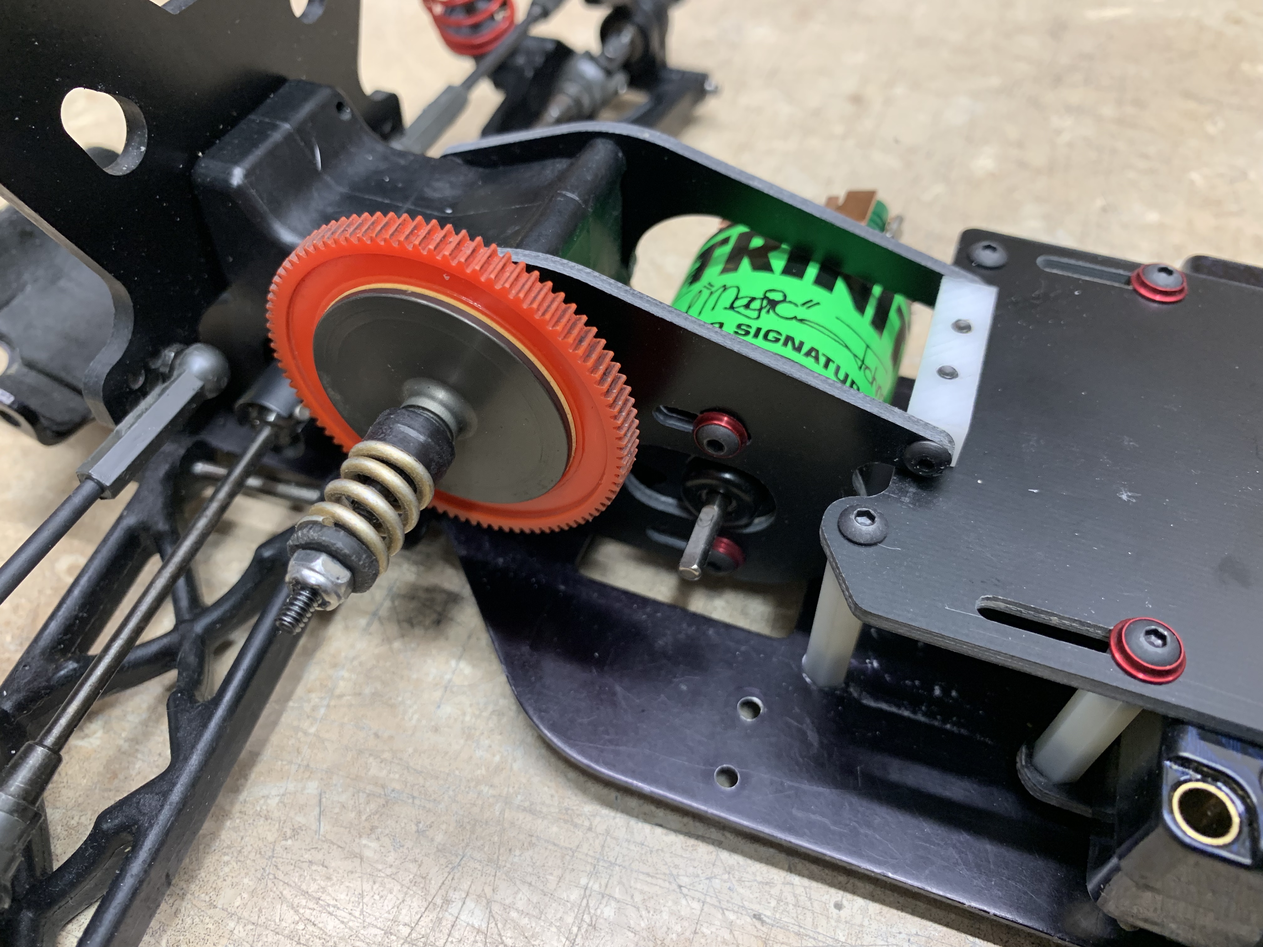

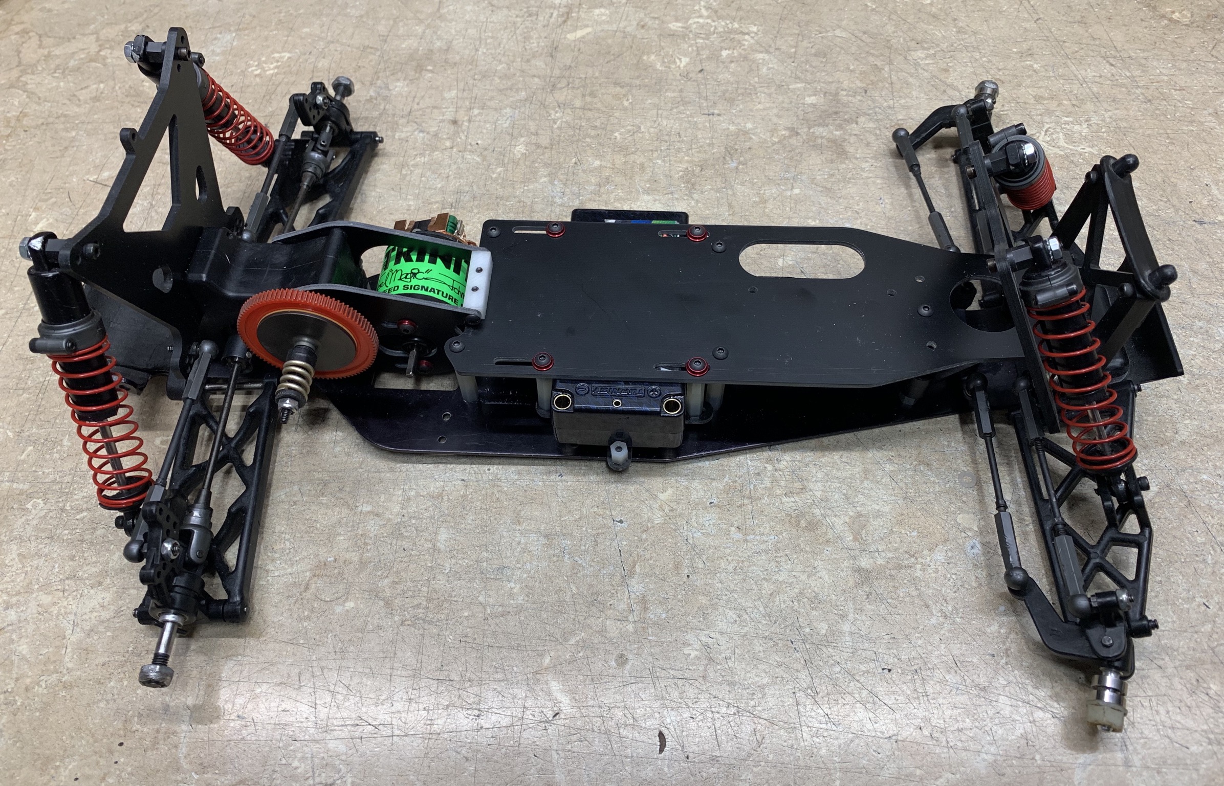

Working on this for a customer. Figured what is good for the RC10GT guys should be good for the NXT crowd. No drilling the chassis, everything uses existing holes. Battery position has almost an inch of movement front to back. Still not loving that I have to make a Delrin piece to tie the upper to the trans but it’s a lot more rigid than the original NXT trans brace. I’ll have the motor plate laser cut from 6061 when I run my next batch of aluminum parts. Anyway, here are some teaser pics
