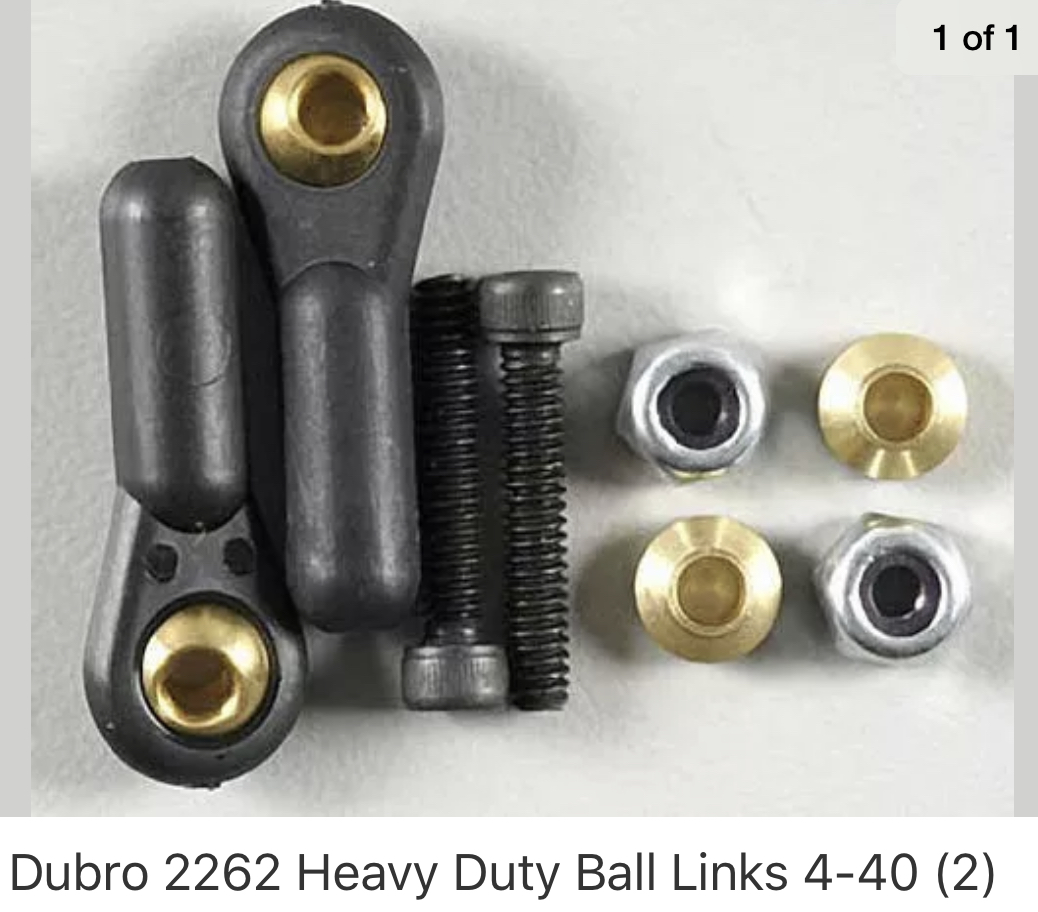

Re: Edinger? Time for some love
I picked up some Dubro ball ends, but I think they’re not quite right, I got the 4-40 rod size, but I think the balls/screws are smaller, whereas the ones I should have should be 4-40 balls/screws as well yes?
- jwscab
- Posts: 6580
- Location: Chalfont, PA
- Been thanked: 505 times
Dubro makes ball ends with either #4 screw balls or #2 screw balls. You probably have the #2 ones. I have seen early cars with aftermarket parts use the #2 screw ones, especially in the center link, so it would be ok to use them if you didn't want to order more
- Posts: 12336
- Has thanked: 1129 times
- Been thanked: 3919 times
Dubro 2262 looks most similar to what we used back in the day. This is my only car with Dubro’s on it.
I just had another look at the car and hidden in plain sight are a few more ball cup issues, primarily a couple broken ones, and more missing on the rear
Now I’m not sure whether to obtain more dubro’s or look at other alternatives
These are the ball links that I already purchased, but I think the ones linked above will be far better
- Posts: 12336
Well, here is my opinion. Back in the day when those broke you bought either Dubro or stock ones. Stock ones of the next era are not the hardest to find, but fairly expensive. Dubros that you buy today aren’t exactly the same as those we used back then, but close. It boils down to how original you want it to be, and how much your willing to spend. Your car has been run, so it would look perfectly normal having the newer version Associated or the dubro on there either way.
