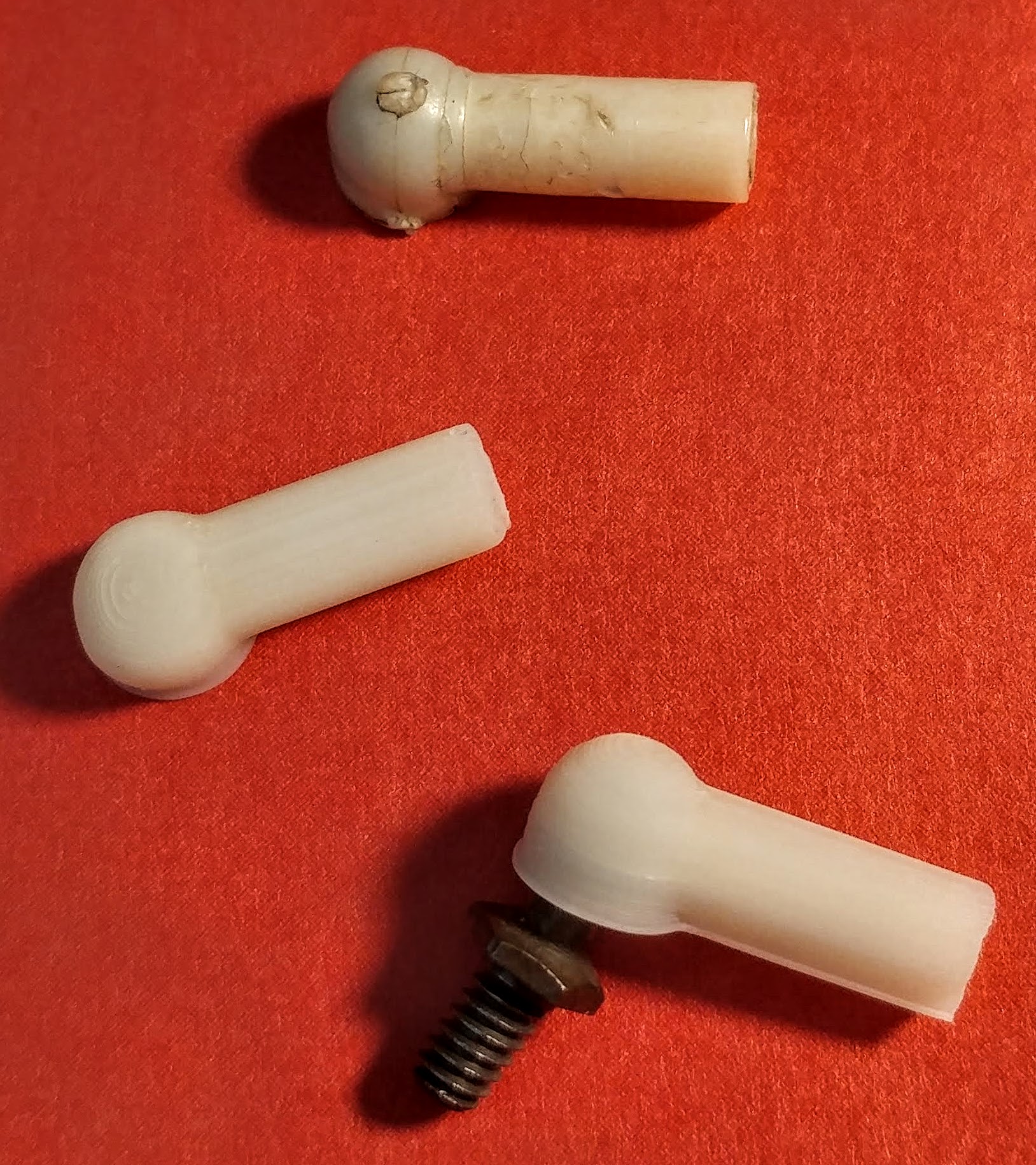

mtbkym01 wrote: Sun Mar 10, 2019 7:39 pm I just had another look at the car and hidden in plain sight are a few more ball cup issues, primarily a couple broken ones, and more missing on the rear :(
Now I’m not sure whether to obtain more dubro’s or look at other alternatives :cry:
What about a 3D printed part? I made a quick model and test print (with "white" ABS) of the early Edinger ball cup. I think the results are pretty good for a first pass. It would only be suitable for a shelf car, though. Aesthetics, and possibly durability, would be better with a pro printing service like Shapeways

ROH73 wrote: Wed Mar 20, 2019 11:11 am
WOW!!! they look amazing!!! :D

ROH73 wrote: Wed Mar 20, 2019 11:11 amWhat about a 3D printed part? I made a quick model and test print (with "white" ABS) of the early Edinger ball cup. I think the results are pretty good for a first pass. It would only be suitable for a shelf car, though. Aesthetics, and possibly durability, would be better with a pro printing service like Shapeways
To me this would be no different than using Chinese re-release parts. For simply displaying a nice car on a shelf … yeah, okay, maybe. For an actual detail-oriented restoration … uh, no.
You did a nice job printing those ball cups though. :wink:

ROH73
Posts: 623
Joined: Sun Feb 10, 2008 12:07 am
Location: State College, PA
Been thanked: 22 times
Re: Edinger? Time for some love
Post by ROH73 »
Thanks! It was a fun experiment on the "high detail" (0.12mm layer thickness) setting :D.
I agree; printed parts wouldn't be accurate for a true restoration, but sometimes reproductions are the best you can do the moment.
