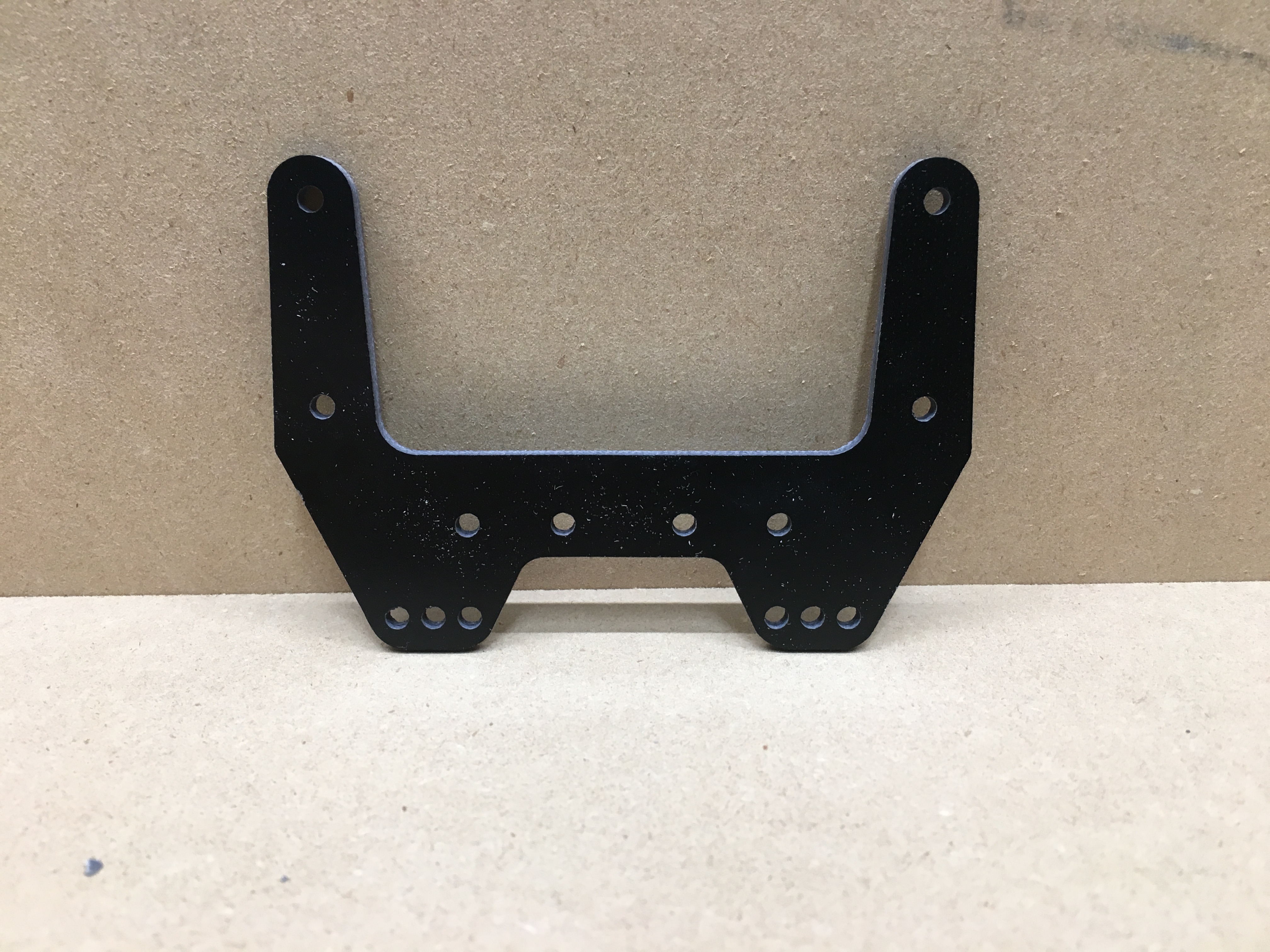

This is what the shock tower for that trans looks like. Camber link holes are built in. We manufacture these reproductions if you end up needing one.
As for the dogbones, if they are original parts this was common. There was a line in the manual I’ll see if I can dig it up

Wow nice man unfortunately I want to use my DS custom G10 shock tower and it will work since I can use the bottom two outer holes for the camber links but the 93t spur it came with is huge and I may put a relief in like the tower you posted or run a smaller spur....................GoMachV wrote: ↑Tue May 07, 2019 9:04 am This is what the shock tower for that trans looks like. Camber link holes are built in. We manufacture these reproductions if you end up needing one.
The dogbone thing I will wait for your response not sure what to do thanks bigtime man..
