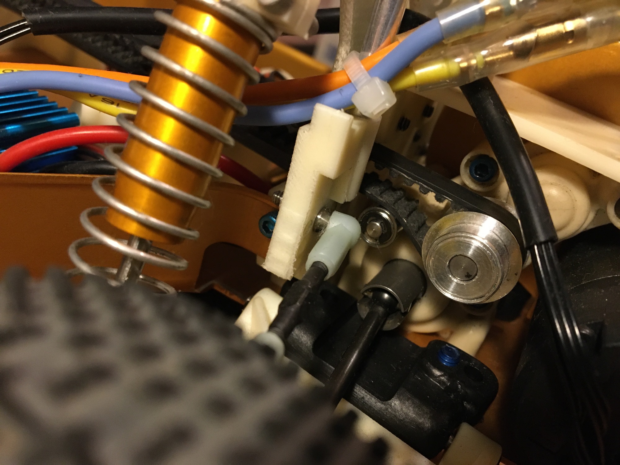

Hi, sounds like a cool project, I would advise against using the sp-1 rear transmission it wouldn’t really be in the spirit of the 4-10 legend.
As far as the belt guide you can use a 0.71” Shock shaft in one of the stealth transmission bolt holes.
It will screw into the motor plate.
I cant remember the exact stack up I used but there is an Edinger alloy shock spacer then a 1/8" shim 1/8 x 5/32" bearing another 1/8" shim and another 1/8 x 5/32" bearing and a standard 1/8" e-clip to hold it together.
Mine is on a ten-4 not a proper legend. The belt may be too tight, if so you can try the smaller 1/8 x 1/4" bearings instead.
If you have any trouble with the stack up let me know I'll take mine apart if necessary.

the MIP trans will have a different ratio than the legend front transmission. So you would have to adjust the pulley ratio, if it's possible. it's probably better to use the stealth trans, because you also would need the idler shaft for the MIP trans for the 4wd conversion which is not easily found. the idlers are not the same and the shaft diamters are different, metric vs english.
I think the ten4 bulkhead should be very close to what you need. i don't have experience with it, but the layout should be very close, since the pulley is driven from the idler in both designs.

Nice catch I hadn't thought of that. The gear ratio is wrong the sp-1 being 2:1 and the stealth 2.25:1jwscab wrote: ↑Mon Oct 07, 2019 3:46 pm the MIP trans will have a different ratio than the legend front transmission. So you would have to adjust the pulley ratio, if it's possible. it's probably better to use the stealth trans, because you also would need the idler shaft for the MIP trans for the 4wd conversion which is not easily found. the idlers are not the same and the shaft diamters are different, metric vs english.
Re: My 1st 4-10 Legend Build - Need Some Help
Thanks for the quick guidance. Looks like I will just stick with the stealth transmission. I am hoping that Brian has an additional hardware kit from his Ten4 builds he can sell me for the bulkhead...or maybe someone else has an extra one around.
