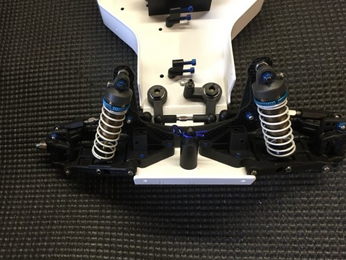

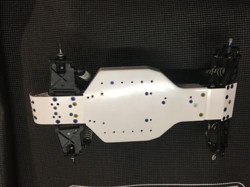

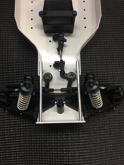

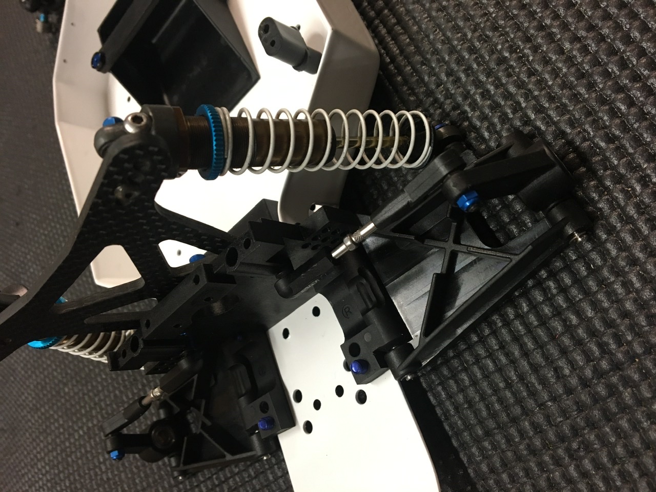

Front ends on 8)

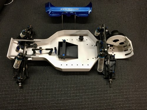

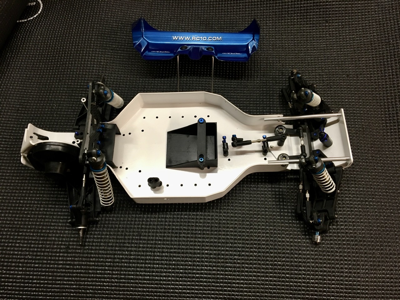

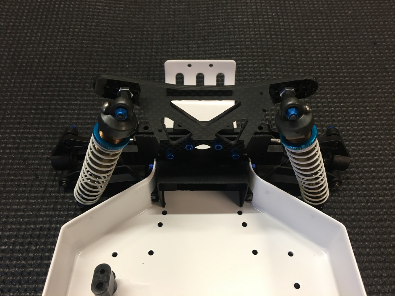

Rear bulkhead is on

Nice, the black against the white tub is a nice contrast. :wink:

Just chopped up some truck nose tubes (thunder tiger) for wing tubes
Need to make up the wing wire next

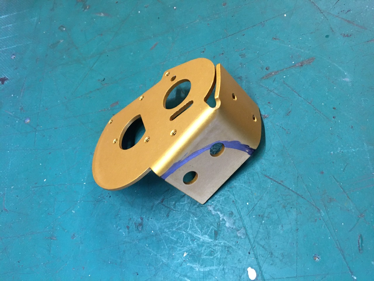

Motor place cut down and off to powder coat

Little it of progress

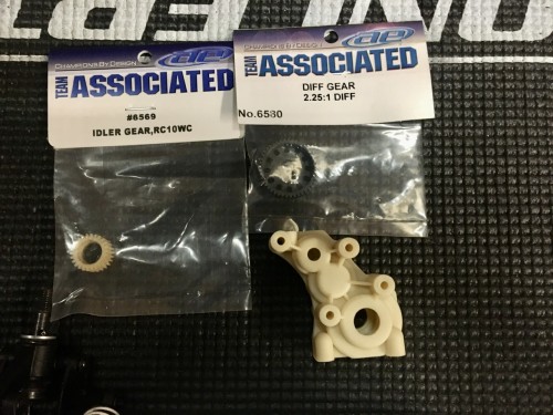

Managed to find a new MIP b4 top shaft, ordered gearbox bearings and got these new parts from Uk shop
Just need to dye the gearbox black and find a diff!
If in doubt go flat out!

I can never get the 3 gear trans cases figured out exactly.
Is that a 6564?
It seems as the 6564 is more difficult to work with.
I think I remember GoMachV recomending the 6565.

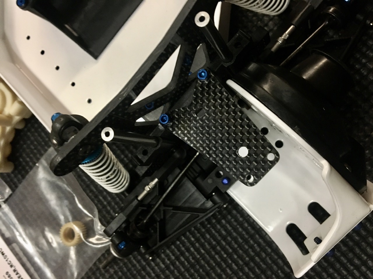

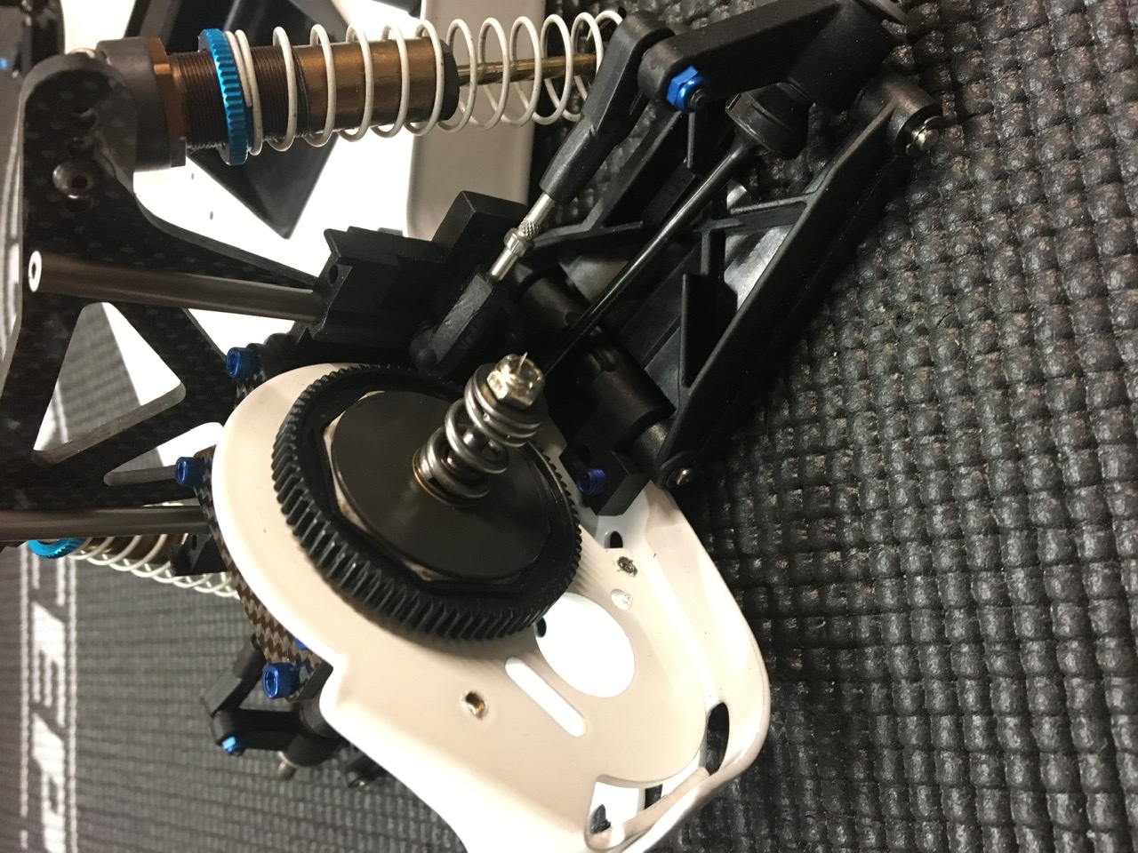

So dyed the new gearbox casing and found out that b6 slipper fits the B4 lay shaft so saved me some money!
But....the MIP slipped shaft has the spacer machined into it so it won’t work on the RC10 box so time to get it on the lathe and make it work!!

So my Dad got to work on the lathe and the lay shaft fits perfectly

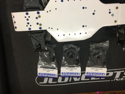

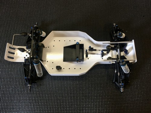

Just need to source a complete diff and it’s a roller
Managed to get the gear covers from a on line shop and took all they had
More blue screws added!
