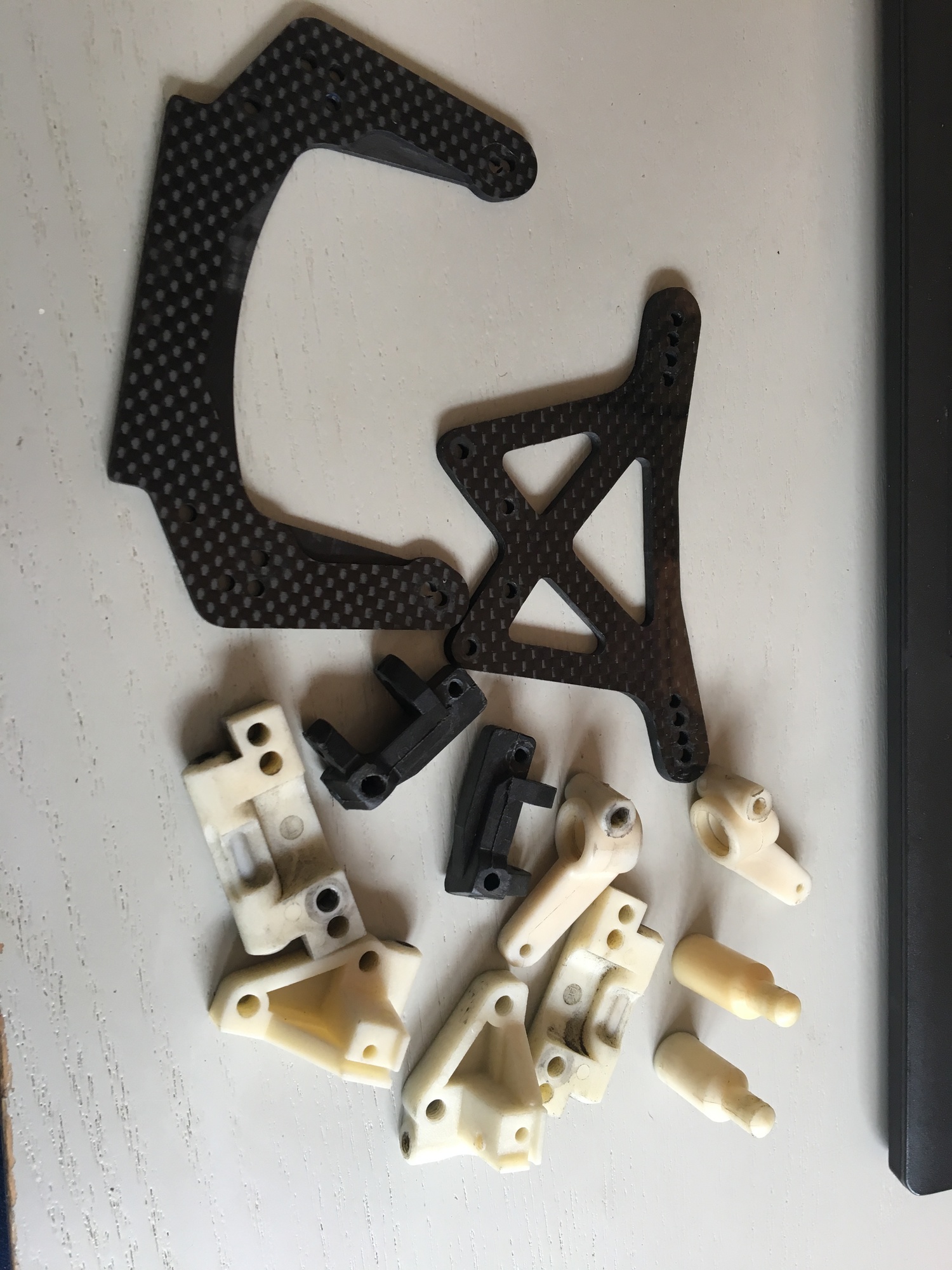

Had this old chassis from a 10t hung on the garage wall and thought what the hell let’s build another one!
Some of the bits are getting hard to come by but we will plow on and have a go!!
Chassis is going off to be vapour blasted as it’s covered in crap and old superglue and the plastics are going to be dyed black

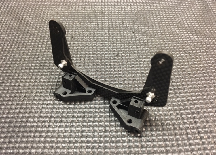

So the plastics had a wash and a bath in the rit dye and made a start on the front end (B4 c hubs/hubs)
I’m going with a black/blue theme

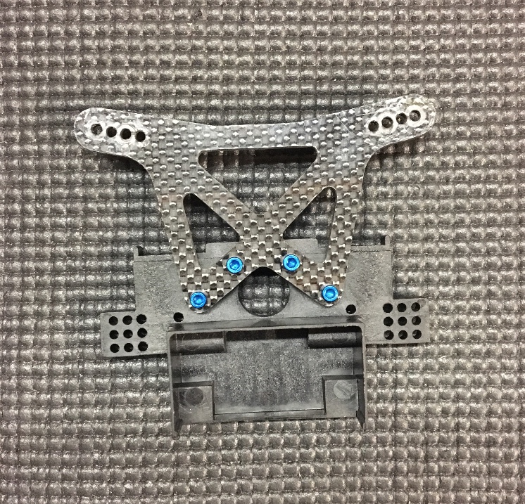

Few of the plastics fitted up with FT blue screws
