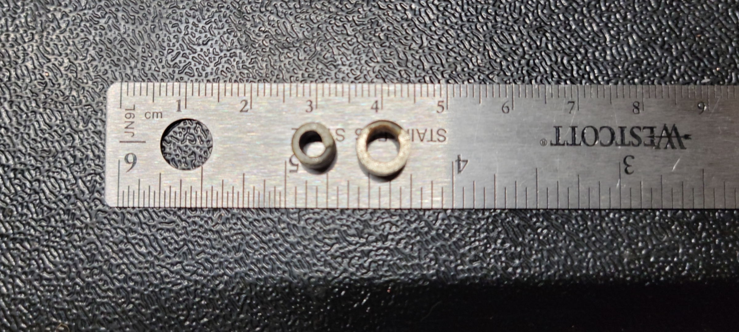

Hi folks,
has anyomne come across a modern, more-or-less equivalent replacement for the original stealth slipper spring, aka p/n 6587?
On another note - was there anything so special about the "thrust washer assembly" p/n 6594 - looks like plain washers to me, maybe hardened?
Thanks all!
Paul

the thrust washers are hardened.
i suppose you can cut down a b4 topshaft spring.

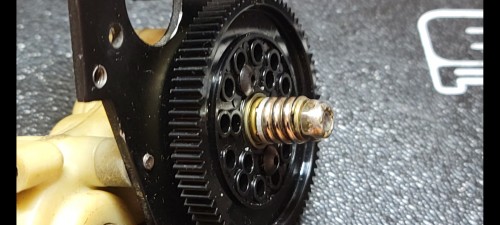

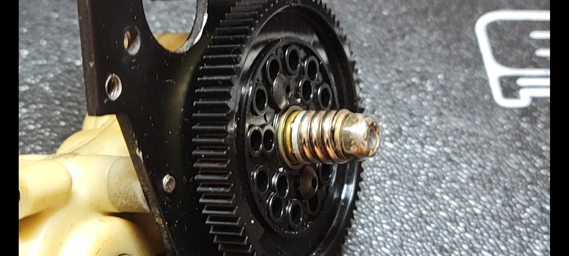

I'm going to revive this thread for 2022.
I am wondering if some of the slipper issues I have had are due to an old springs.
Is there a spring that is in production that can substitute?
Does anyone have information on the 6587 slipper spring for the v1 stealth?
Does anyone know the spec's of the spring to order it from McMaster or Grainger?
I might as well ask about the 6 gear diff spring 6628 while I am here.
I see a few on ebay in the $15-20 range each and that seems a bit much.

That Traxxas spring should be similar.
I found a place the end of last year that sold springs that matched the associated spring pretty closely in bulk. I'll have to dig it up. I think I figured out that something else is readily available. Maybe a Schumacher one? I think I just searched on Amain for springs.

jwscab wrote: Tue Jan 11, 2022 3:09 pm That Traxxas spring should be similar.
I see a few springs that seem like they could work,but posting here first is always seems to be the way to go. I don't to get a spring that fits but is too soft since the slipper will need to be clamped all the way down , or that is way to strong so it could never be adjusted correctly.
I am getting of of KidAgains CF slipper pads and want to give it a fair shake.

Oh also, for the hardened washers, I found a losi kit that has an assortment, useful for a few things.

Re: Original stealth slipper: 6594 + 6587 modern replacement?
The Traxxas spring is a little larger diameter but it does fit.
A piece of 3/16 tubing will fit inside of the spring. If I were going to try one, I'd use a short piece of tubing as a locator.
Looking at Amain, there are a few slipper springs that look promising. Schumacher has a couple. They are only ~$3 each, so I may find out soon.
