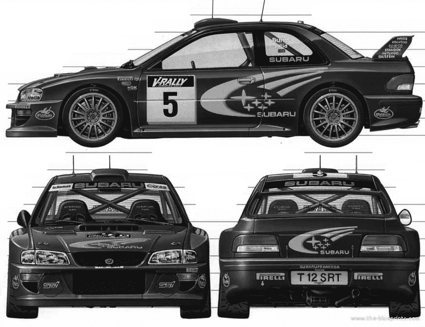

Here’s a reference image I’ve found on the net:

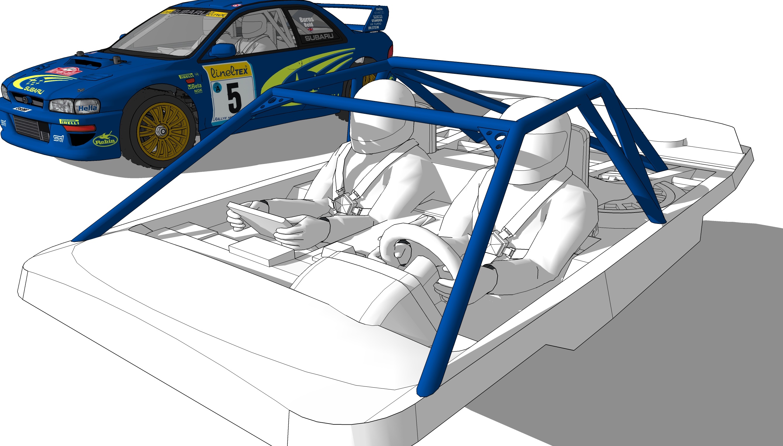

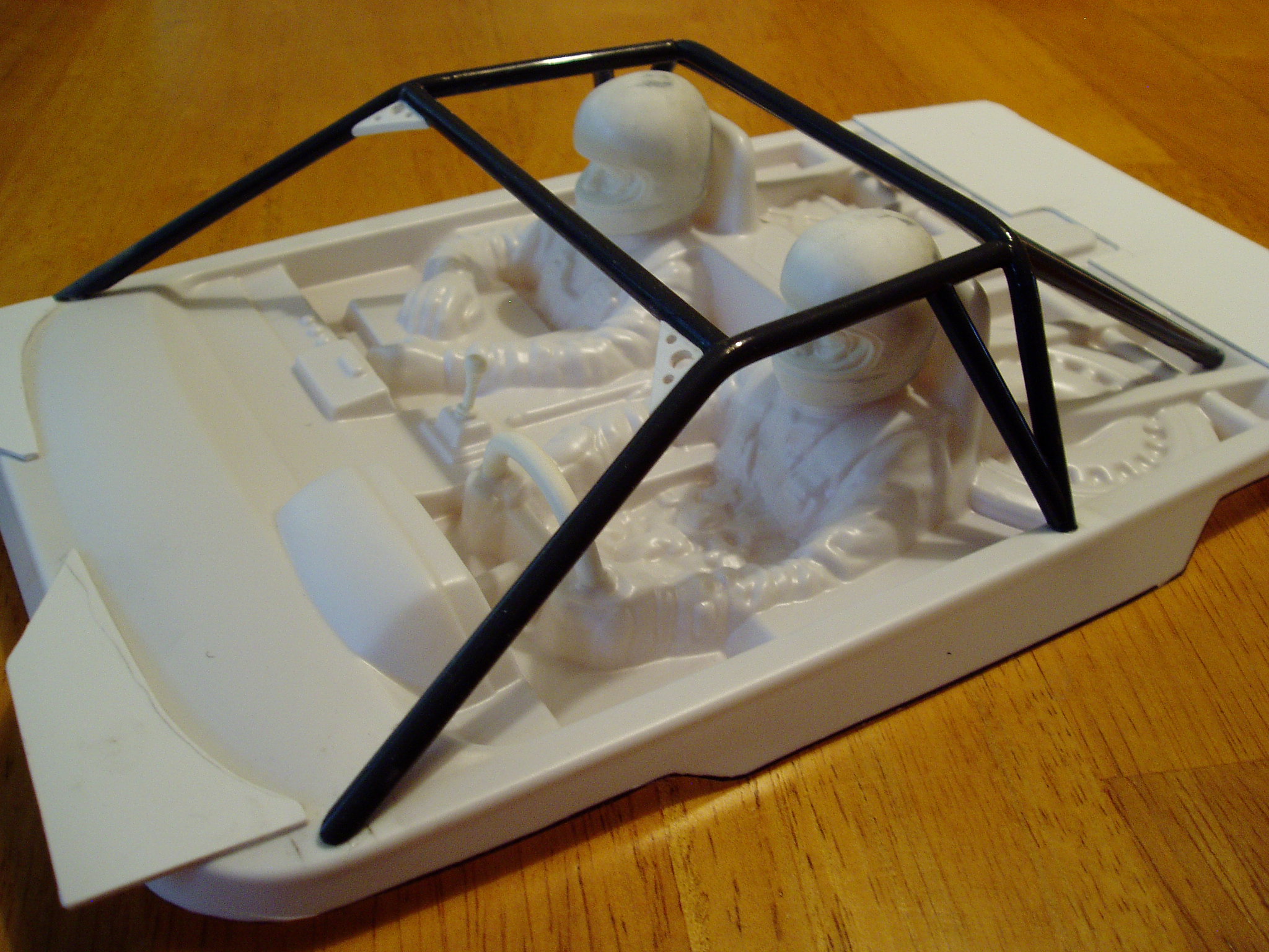

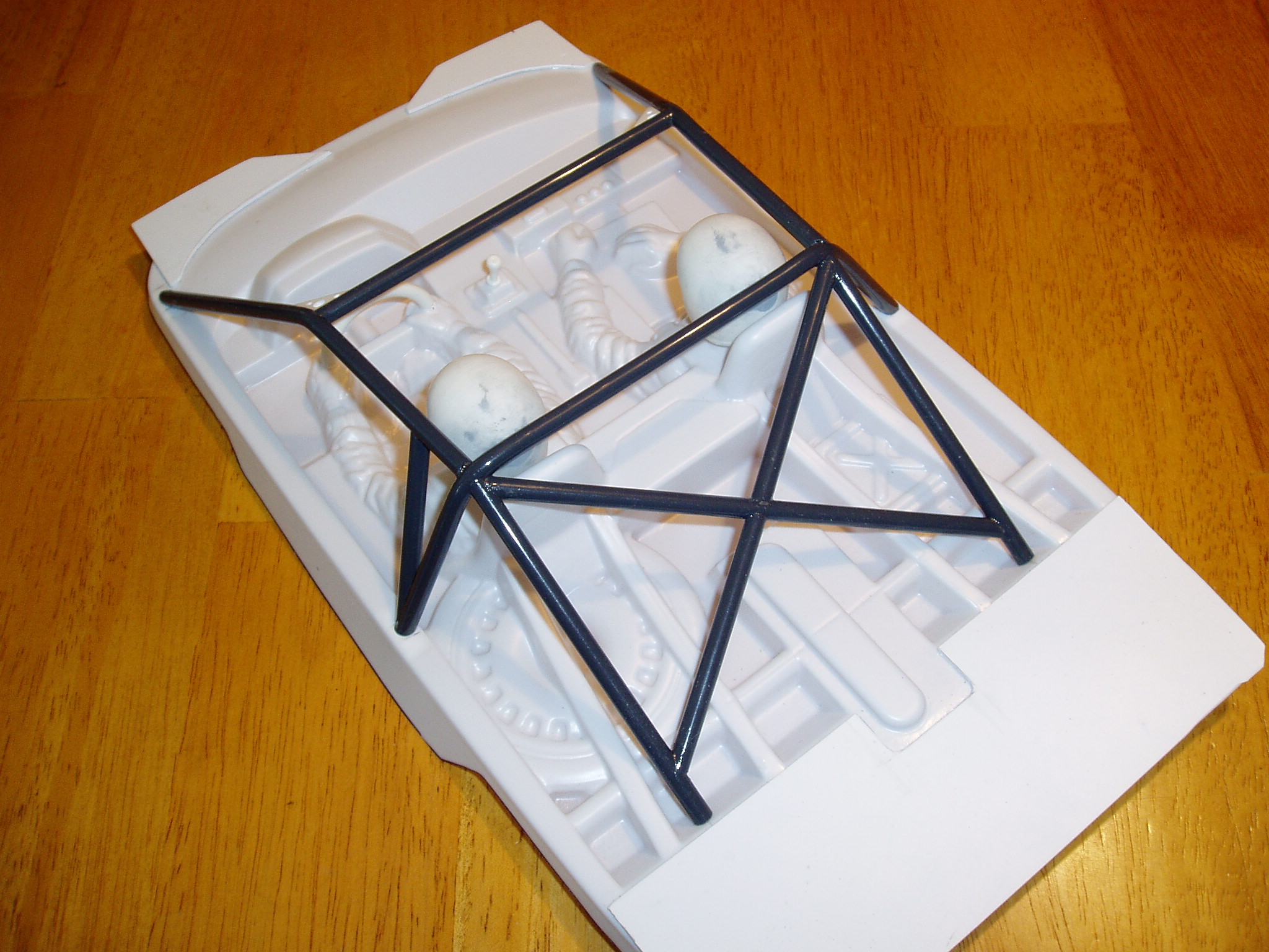

Here is the cage in design phase.

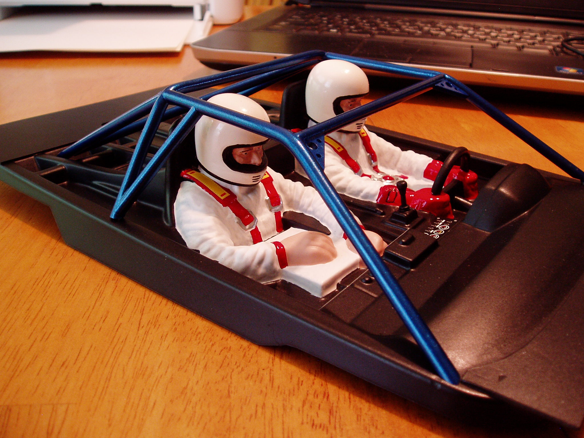

And here it is complete and nearly ready for paint. There are a few voids at some of the unions that need to be filled and sanded.
I’ve used 3/16” diameter ABS rod and bent it using a heat gun. Race car roll cages are typically made using 1-3/4” diameter steel tube so this plastic rod is very close to being 1/10 scale. The roll cage assembly is fastened to the driver’s pan using six M2 screws so it can be removed for painting.

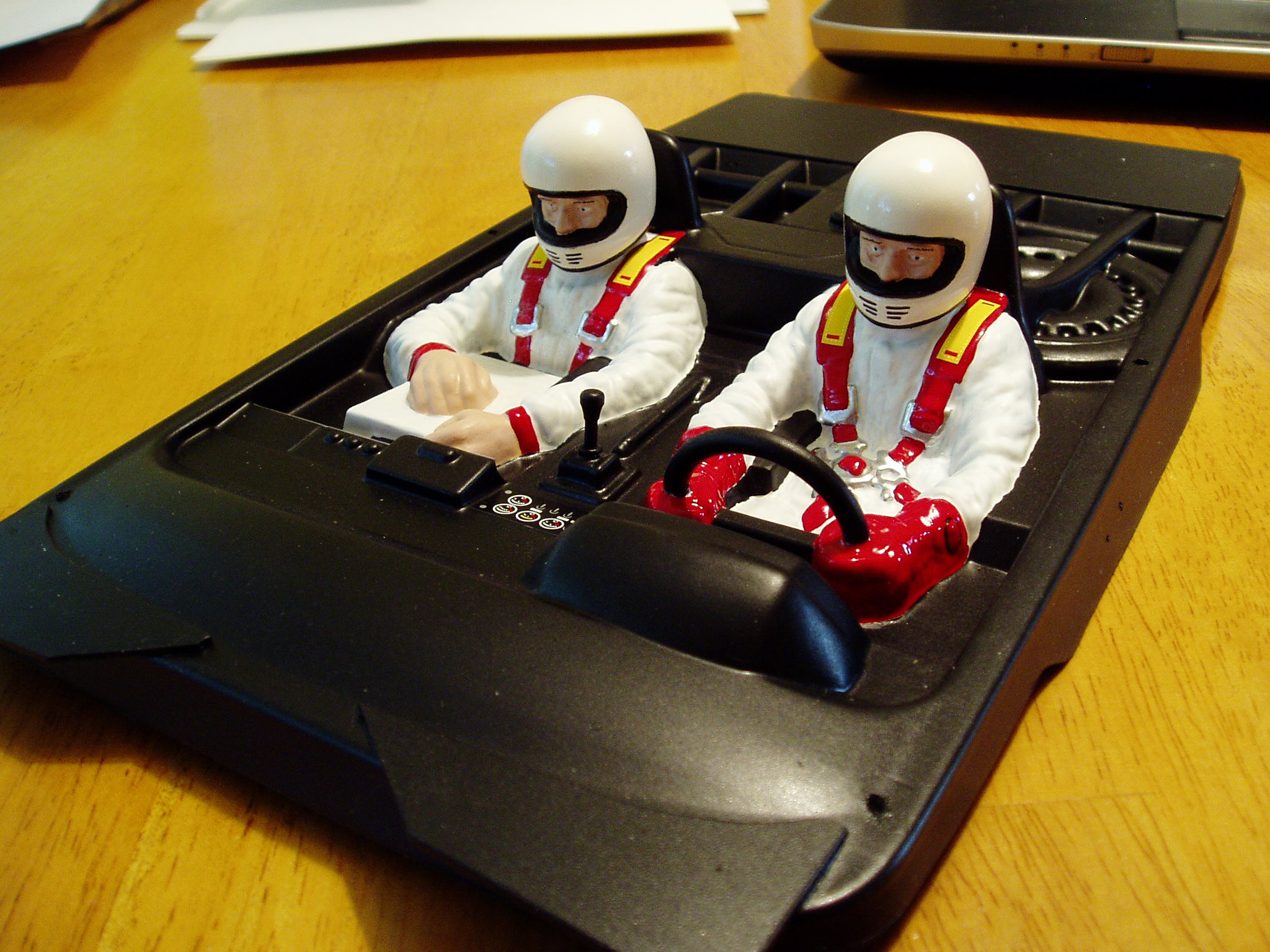

The pan will be matte black with some details like seats in gloss black, the racing suits and navigator’s notebook will be matte white, helmets gloss white and seat belts will be red. The cage will be Tamiya PS-16 metallic blue like the car body. There is a decal set supplied for the various gauges and switches.

So, the roll cage is painted and clear coated. I had just enough paint left in the can to finish the car - not one drop to spare.
A keen eye will spot the helmets protruding slightly above the top of the cage. oops!
Just need to finish the decals and install the mirror and it's finished.
And I probably should find some pacenotes for the co-driver to look at.

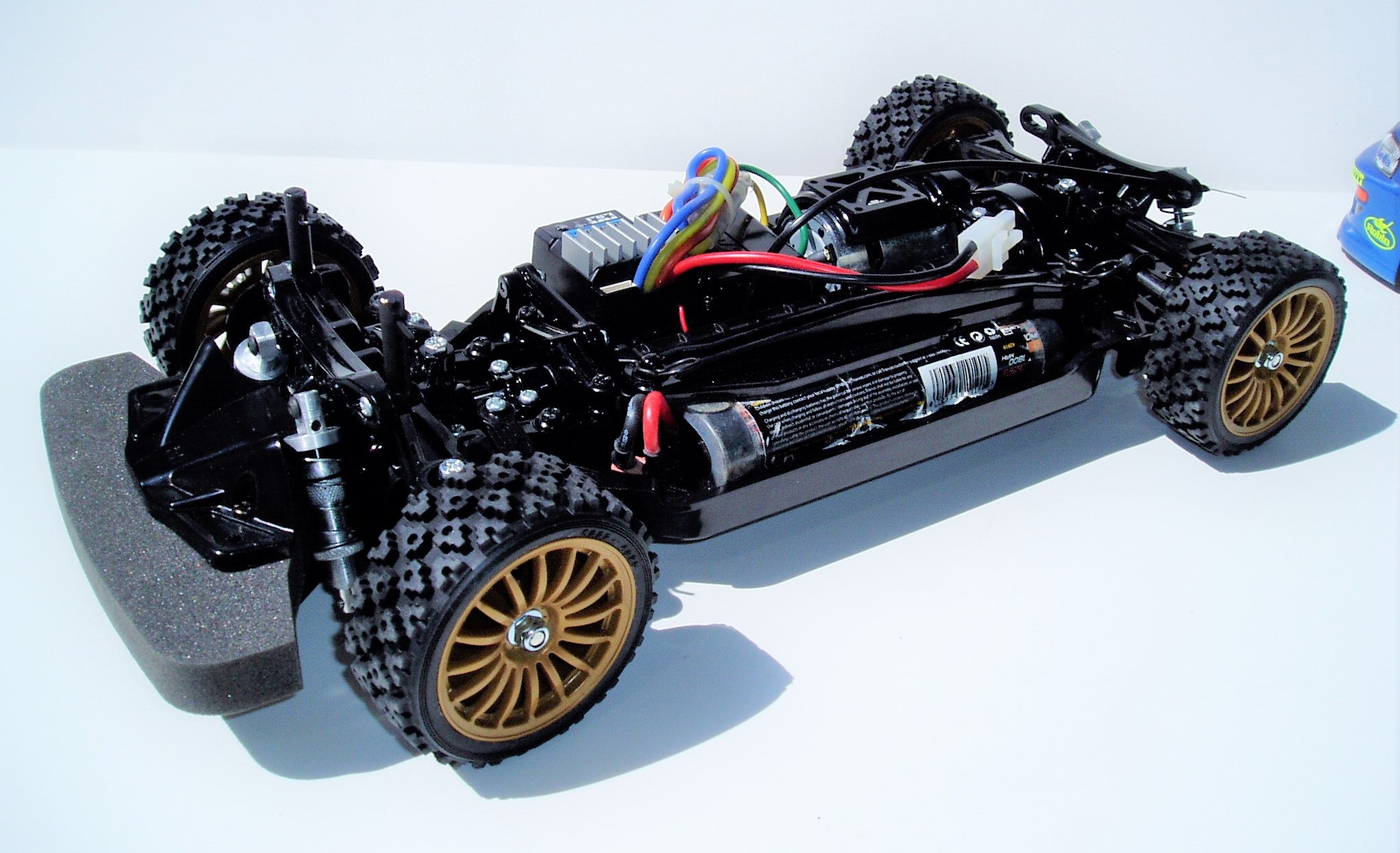

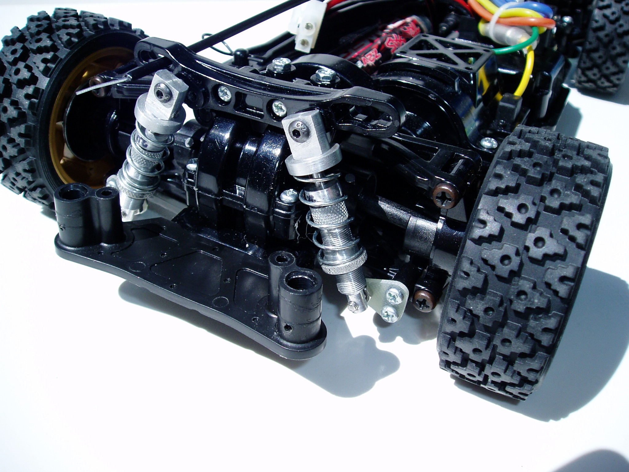

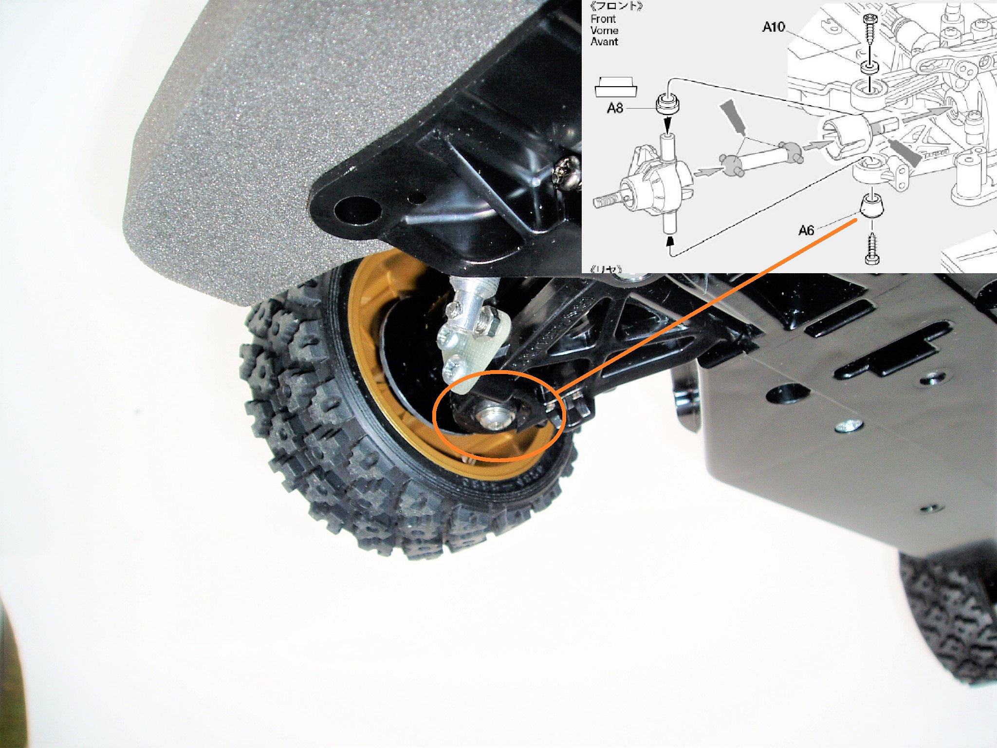

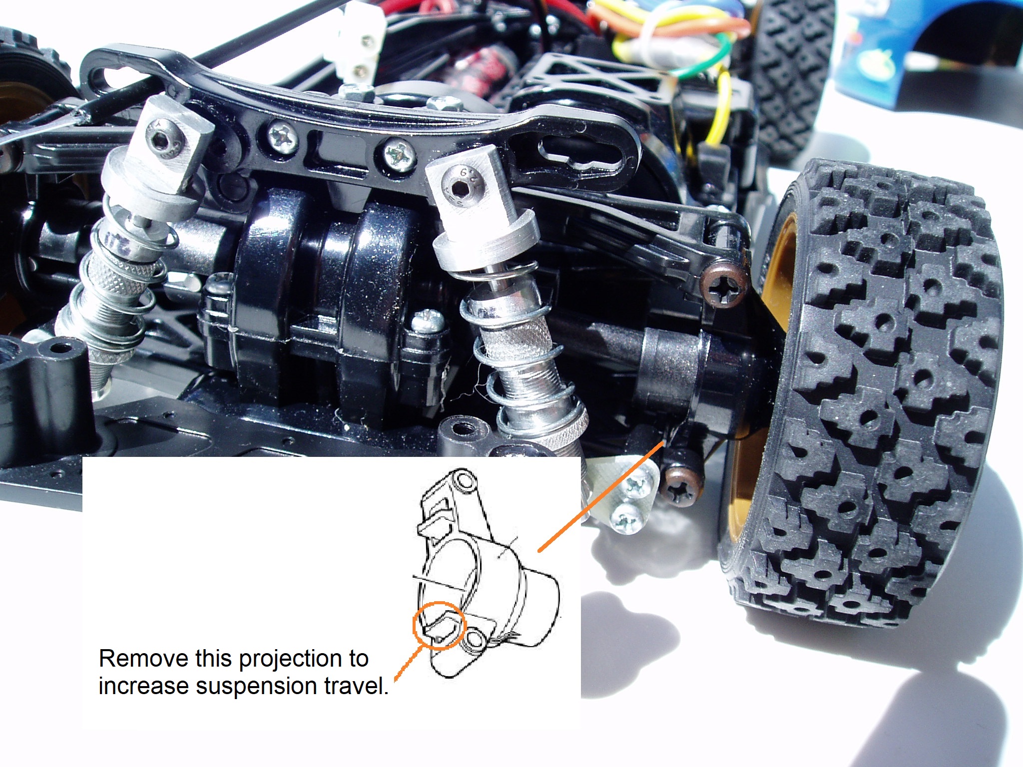

TT-02 Chassis and modifications:
A racer friend from bitd, Bill Birmingham, gave these shocks to me. They’re scratch-made one-offs patterned after the small Delta shocks we ran on our CW Dominators. He ran them a few times and didn’t like them so he passed them on to me and I’ve had them in a box for over 30 years.
The shocks fit this car very well but they were a little over-sprung so I’ve made some lower offset mounting plates from G10 to effectively soften them a bit. A by-product of the mounting plates is some increased suspension travel. My backyard track is very rough so I need as much suspension travel as I can get.
The TT-02 offers two wheelbase options (by flipping the rear A arms) and two ride height options (by flipping the hub carriers). The Subaru rally car requires the long WB option and it also requires the tall ride height but, either way, suspension travel is limited in the rear by way of a ‘droop limiter’ molded onto the inside of the hub carrier. I’ve removed these limiters and let the shock control droop.
In the front, for a taller ride height, we’re instructed to reverse the positions of two spacers that fit around the hub carrier pivot posts (A8 and A6). Installing the A6 spacer on the bottom of the post places its screw head very close to the ground establishing a potential hang-up point under the chassis so I’ve omitted the A6 spacer, trimmed the lower pivot post on the hub carrier, and installed a button head machine screw. Having done this, none of the suspension parts hang below the bottom of the chassis tub.
Next up, pics of the finished car.

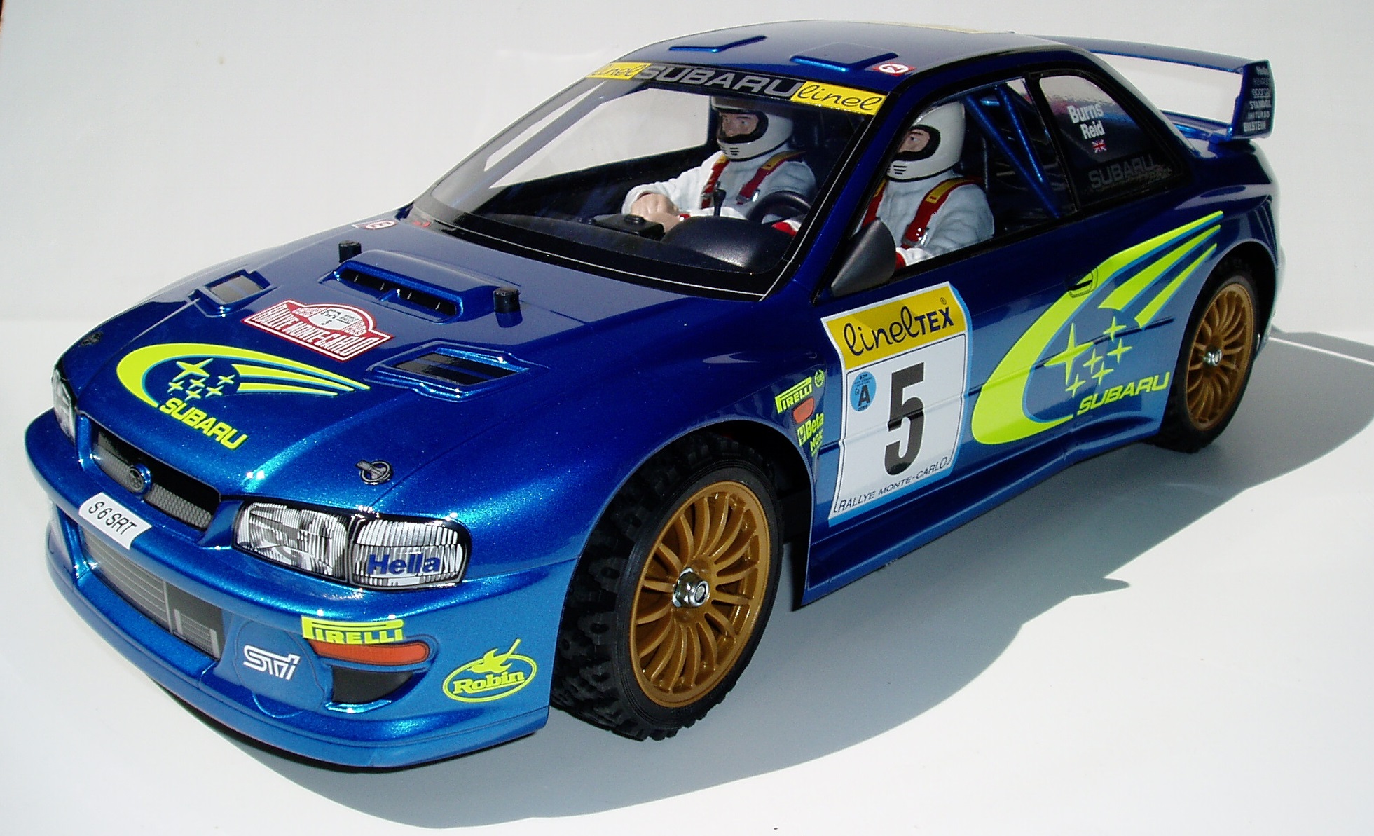

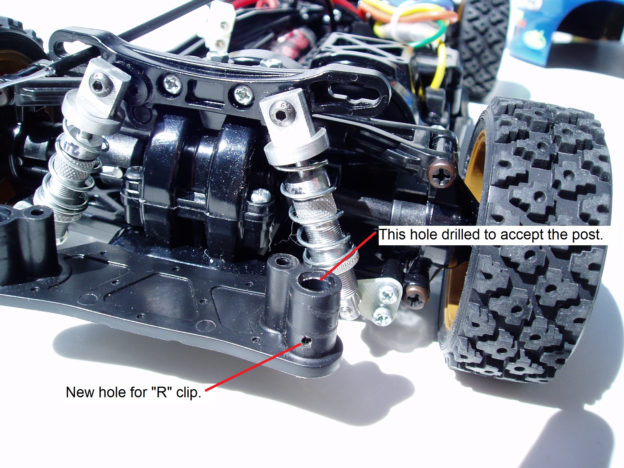

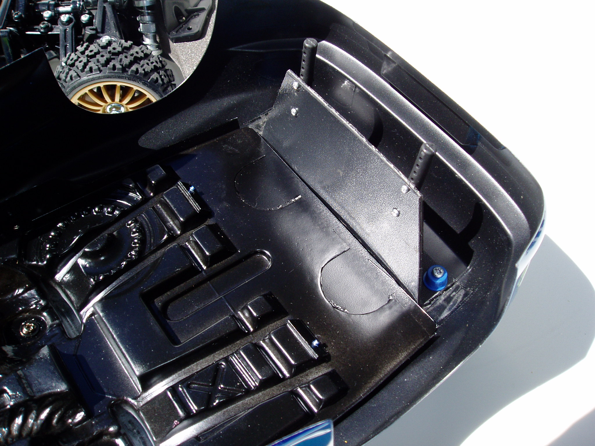

Anyway, there's one final modification to the Scooby that I’d like to cover. The body came from Tamiya with body post holes cut through the hood and rear glass. With the addition of an interior set, a pair of holes are also required through the interior pan’s rear package shelf area. Having body posts protrude through the hood seems acceptable but I think having posts poking through the back glass detracts from the scale appearance of the car so I’ve devised an alternative mount.
The rear posts have been attached to the body inverted and fit through existing holes in the rear bumper mount. I just needed make a bracket, enlarge the holes to fit the post and cross drill a set of holes for the “R” clips.
At the back of the body, I’ve made a Kydex “L” bracket, screwed the body posts to the bracket and attached the assembly to the body using the wing mount screws.

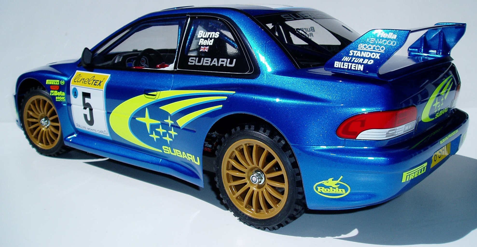

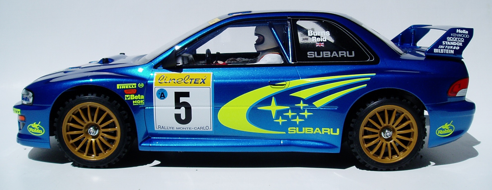

And here’s the finished car.
Overall, this was an enjoyable build. My only complaint centers on those annoying cross-slotted screws. They require so much force to drive that it’s hard to tell when the screw is tight or when it’s been over-tightened pulling the threads through the hole. This was especially true when driving them into hard plastic. I’ve resorted to applying a small amount of grease to these screws to reduce friction and make it easier to detect when they were tightened. I really wish Tamiya would switch to hex machine screws for these kits. This might add perhaps $3 or $4 to the price of the kit and I would gladly pay that.
I think the best part of this kit is the body and decal set; the level of detail and quality of the entire body set is simply outstanding.
