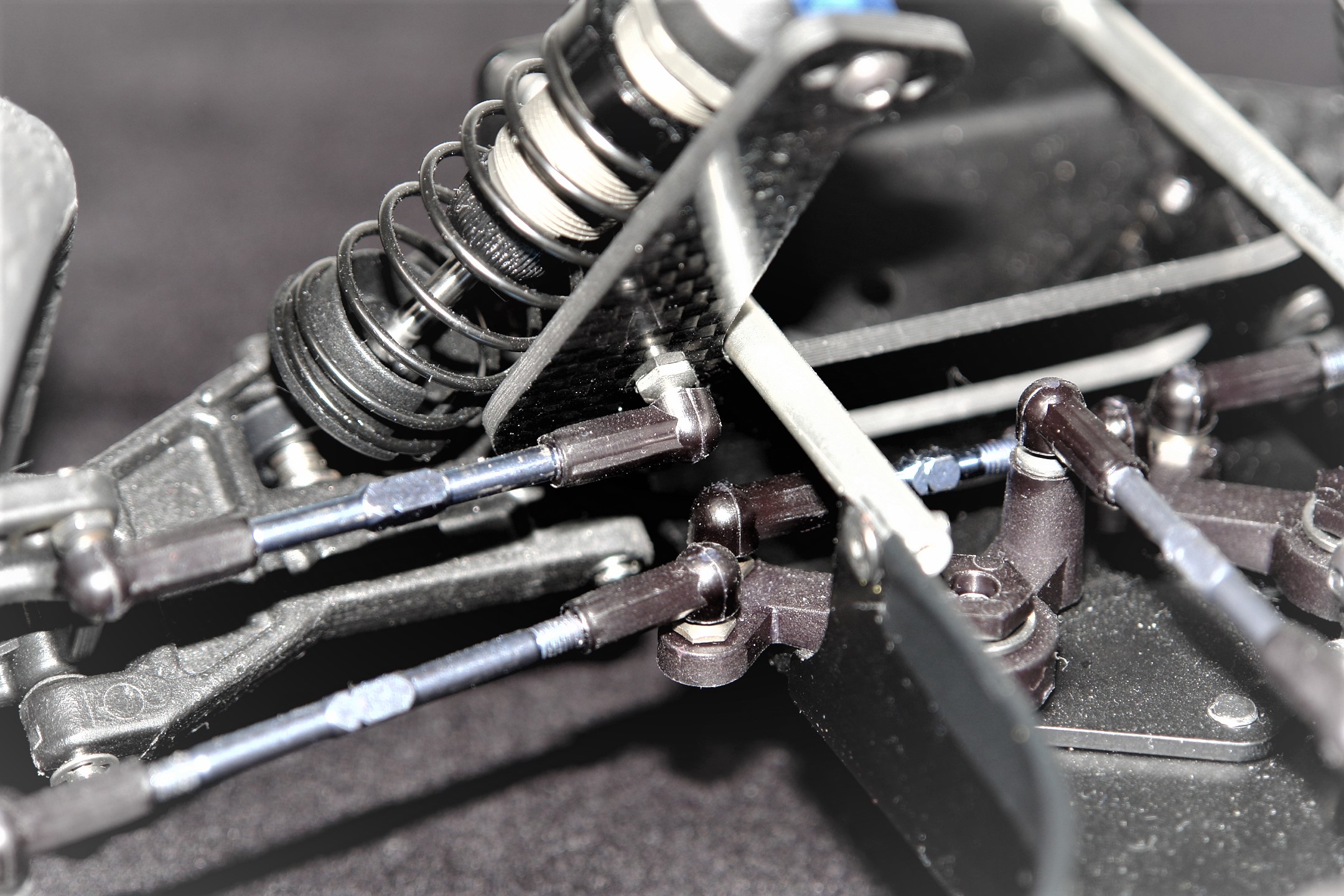

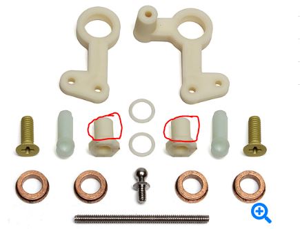

Now - the steering. This one had me scratching my head, and not even reach an optimal solution. The beauty of Franken projects
I think I recall the great Asso-man himself saying he doesn't know who actually made these bellcranks... On the pictures, they actually look pretty well thought-out:
There are flanged sleeves in the bearings, so the nuts that hold them can be tightened without binding (this has its importance as you will read later on). There are two holes for the servo link to possibly play with speed/torque, and adapt to smaller servos I guess.
Once cleaned up and polished a bit - I would love to buff them out but I don't have the gear to do so. If anyone wants to suggest a pragmatic approach to making them shiny...
First attempt at mounting them was a total failure. What I found out is, the nose plate is not threaded... so I put a nut on the 8/32 screw, at least to hold the nose and the tub together. This then creates that first issue, which is pretty obvious (look at the ballstuds, steering and camber)
Then for the next couple of evenings, I tried things back and forth, shimming the steering differently started looking into drilling the front shock tower for new camber links holes, tried different lower-profile ballstuds, realized that some of the ballstud holes are stripped, installed different ballcups once it got lowered but they still rubbed, etc...
Net - I mounted the ballcranks directly on the chassis, which is made possible by the flanged sleeve. Then I used the thinnest ballcups I know of - this is from my B4 stock as I replaced them right away with RPM ones, and I don't ever throw anything away
When I use new parts, I always check the availability of them on the market, just to be on the safe side... These are pretty rare by now it seems
who would have known? The good news is I have a couple of translucent green re-re ones which can't wait to be dyed

Re: It's starting now (Apr2020)... CWF (tub) and Shiny RC10
So after a lot of fiddling, and many many screwing/unscrewing of ballcups onto turnbuckles, this is what we end up with:
It fits. This is not my favourite ballcup design, but it's still politically correct (as my friend @Patriiick coined it
) and it *just* works. The Lunsford Punishers ballcups went back in the bag. One day when I have my press-drill I will revisit this I swear
I also need to figure out what I do with the center hole at the tip of the nose plate... as said, the nose plate hole is not threaded, and is too big. I could fit a nut on there, but the bellcranks hits it when turning left. I know it's a shelfer, so not critical but still. If someone has a good idea, other than raising the steering and redrilling the front tower
(Jeff - how much is a front CWF worlds tower with a raised camber link hole, please?
You will also notice I dropped the RCPS turnbuckles... I found out they were for the Truck. Which is fine because I had a set of punishers ready for a WC anyway. Which actually required me to do more disassembly and do this:
you will notice how the hex of the aluminium ballcups is somewhat chewed up - that's because any wrench barely fits under the wing tube plastic-holding bit...
Net - after a few hours of camber-steering-other links fiddling with, and with sore fingers, I could finally snap a pic of something that is now beginning to resemble an RC10
Now on to the shocks
(TBC)
(TBC)

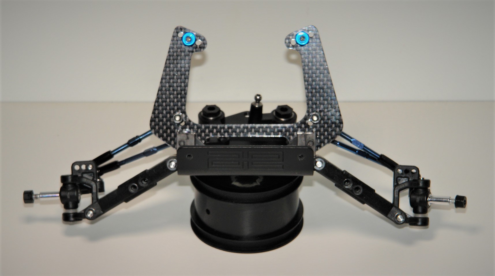

Hi Lonestar
What a great build!
Maybe have a suggestion for the clearance between the two ballstuds.
I have found short neck ballstuds give a tiny bit more clearance if used on the tower.
If used on the outside of the bellcranks mine bound up the ballstud cups under full droop, so they did not work for me there.
The ones I tried were on the "Losi style" bellcranks, yours might have better clearance.
Also The ball stud on the steering block?? Never tried it on the bottom
Chuck
What a great build!
Chuck
I have a burned noseplate, it was anodized or stripped too long so the tapped holes are not right. So I have basically the same issue as you. I have a solution for both problems.
One,. I made custom aluminum nuts for the bellcrank. They have a hex on top, essentially the same type as a world's steering nut. You place then bellcranks on upside down and place a shim on top. When you bolt it all together the bearing rides on the shim,
For the center bolt, i used a #6 pem nut. This fit in to the hole and has a very good profile.
You could try to raise the bellcranks up far enough so the ballstuds en cups could be mounted on the bottom. Maybe this resolves some of the bump steer as well.Lonestar wrote: ↑Mon May 11, 2020 10:41 am
I also need to figure out what I do with the center hole at the tip of the nose plate... as said, the nose plate hole is not threaded, and is too big. I could fit a nut on there, but the bellcranks hits it when turning left. I know it's a shelfer, so not critical but still. If someone has a good idea, other than raising the steering and redrilling the front tower(Jeff - how much is a front CWF worlds tower with a raised camber link hole, please?
Just so happens my B1,B4,B6 has one of Jeff's front towers.
The position I used for the ballstud on the tower looks maybe slightly higher and a little outboard than yours. There two hole to choose from, I used the uppermost and outer.
From the top of the nosepiece to the top of the ballstud cup on the world car bellcrank it measures 13mm. This combination yielded almost 3mm of clearance. Your combination appears a little taller maybe.
I am using B4 front carriers, 2mm ballstud spacer on the spindle. I really like how it worked for me. Very little bump steer/camber gain and decent ackerman.
May or may not be helpful with your bellcranks...
(wow my plastic parts sure looks purple)
Chuck
Chuck
Thanks Chuck.radioactivity wrote: ↑Mon May 11, 2020 11:29 am I have found short neck ballstuds give a tiny bit more clearance if used on the tower.
Also The ball stud on the steering block?? Never tried it on the bottom![]()
I installed the shortest-necked ballstuds I have... It fits now, but just by a hair. Raising the bellcranks even the tiniest bit will not work.
regarding the steering ballstud facing down - that emoji will do:
I can't believe I've made this mistake
Actually, I can... again, working on this stuff at night, I do silly stuff sometimes
Cheers Joe for sharing.jwscab wrote: ↑Mon May 11, 2020 1:11 pm
for the first part - so that custom nut holds the tub and the nose together via the 8-32 steering screws-posts, and then there is a second nut on top, did I understand this right? My issue is that the raise induced by *any* nut makes the bellcrank ballstuds and the shock tower one hit each other. I initially tried to use the thinnest nut I had but even then... the good news is that the sleeve that the bellcrank bearings ride on is (purposedly) thicker than the bellcranks, so that alloy nut that sits on top of the bellcrank now, it can be cranked down enough to hold both CWF parts together - it's the sleeve that takes the pressure. I still don't like it though.
for the second one - had to look up what a pem nut was - as usual, my mechanical knowledge is sub-par
Thanks Marijn. The issue is that between the camber ballstud and the nose plate surface, there is *just* enough space to fit the thickness of the bellcrank "tip", and the ballstud/thin nut at all. The nut is needed because some of the holes are stripped
Thanks Chuck, appreciate the extra info. I think I will actually ping Mr. GoMachV to have a custom tower made...radioactivity wrote: ↑Mon May 11, 2020 5:36 pm Just so happens my B1,B4,B6 has one of Jeff's front towers.
Overall, I am begining to wonder if that steering is made for this car at all... the very fact that it's so squeezed in there, plus that no-one seems to recognize what it is, is making me skeptical. It's very nicely machined though, so whoever would have done this as a homebrew in his garage 30yrs ago was very talented

As for the nut, no, there is no nut below the bellcrank, just a small shim to keep it from rubbing. It's almost identical to how a world's steering setup is, I just used stainless screws and aluminum nuts so it was stronger than the aluminum screws and plastic nut.
I can probably make some if you need and I think I might still have some pems.
I'd need to get some dimensions from you. Later today I'll post some pictures.
- Lonestar
- Posts: 4270
- Has thanked: 623 times
- Been thanked: 171 times
Thanks Joe for your patience. Then I think the setup is similar to the one I have, where the same nut that holds the steering to the nose plate is the one that also holds the chassis and the nose plate together... It actually works on mine, because the sleeve is acting like a crush tube, so I crank the nut down and still not lock the bearings (and the steering)jwscab wrote: ↑Tue May 12, 2020 9:08 am As for the nut, no, there is no nut below the bellcrank, just a small shim to keep it from rubbing. It's almost identical to how a world's steering setup is, I just used stainless screws and aluminum nuts so it was stronger than the aluminum screws and plastic nut.
Or are you saying that the nuts you machined actually have the sleeve built-in, like what's circled in red? (that's AE6252)
Thank you!!!
