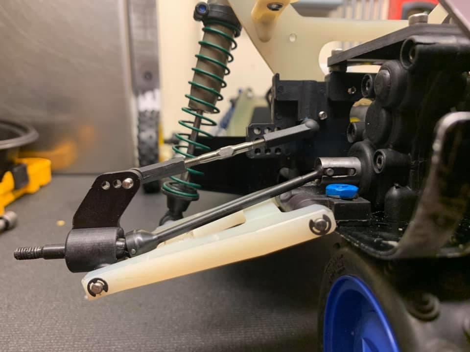

Since I’m a restless RC person, I like to experiment, someone suggested the Custom Works front hex conversion, I ordered A set, mounted it, and it works awesome, the only thing is, you’d either have to use a long shank rod end, or use a shorter ball stud on the inner most hole on top of the caster block....simple
IT WORKS!!!
IT WORKS!!!

Also, I ordered a Medium Length CVD Kit from Custom Works, and with the GT hubs, it wouldn’t get full up travel, sufficient, but not complete, because it would hit the inside if the outdrives, so I ordered B4 hubs, and used some creative spacing, and it also works fine, full up and down travel👍

Might order 1.18” B44 rear shocks to limit the down travel a bit, and it should be 👌

tecnica2001 wrote: Tue Jun 02, 2020 6:59 am Might order 1.18” B44 rear shocks to limit the down travel a bit, and it should be 👌
That can be solved with inner and outer shims on the shock shafts!
