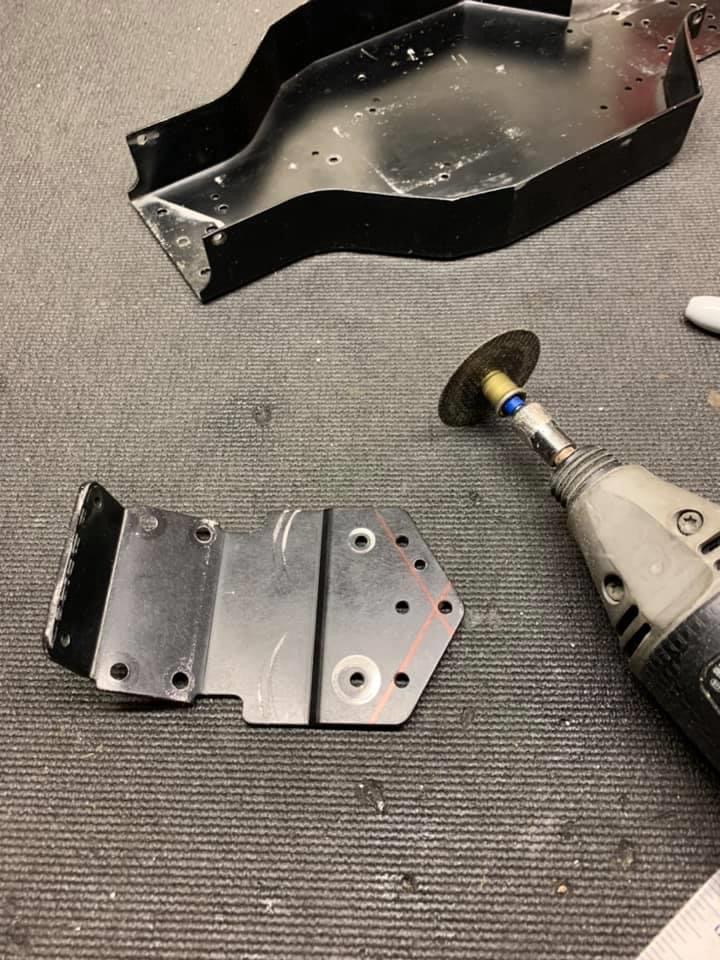

Progress:
Cut and mounted the nose plate

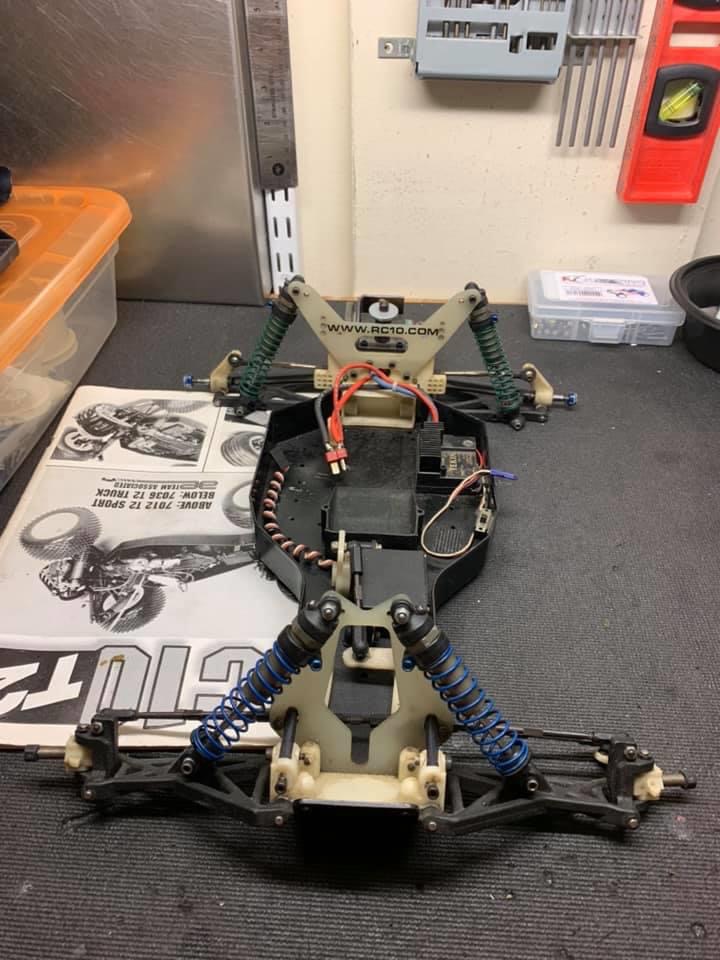

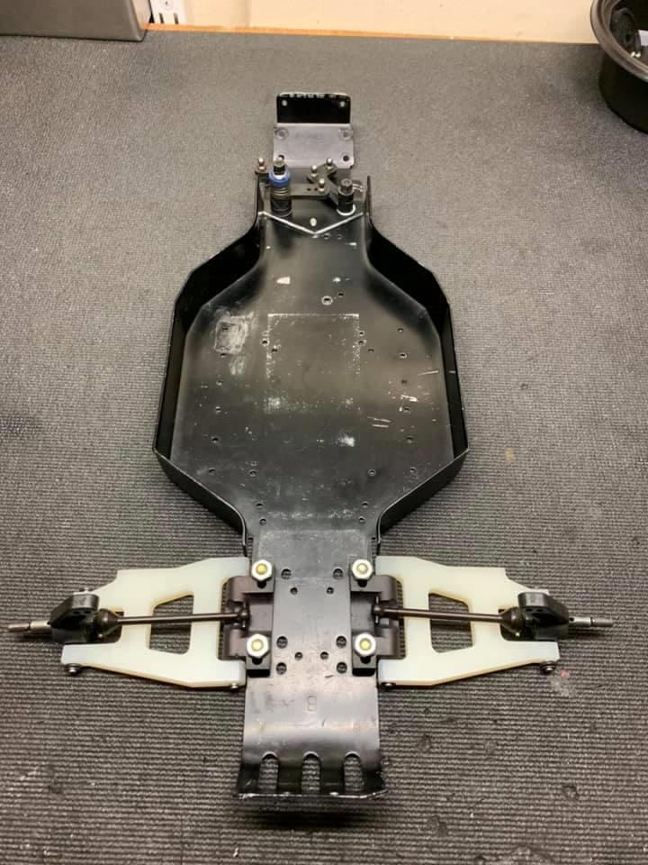

Mounted the rear Klein arms, b4 hub carriers, and threw some B3 CVDs just to have a visual, need to order a set of B44 CVAs....

And the arm mounts are mounted on the wrong side😂😂😂😂

A bit of progress:
I might go for the carbon 10T towers and big bore shocks....still awaiting B4 CVDs, turnbuckles, diff rebuild kit, steering bellcranks, and off course electronics....😁

I'd get new towers and not run the truck towers, Standard buggy in rear is fine, and an RPM version up front. That will reverse the shock positions, more upright up front and less upright out back. as it sits the progressive rates are 'off'
Jeff (factory works) makes some sweet towers, you can get one that uses the built in wing mounts in the rear instead of wires. I can't keep wings on my buggies :lol: :lol:

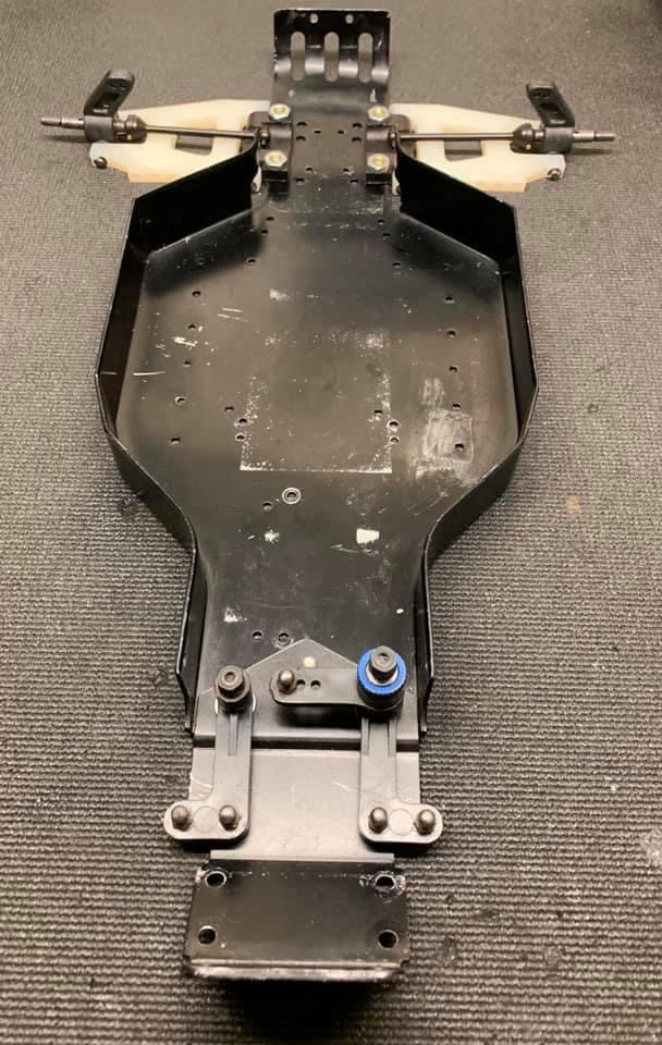

Didn’t realize how expensive things are now for these cars, geesh....anyway, decided to make a pair of nose brace tubes, it was easier than I thought😁

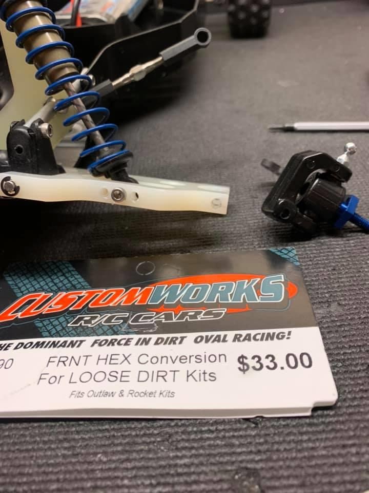

Since I’m a restless RC person, I like to experiment, someone suggested the Custom Works front hex conversion, I ordered A set, mounted it, and it works awesome, the only thing is, you’d either have to use a long shank rod end, or use a shorter ball stud on the inner most hole on top of the caster block....simple
IT WORKS!!!
