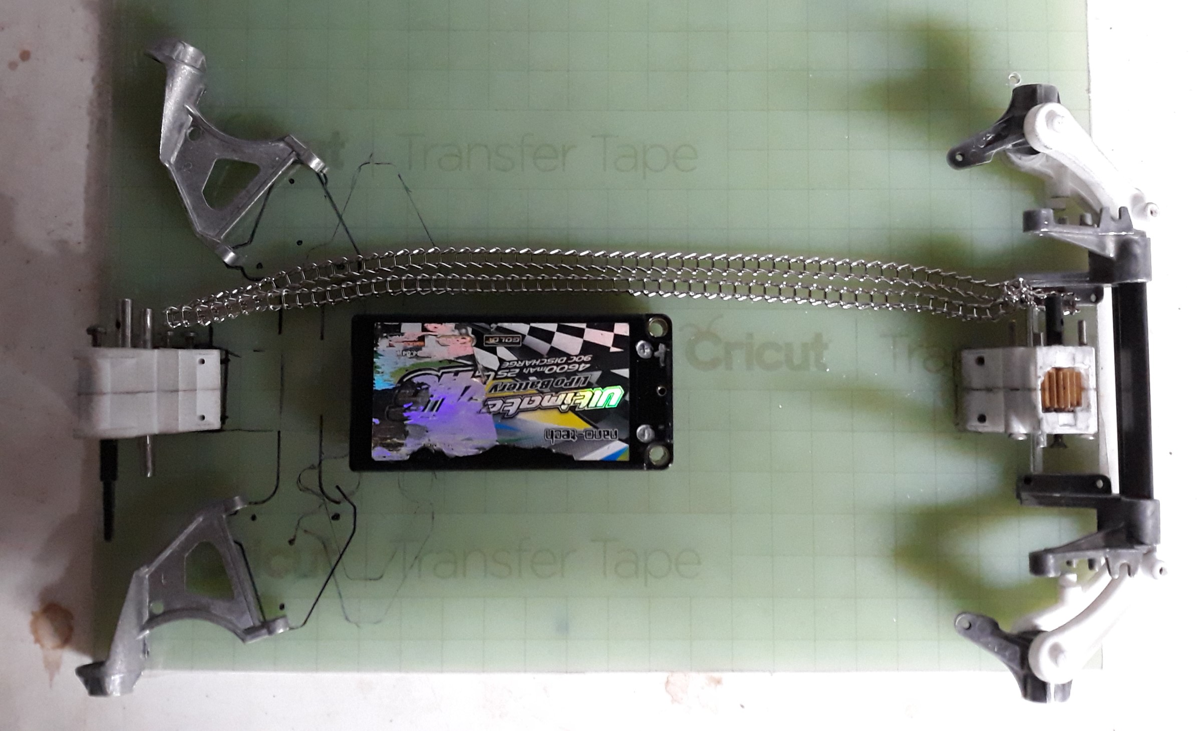

In admiration of 1300GT's 4wd SRB, I'm starting on my own attempt at building a similar car. I figured out a B4 slipper gearbox setup in this thread - https://www.rc10talk.com/viewtopic.php?f=32&t=44855
Now I'm mocking things up for the chassis. 2 3D printed replica MIP gearboxes, 3D Printed front arms, Optima front hubs, Scorpion trailing arms.

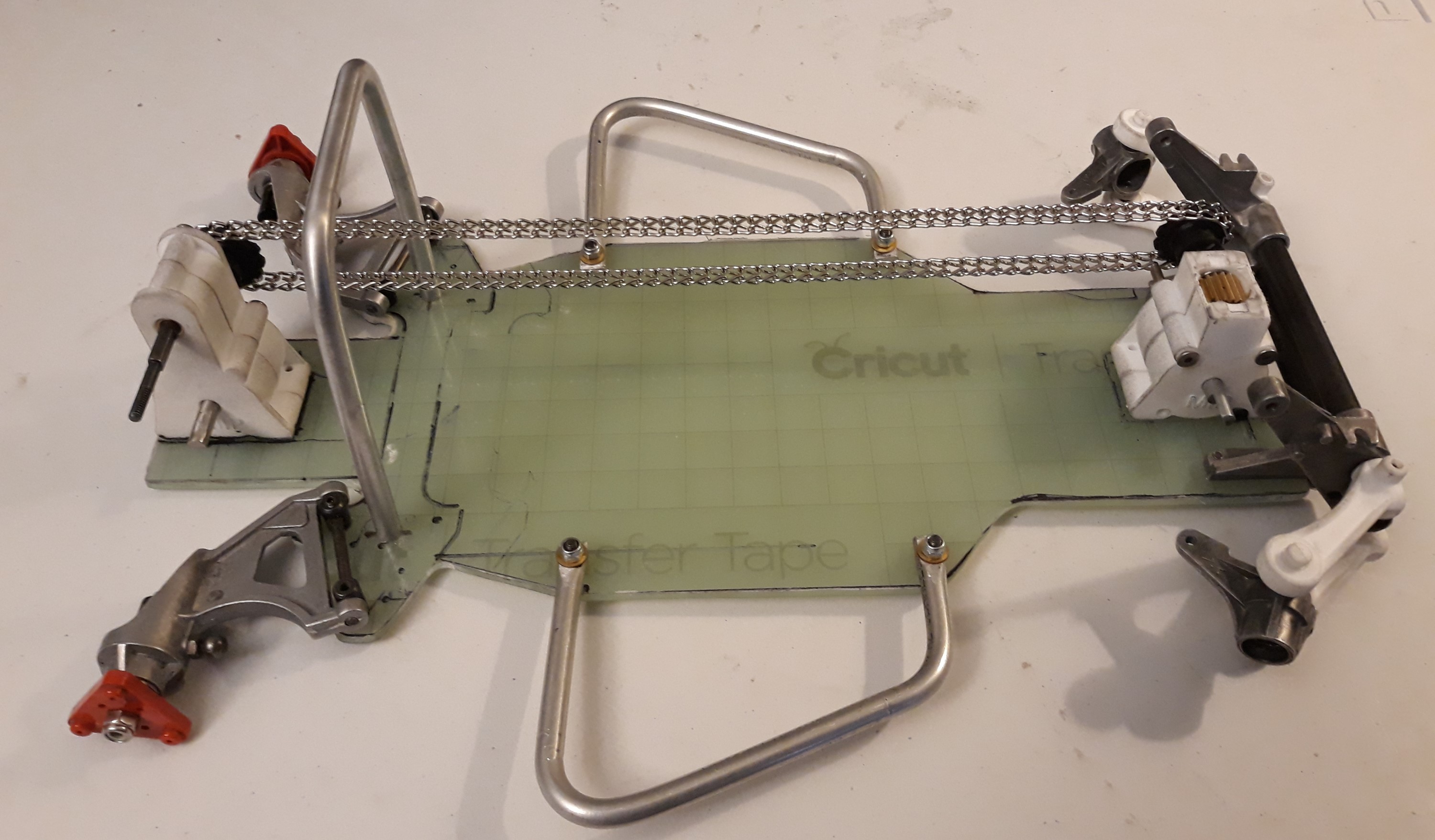

Can you show the gears combination for reference? Where are the gears come from? ThanksAscotConversion wrote: ↑Sat Aug 22, 2020 9:41 pm srb_rollbar.jpg

Gears are :
Rear:
topshaft- STRC B4 slipper shaft - https://www.amainhobbies.com/st-racing-concepts-cnc-machined-transmission-layshaft-sptst3793ae/p185515 - and this gear (which needs to be slotted to fit the shaft) - https://www.ebay.com/itm/Brass-Gear-tamiya-sand-scorcher-SRB-rough-rider-fighting-buggy-champ-super-champ/141736106916 -
idler - standard SRB topshaft
Bottom Tamiya SRB/Sand Scorcher ball diff
front:
Pulleys are from the Kyosho Blizzard - B plastic parts set https://www.amainhobbies.com/kyosho-b-plastic-parts-set-kyobl7/p221429
Rear:
front:

Just got some more aluminum tube to finish the cage. Unfortunately, remodeling my kitchen keeps getting in the way.
I also ground down the Optima front knuckles, as they are taller than SRB knuckles, and take away a little front end travel in stock form.
