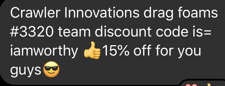

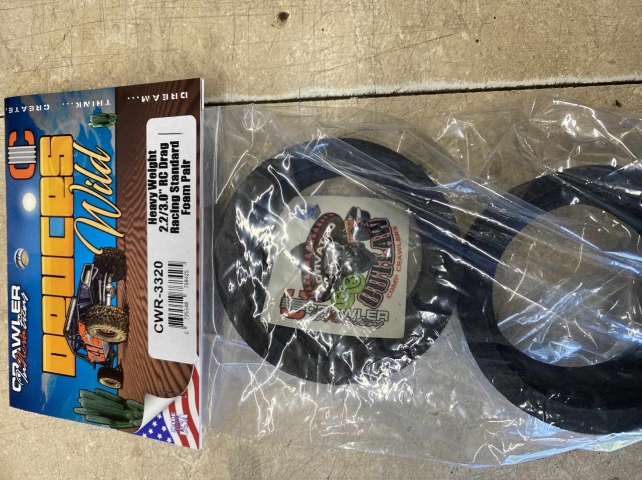

I just got my 6 sets of the new crawler innovations foams. There is a coupon code that saves you a bit btw. Probably don’t share that too much cause I think it was just for or group hehe. One thing I found out is even though the wheels are vented with the new foams the tires will hold air like crazy. You need to jam a Allen wrench or similar through the foam. Crazy stuff lol.

Do the CI foams cut down on the tire expansion as well as the bands? It seems like we're all trying to get the same result, but I've seen a bunch of different ways to get there. I tried a ring of gorilla tape around my foams. I was very exact about being doing it, but in end, it took a ton of weight to balance the tires and they didn't expand evenly, so I scrapped the idea.

I will let you know soon haha. The few locals that have ran the foams love em, but they expand the same in the air as regular foams at least for me. I have a few sets set up with bands and a few with the CI foams, hope to make some hits tomorrow and see what’s up.
I have never had luck taping the tire or the foam. It always ends up bunched up one way or another. Impossible to wrap them them identically. I will stick with bands myself unless these foams rock. One thing a couple of our guys do is add baby powder between the foam and the tire to allow it to find it’s happy place without sticking. I totally forgot to do mine lol.
