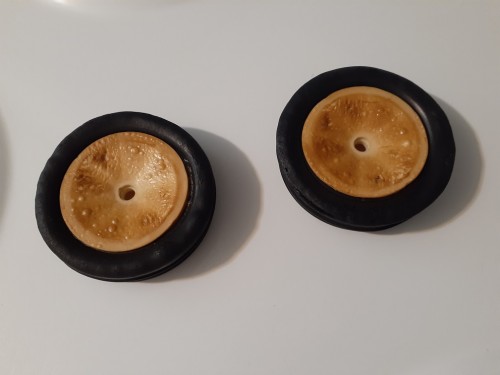

I use acetone (fumes)to unglue tires all the time and it works great. So I thaught I would try something new and use the oven method. Heat oven to 300 degrees Turn It Off and put the tires in and check every 5 minutes to see if the glue and tire will separate. Only I didn't turn the oven to off. I turned it to broil witch is next to off. The results are not pretty and the house smells like one giant burnout.

Now you know how to make them look even more vintage! :D

Ohh that’s gonna leave a smell. Just used the oven bake method to rescue a set of proline Road Hawgs from some mis matched wheels. I baked them at 375 for 20 minutes

I've also read about boiling the wheels in water.
Seems to be the safer method to me.

I just use CA debonder. Not really cheap and kinda tedious but it works.
