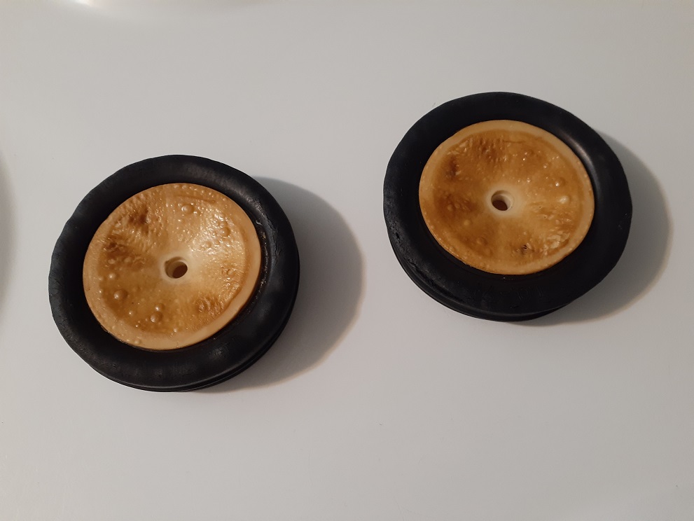

I use acetone (fumes)to unglue tires all the time and it works great. So I thaught I would try something new and use the oven method. Heat oven to 300 degrees Turn It Off and put the tires in and check every 5 minutes to see if the glue and tire will separate. Only I didn't turn the oven to off. I turned it to broil witch is next to off. The results are not pretty and the house smells like one giant burnout.

Ohh that’s gonna leave a smell. Just used the oven bake method to rescue a set of proline Road Hawgs from some mis matched wheels. I baked them at 375 for 20 minutes

I've also read about boiling the wheels in water.
Seems to be the safer method to me.

I just use CA debonder. Not really cheap and kinda tedious but it works.
