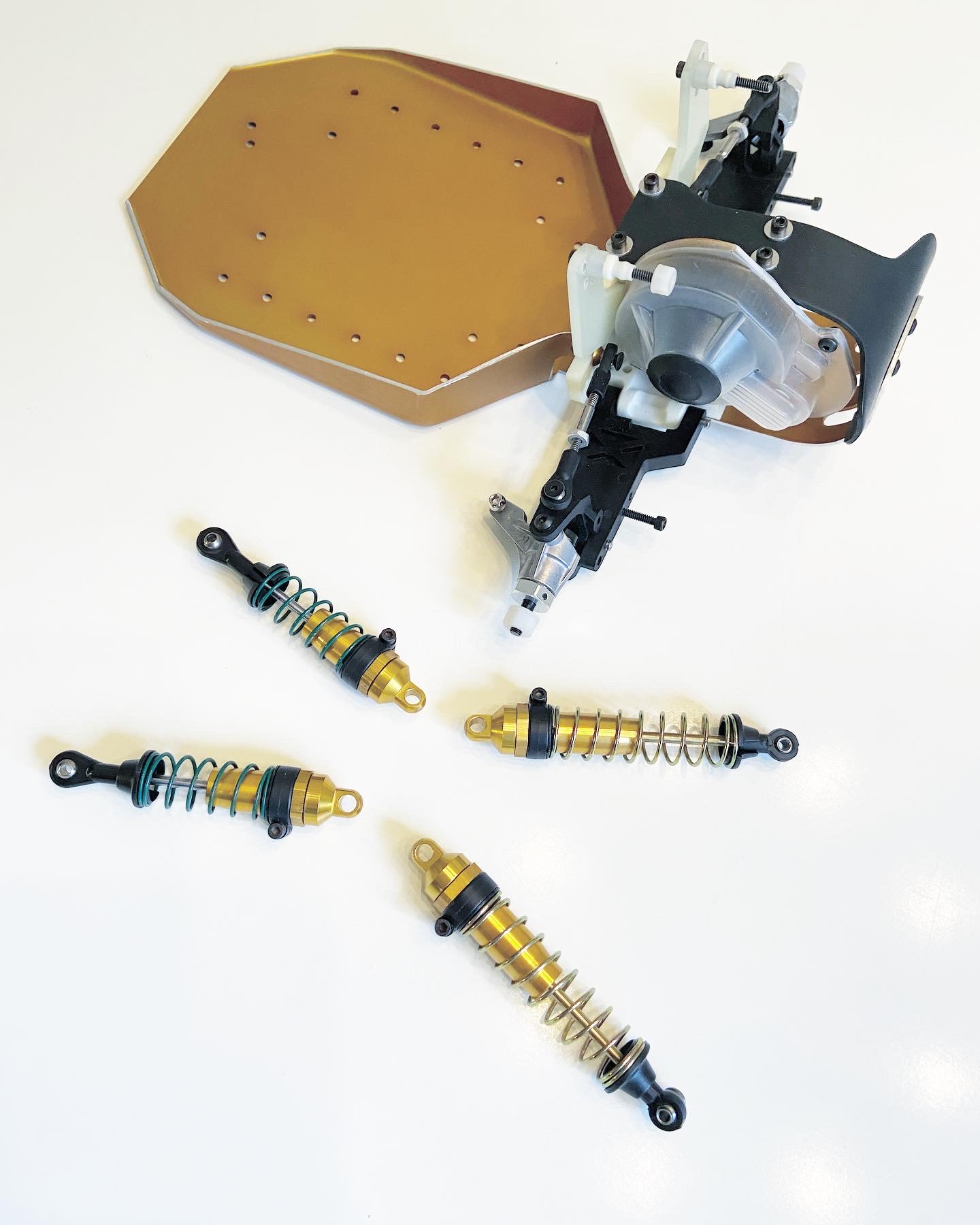

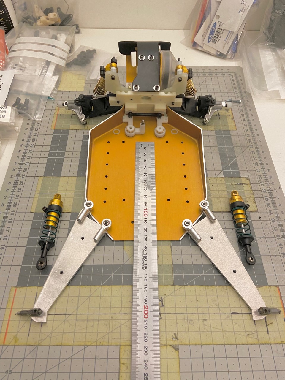

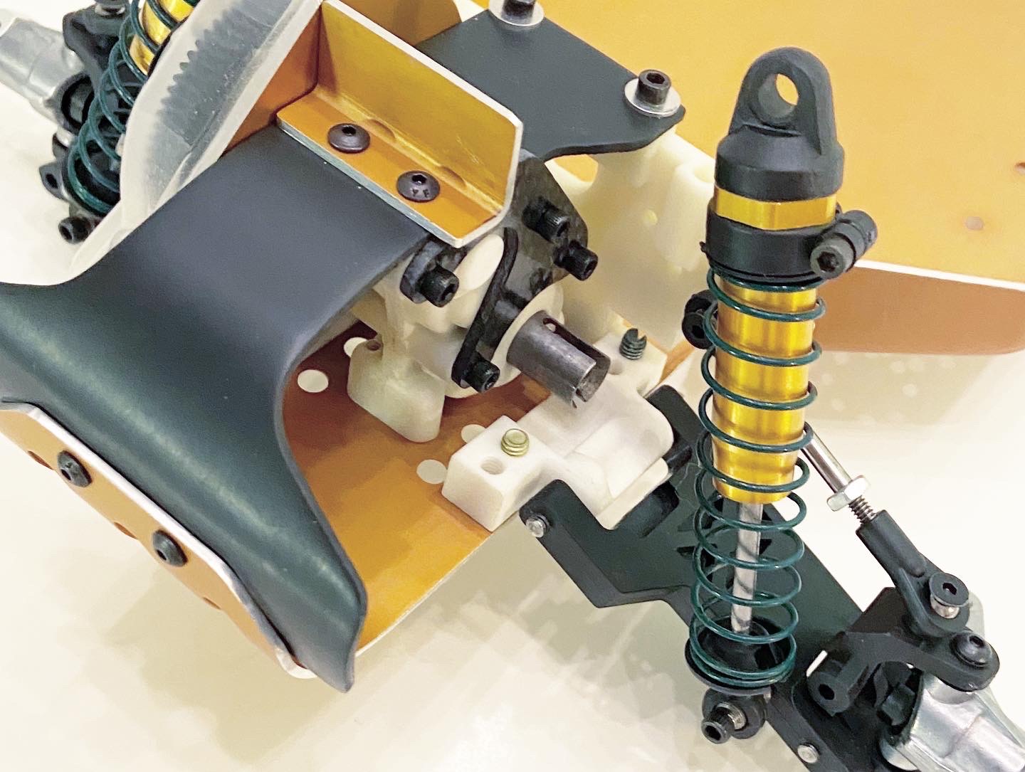

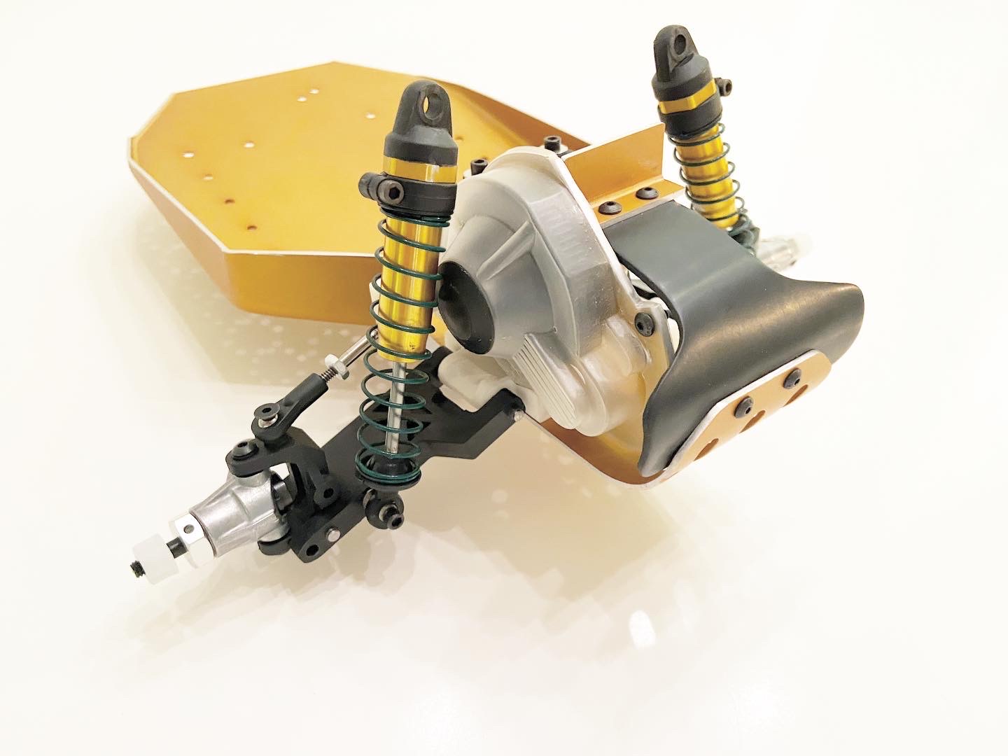

Fabricated the front shock tower (Probably not the final version) Decided to move it rearward so it could bolt on the bulkhead.
On the pic it’s 1.32” rear shocks, but will have to source 1.02” as these are way too long!!
Asso_man!
Posts: 3960
Location: EU
Has thanked: 40 times
Been thanked: 82 times
Re: RC10 FF
Post by Asso_man! »
You could use a taller shock tower and play with inner spacers for the right suspension travel?

sandkil
Posts: 1082
Location: Stockholm Sweden
Has thanked: 795 times
Been thanked: 623 times
Re: RC10 FF
Post by sandkil »
Asso_man! wrote: Fri Oct 16, 2020 5:00 am You could use a taller shock tower and play with inner spacers for the right suspension travel?
Yeah, that might be the way to go in the end if nothing else.
I just wanted to have as low fron end as possible. The body will sit behind the bulkhead and I think it will look even more weird with tall shocks and towers.

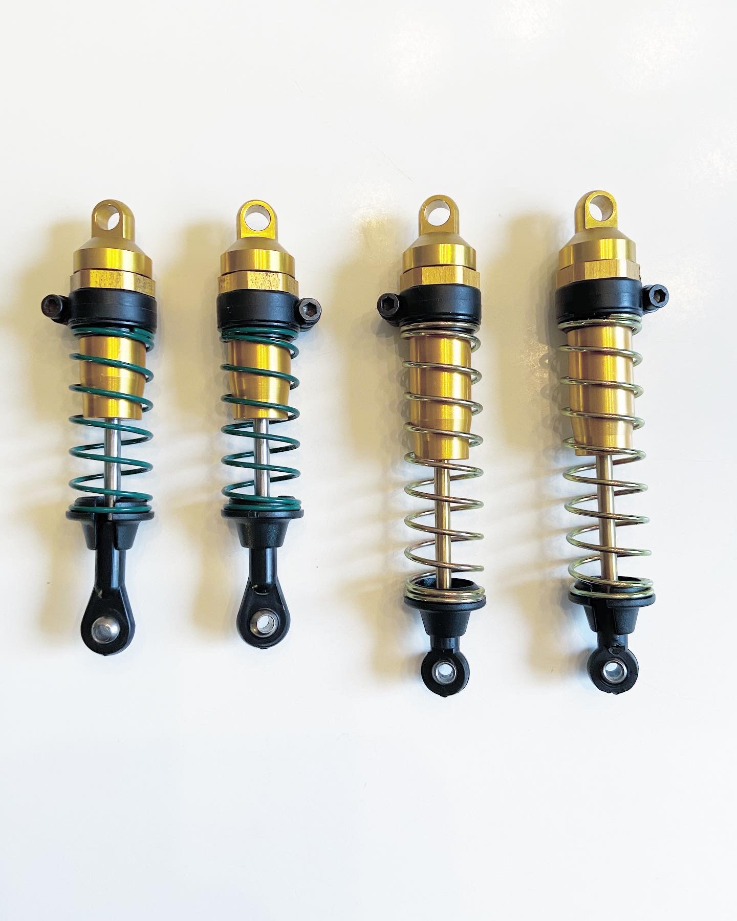

Shocks done. Just need to add oil 😀
At the front I’m going for 1.02 shocks and 0.71 at the rear with Du-Bro ball ends to clear the trailing arms.
All shocks have RPM spring cups for clearance and no internal limiters. Oil will initially be 35wt.

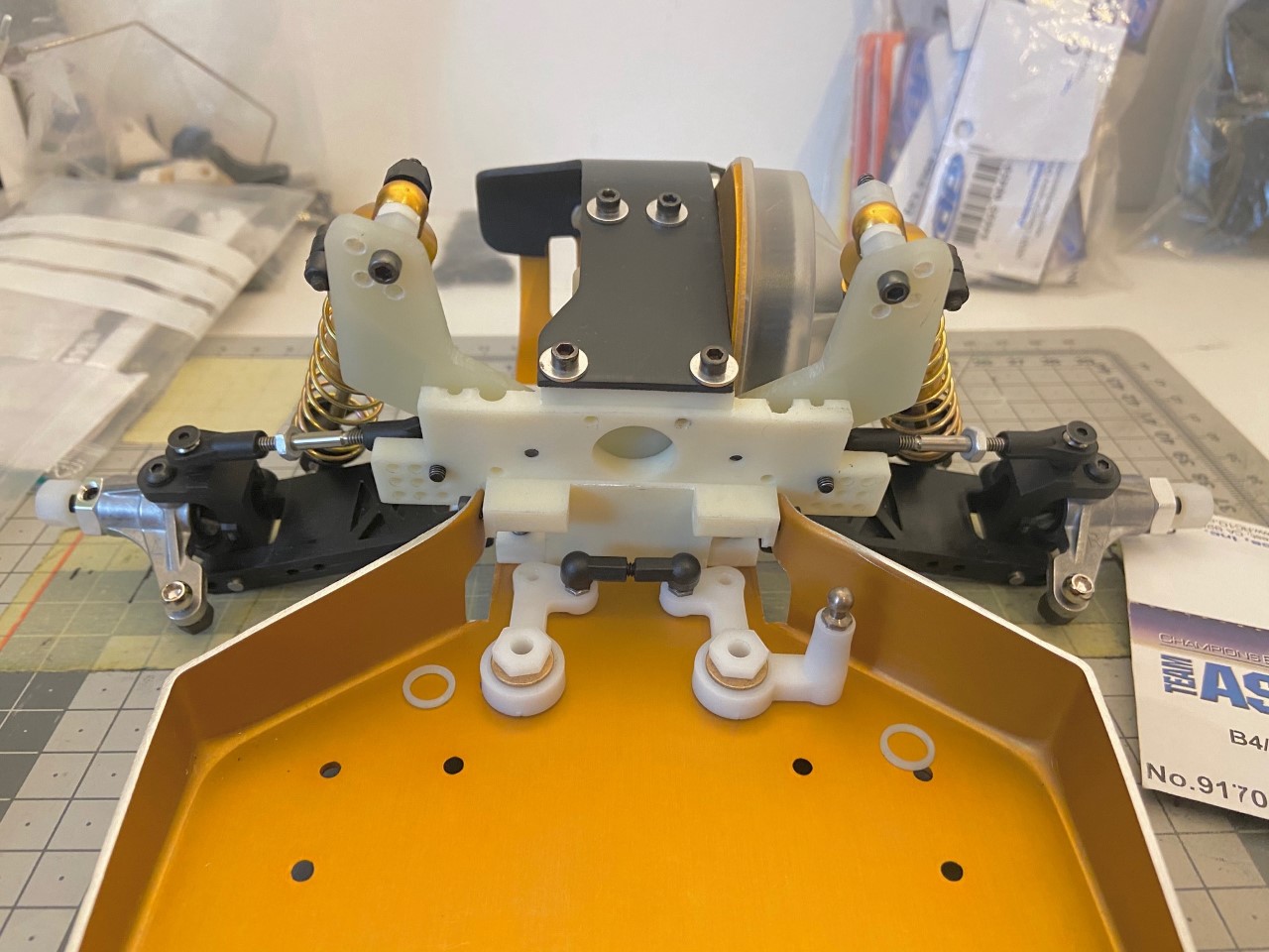

My brain is hurting...
Need your help on steering set up (only mockup at the moment).
I think shorty Lipo is the only option..
With trailing arms you get different movement depending where the inner ball joints is located on the chassis.
There will be a top deck with spacers on rear arm mounts.
Any input on this geometry is greatly appreciated.
Sorry for messy pic.
Posts: 12335
Been thanked: 3917 times
Re: RC10 FF
If it were mine...assuming it would clear, I would swap bellcranks leaving the "input" side on the right. Servo can then mount alongside the pack like the original prototype RC10.
sandkil
Posts: 1082
Re: RC10 FF
Post by sandkil »
GoMachV wrote: Thu Oct 29, 2020 12:53 pm If it were mine...assuming it would clear, I would swap bellcranks leaving the "input" side on the right. Servo can then mount alongside the pack like the original prototype RC10.
That’s a good idea. Thank you.
With the B4 servo link it will clear. I will have to widen the openings in the pan for maximum steering throw, but that was something I knew from the beginning.
