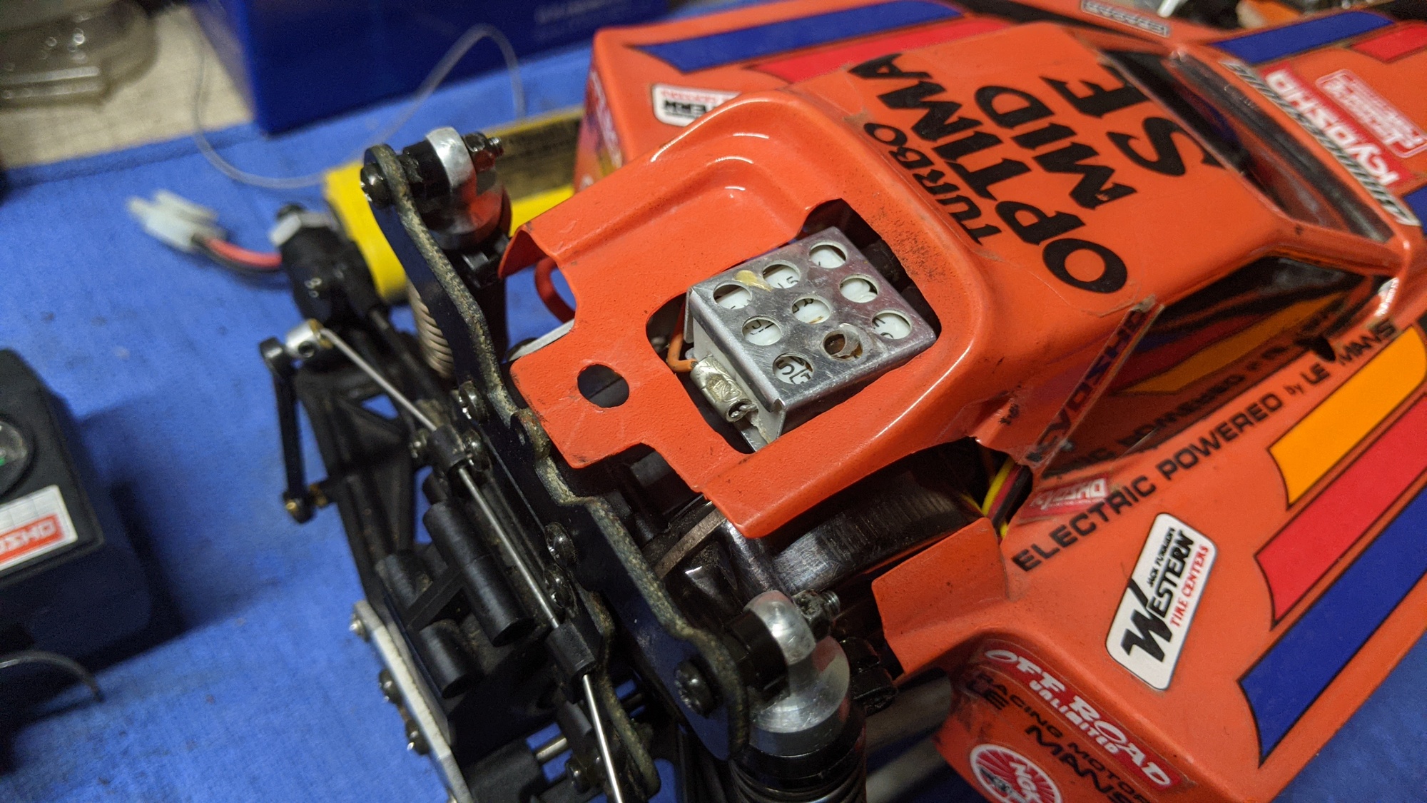

When I put the body on the front body mount the rear is 1/2" or so short of reaching the rear body mount. I'll take a picture when I get a chance. I can get one or the other. Not both. Is it supposed to reach both?

When sitting correctly on the front the rear sits here. :(
Coelacanth
Posts: 7421
Location: Alberta, Canada
Re: Turbo Optima Mid SE Front Hub Question.
Post by Coelacanth »
It looks like the previous owner incorrectly installed the rear shock tower to the back of the rear bulkhead instead of the front. Put it on correctly and your body should fit again. :) Here's a modded but correct assembly for comparison:
Post by LosiRacer1 »
Hahahaha.
Ahhhhh I suppose that would do it!!! Thanks!
