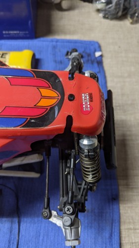

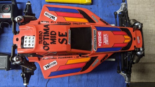

When I put the body on the front body mount the rear is 1/2" or so short of reaching the rear body mount. I'll take a picture when I get a chance. I can get one or the other. Not both. Is it supposed to reach both?

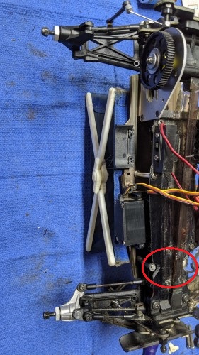

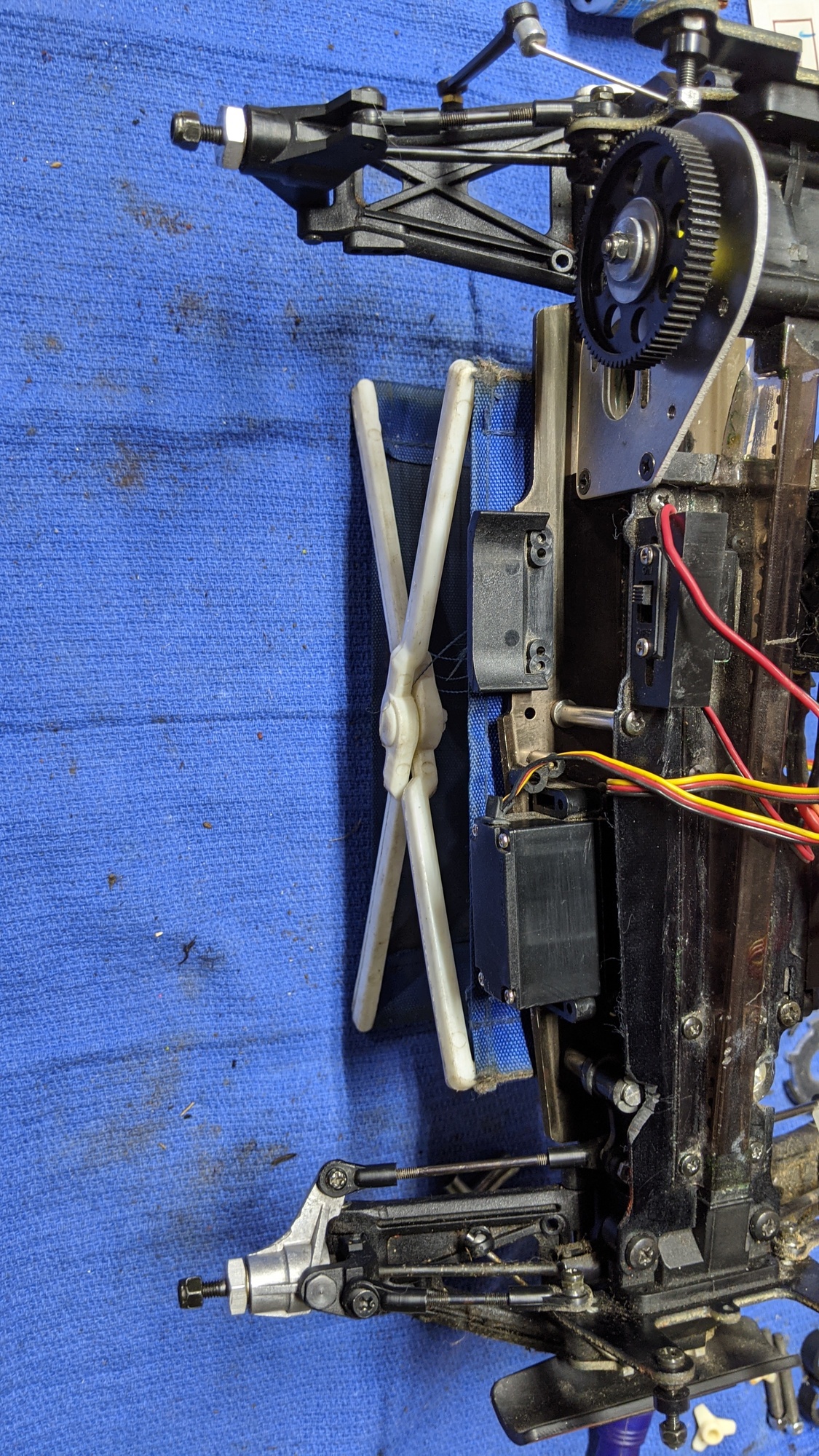

Paolino70
Posts: 16
Joined: Sat Jan 02, 2021 6:08 am
Location: Prato-Tuscany-Italy
Has thanked: 26 times
Been thanked: 11 times
Re: Turbo Optima Mid SE Front Hub Question.
Post by Paolino70 »
I would be curious to see a photo from above without bodywork and a photo of the chassis taken from below ....
Post by Paolino70 »
what happened to the upper frame?

Paolino70 wrote: Sat Jan 02, 2021 4:15 pm what happened to the upper frame?
Got me, came to me that way.

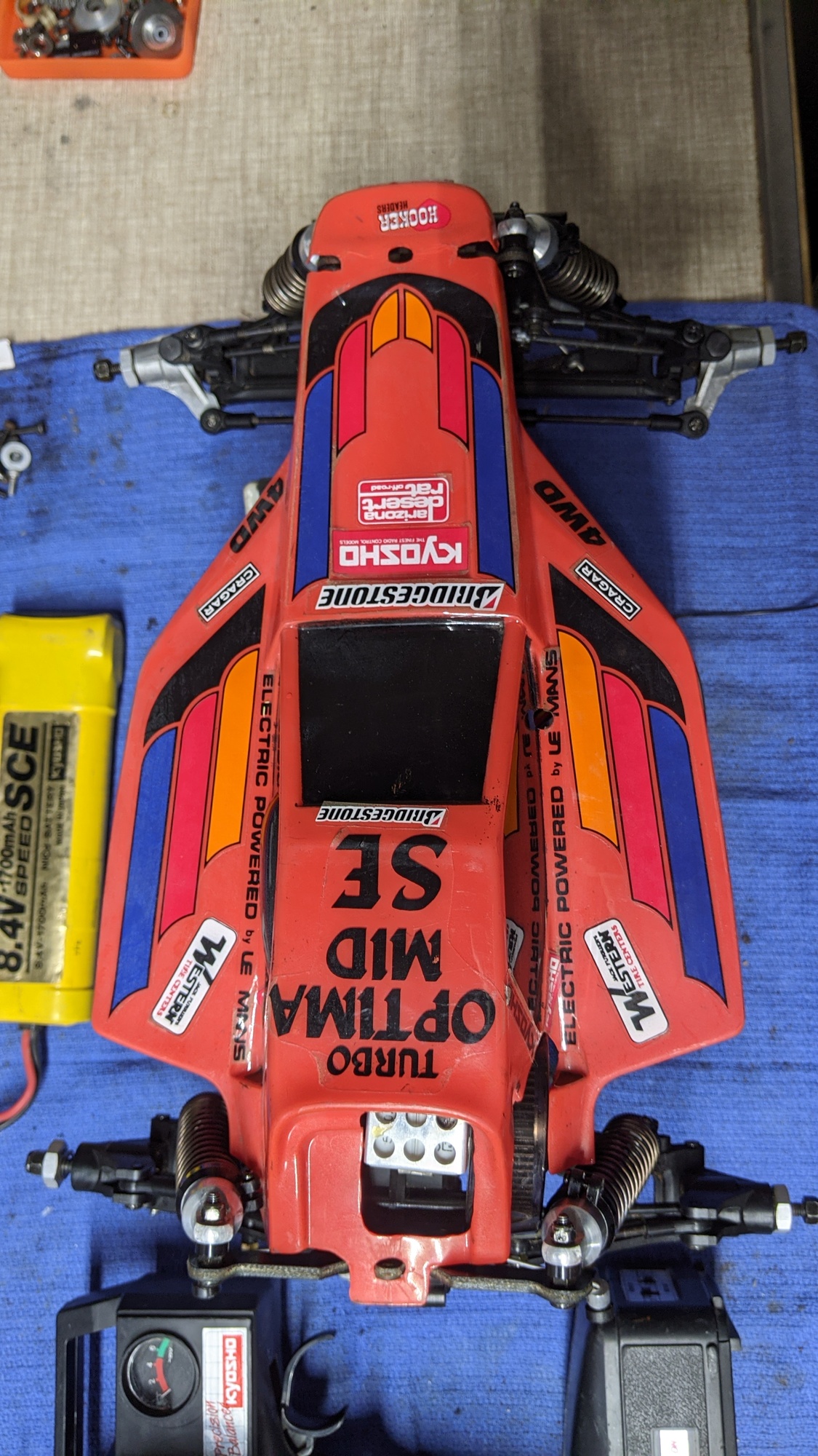

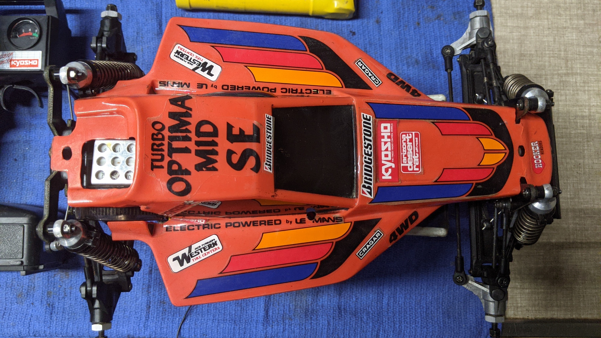

When sitting correctly on the front the rear sits here. :(
Coelacanth
Posts: 7421
Location: Alberta, Canada
Post by Coelacanth »
It looks like the previous owner incorrectly installed the rear shock tower to the back of the rear bulkhead instead of the front. Put it on correctly and your body should fit again. :) Here's a modded but correct assembly for comparison:
