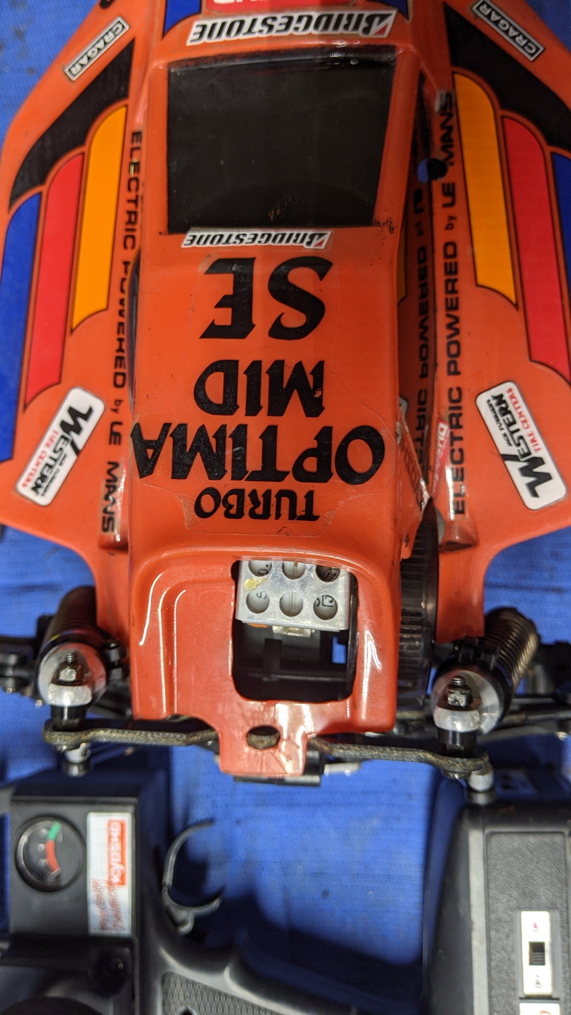

Thanks for the info guys. 2nd question. This is my first Optima I've ever messed around with. The body that came with it, seems to be too short for the chassis? Am I an idiot (distinct possibility :lol: ) ? Or does that back hole in the body not go to the rear shock tower?
Wrong body for the car?

When I put the body on the front body mount the rear is 1/2" or so short of reaching the rear body mount. I'll take a picture when I get a chance. I can get one or the other. Not both. Is it supposed to reach both?

I would be curious to see a photo from above without bodywork and a photo of the chassis taken from below ....

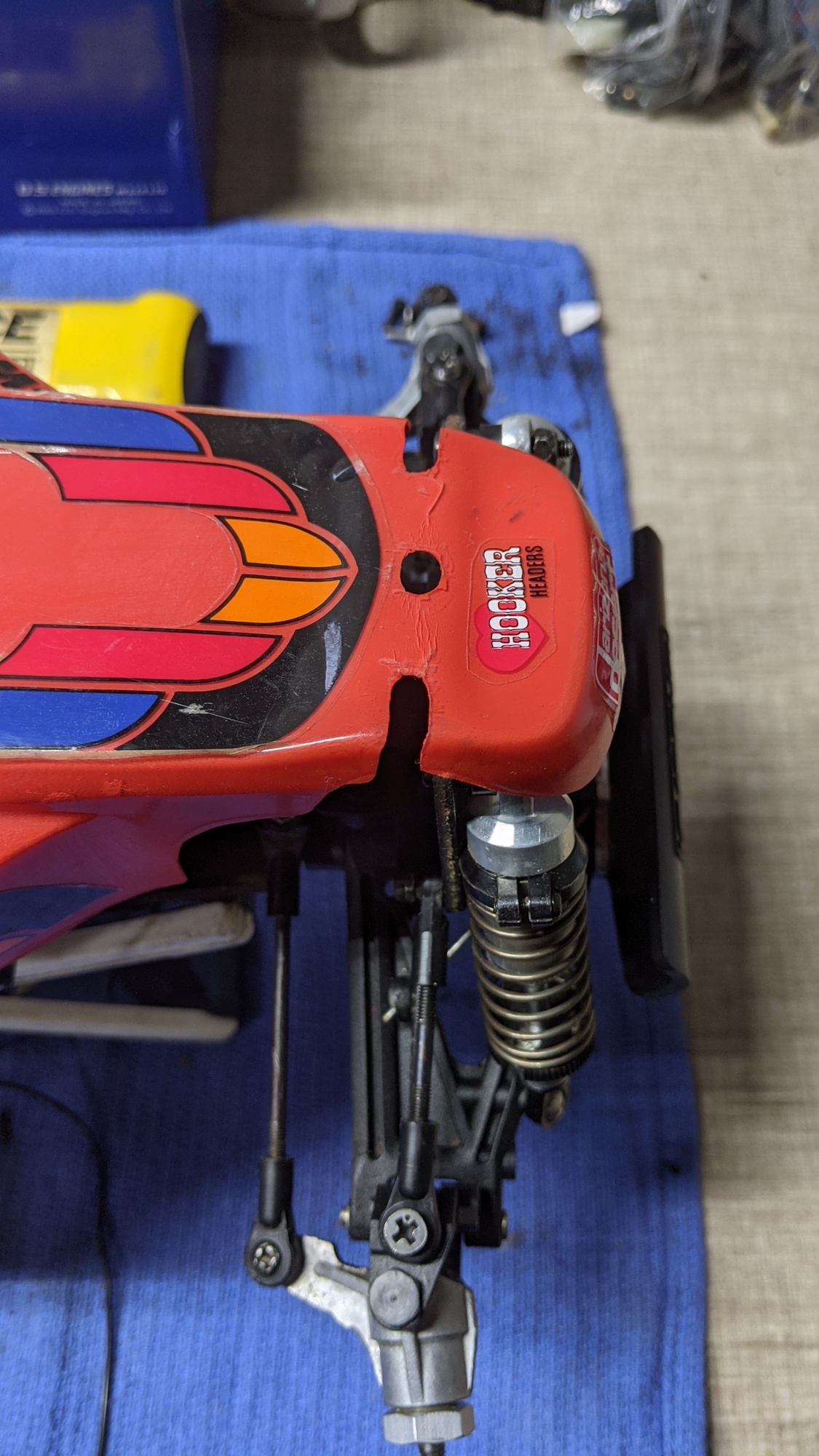

When sitting correctly on the front the rear sits here. :(

It looks like the previous owner incorrectly installed the rear shock tower to the back of the rear bulkhead instead of the front. Put it on correctly and your body should fit again. :) Here's a modded but correct assembly for comparison:

Ahhhhh I suppose that would do it!!! Thanks!
