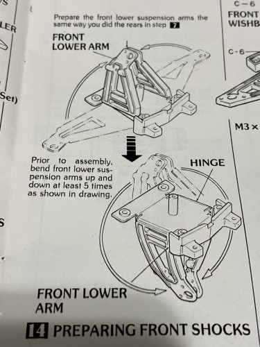

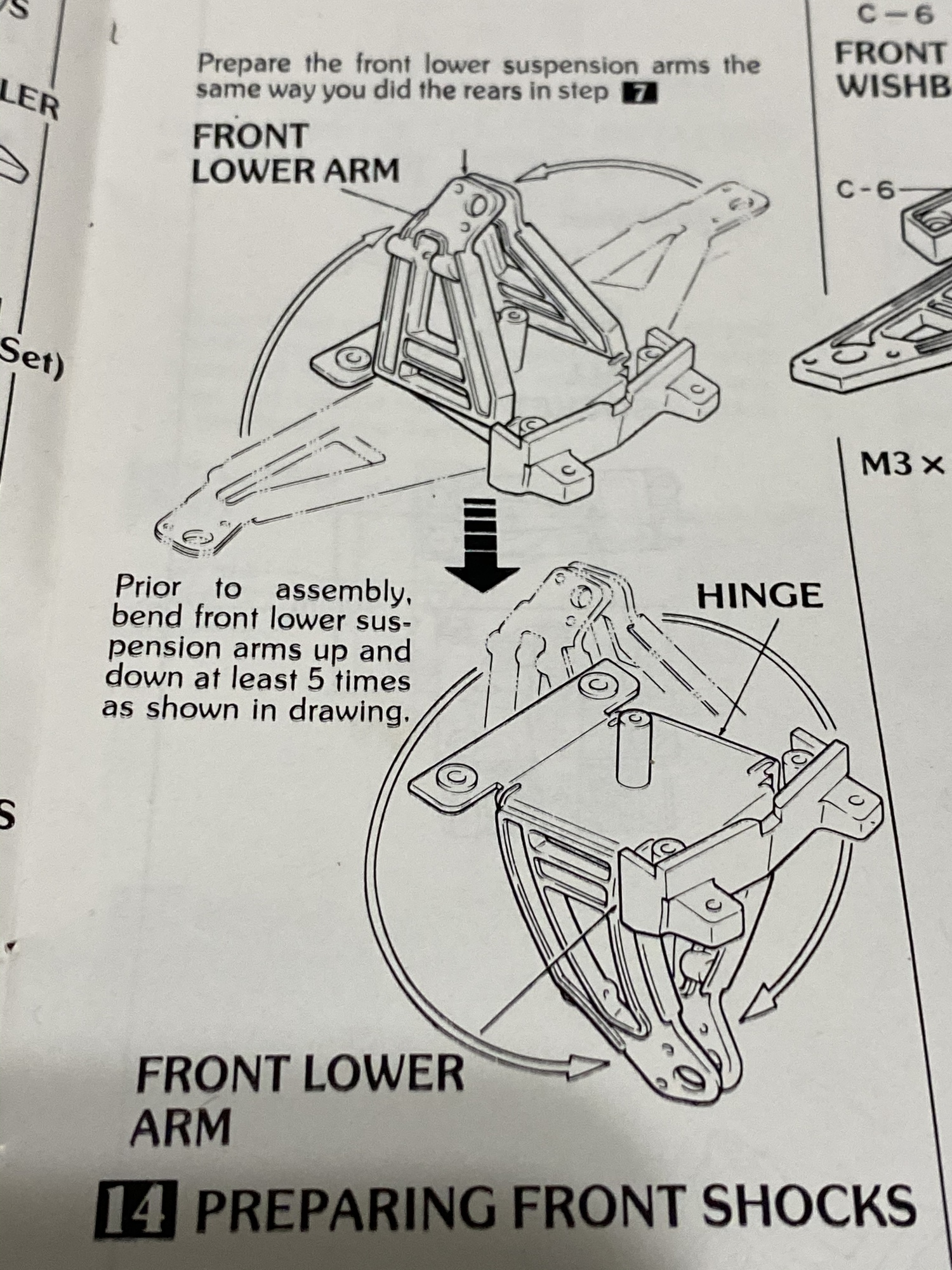

The double wishbone front suspension is made up of flexible plastic arms: there is no axle.
Suspension clearance is repaired with an o-ring.

If you haven’t seen a Pegasus or Icarus up close you are missing out. Really interesting design. The front and rear suspensions have no real pivots. The plastic is used as a flex hinge. The super narrow front tires give it a really unique look. They are an iconic buggy for sure. Very nice work on the restoration!

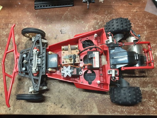

I still have my Cox Bandido, yet another variation of this chassis. Even though they are from the mid 80's, I picked mine up on clearance in the early 90's.
I chose to keep the msc in mine as I don't really have much intention on running it. It also still has the original (slightly worn) tires. It currently still has the original body, paint, and decals (poorly executed by a 14 year old), but I'm thinking that a new TBG body and MCI decals might be in order.
