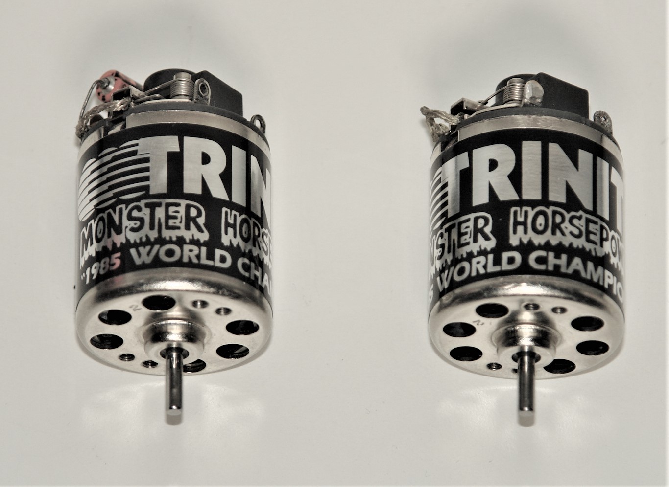

coxbros1 wrote: Mon Mar 08, 2021 1:59 pm Man Chuck that is amazing! I know your opinion of Kyoshos back at "Right Stuff Hobbies" in the late 80's weren't that great.....but your about to find out 80s Kyosho's are as good as anything....if not better! Wait till you get the Le Mans bug in you :lol:
Derek
I am almost beginning to get the impression that you like the LeMans motors.
Here is what my experience was from BITD.
I almost exclusively ran Trinity Monster Horsepower 1985WC motors. I only ran stock motors, never taken apart, never ball bearings, no twisting the can for timing. Experimented with all brush and spring combos.
Every heat, every race, clean as a whistle. Submerged in carbon tetrachloride and spun. Com cleaned with a com brush, oiled and comm drops.
Sure I probably spent way more time on my trans and bearings than almost everyone else. Flushed the trans with WD40 every race.
But I don't ever remember ever being out-motored by any other stock motor. Out driven, out cornered almost every race.
When I raced carpet occasionally ran Twister.
Just my 2 cents. No offence to Kyosho, the LeMans motors are pretty.
So in my world Trinity Rules :lol: :lol: :lol:

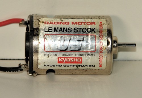

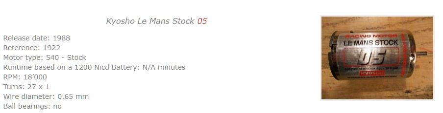

Chuck, Kyosho Le Mans never made a 27t stock motor. They did have 2 Super stock motors with 20 and 34 degree fixed timing , closed endbell, bushings....but that wasnt stock.

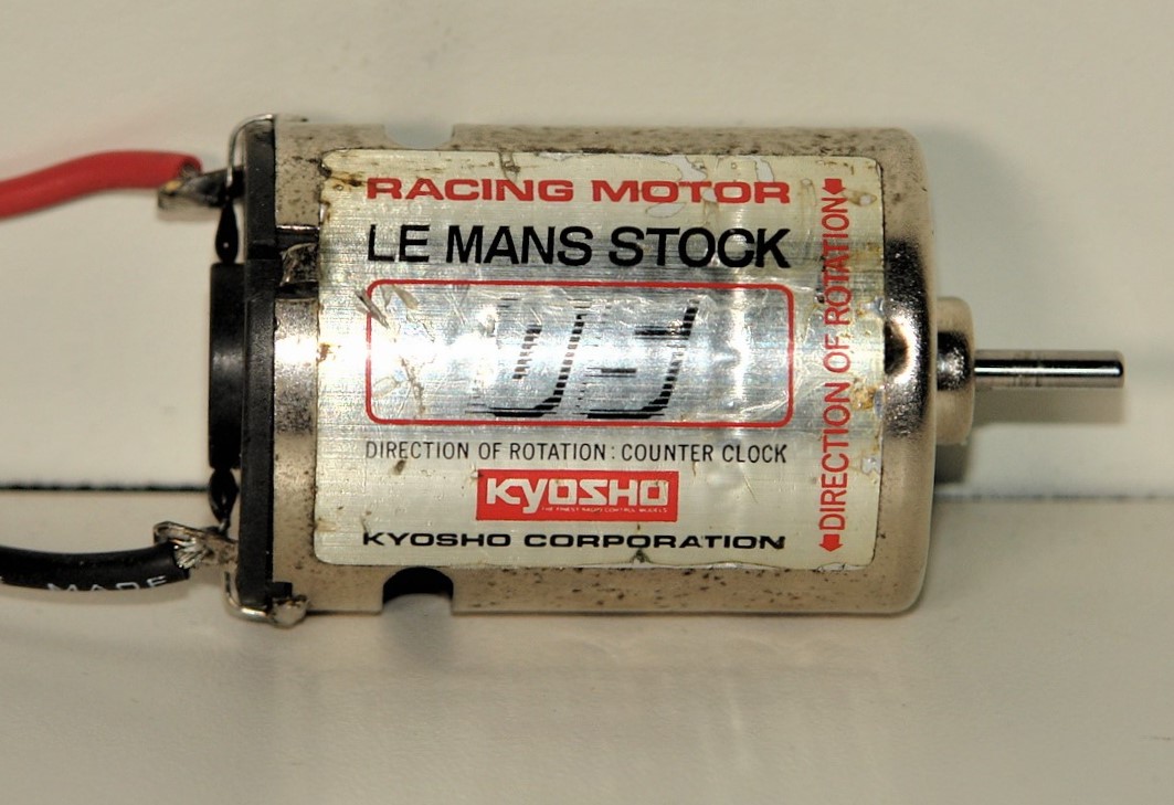

coxbros1 wrote: Mon Mar 08, 2021 3:51 pm Chuck, Kyosho Le Mans never made a 27t stock motor. They did have 2 Super stock motors with 20 and 34 degree fixed timing , closed endbell, bushings....but that wasnt stock.
Ok you got me....
I will admit to owning more than one Kyosho motor. But only under the most dire circumstances. Please don't let any one else know!
I do also own a LeMans stock "05" motor. Not exactly the pride of a collection.
Curious.
So what did Kyosho team drivers run in ROAR stock races?
Was it really the 05 motor??

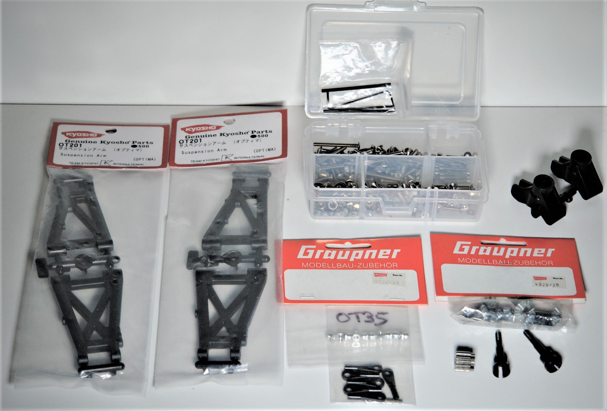

A few replacement parts have made it.
More parts on the way.

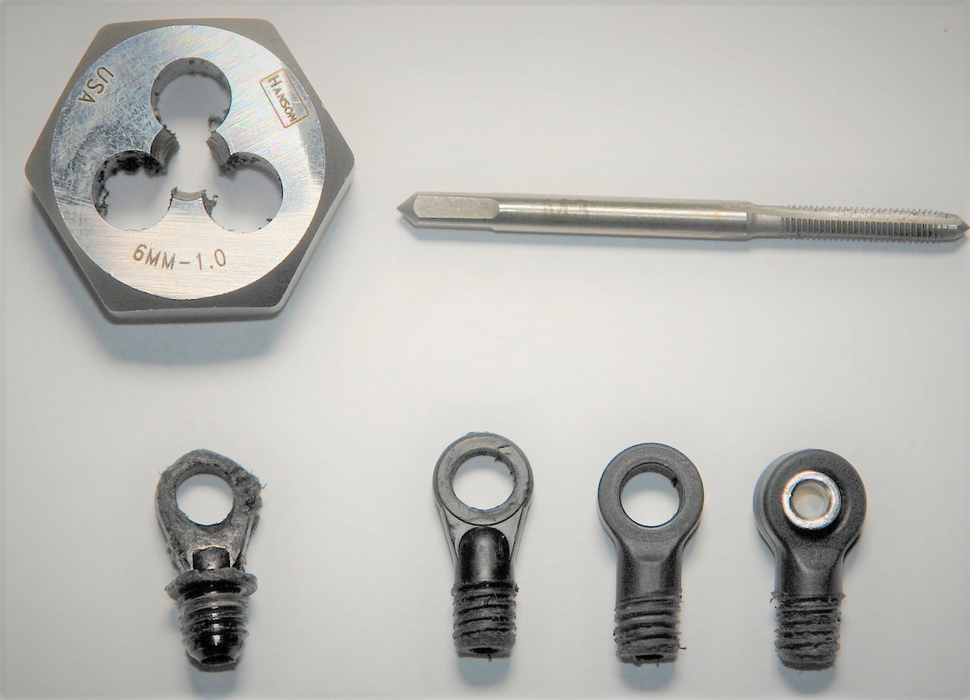

3 of the shock ends that were on the car are pretty torn up and one was missing altogether.
I've been trying to replicate the elusive ADj-1 lower shock mount.
At least without paying $40 plus for 4 new ones. May have to go that route, but for now I'll try to mod some ends.
First attempt, not so good. Nylon ends just don't thread very good.
The original end is on the left, my 3 feeble attempts are on the right.
Cheaper plastic ends on their way.

Maybe not so feeble. I think the external threads are not visible once the shock is fully assembled. As such, I can see no reason that the 3 you've made won't work.
I understand that Kyosho isn't making these but 10 bucks per end seems utterly ridiculous.

I'm not a fan of those open ball-ends. On all of my builds, I've replaced most of those with 4.8 mm ball studs and ball cups. There's less slop and I figure less dirt will get into the joint when it's a cup instead of an open end. The only place I kept the open-ended ball-ends is for the Optima's steering servo and inner tie-rod ends because there's very little clearance there and they need to be as flat as possible...and for the stabilizer upper ball-ends because the stabilizer wires have to go through the ball-end holes.
Is it possible to do this with the Platinums? I have a full set in a Ziploc bag, I might have to take a closer look...if it's not possible to swap those bottom shock-ends with something more generic, it would give me yet another reason to dislike the Platinum shock design. :x
