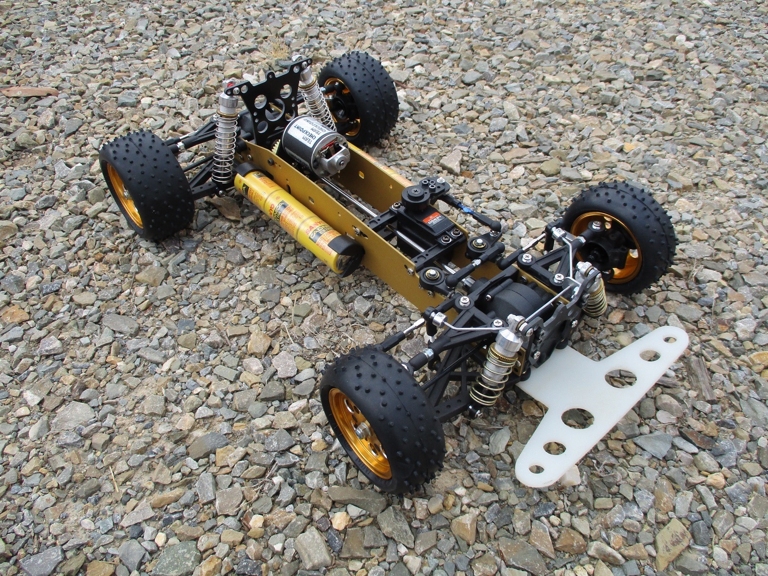

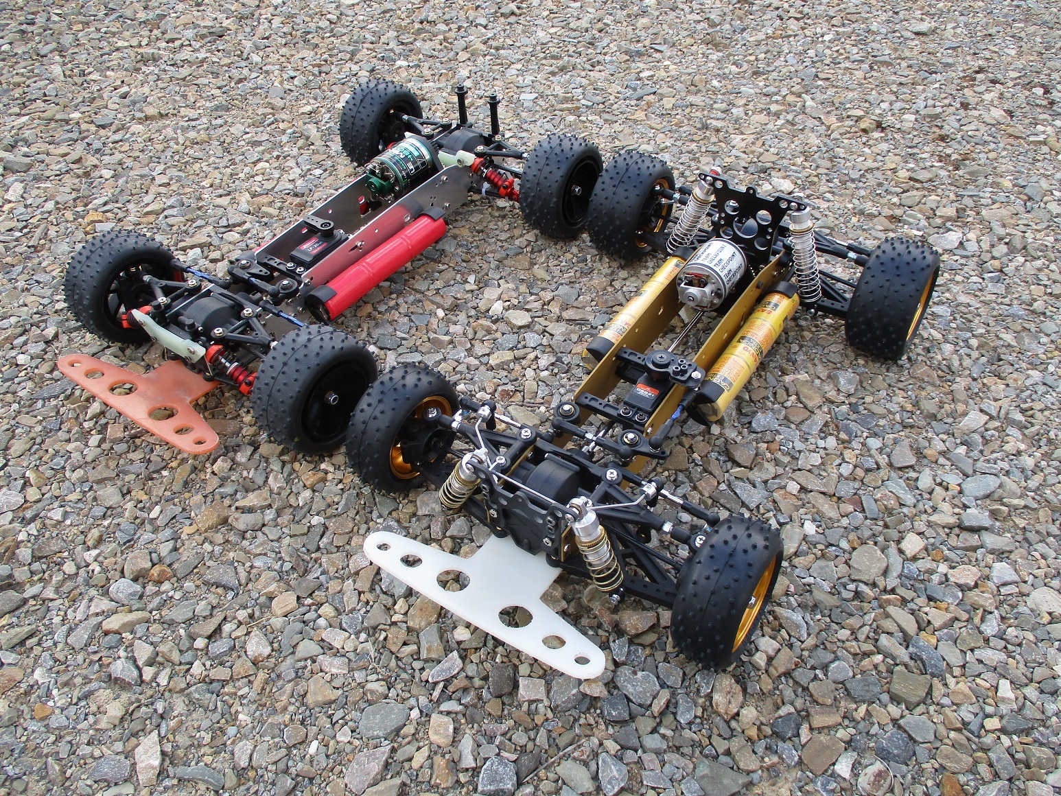

I picked up an optional TAG sway bar amongst a mixed lot of parts from a bloke in Italy. It cleaned up nicely as did the alloy ball ends. No mounts to attach it to the front shock tower were in the parts lot. A quick think and some scrap angle aluminium later and it was attached.
The 1700SCE Sanyo batteries and the steering rods are in.
Here's an evolutionary shot from Coyote to Pro 10. The shock mounts, shocks and front bumper are not Coyote items.Chris.
Toys.............they are!

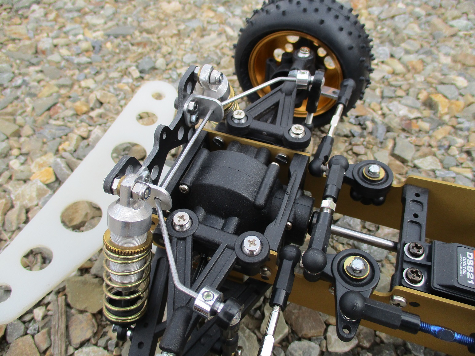

It's looking really special ! I noticed you have the steering configured differently on the two cars , do you know what the stock configuration is ?

Thanks. The stock configuration is in the Coyote. I copied Umberto Pernice's steering setup from his '87 World's Coyote in the Pro 10.
I can't believe you missed the Le Mans motor in the Coyote! I know why. It's not a 480 Gold.

I admit i was working when i looked the 1st time....now i zoomed it in i see it! (I feel stupid)....and the kyosho red shocks!
480t is classic but a 480gold speaks for itself....just ask Coel I really like the Coyote too...both those cars with the perpendicular mounted motor and torpedo cells just RULE!

I just seen it the 480t too! Classic. Great cars!

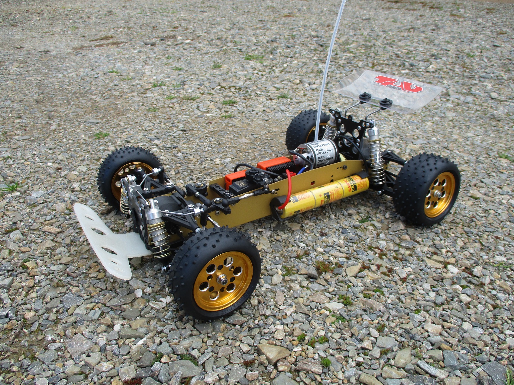

Re: TAG Pro 10

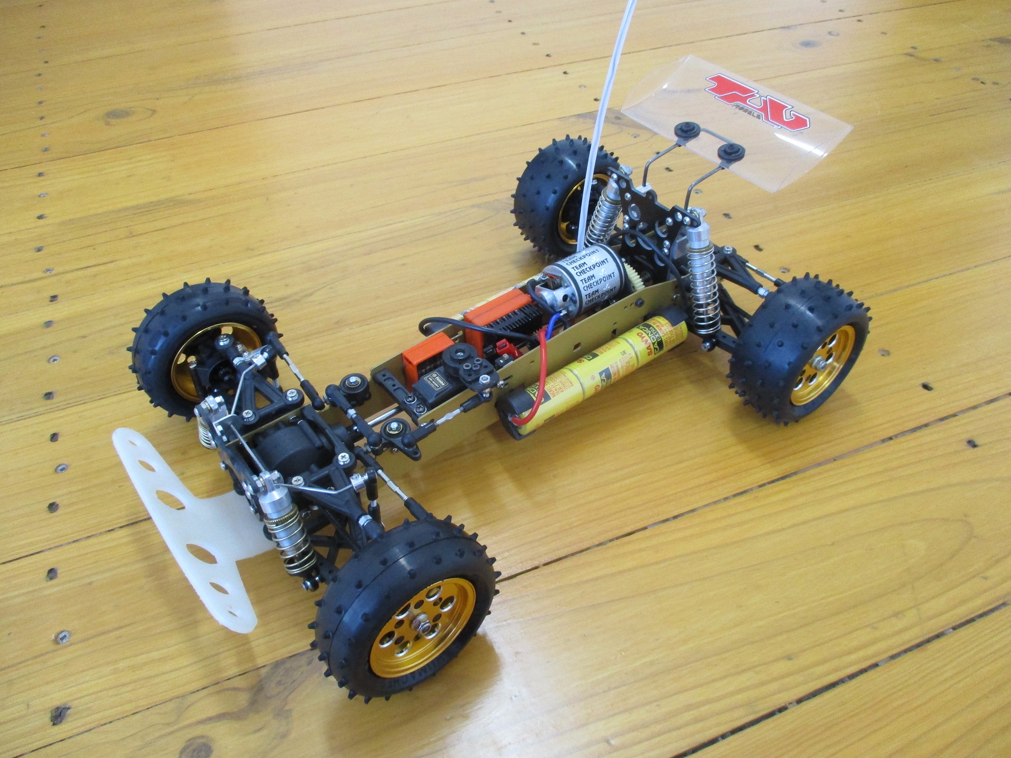

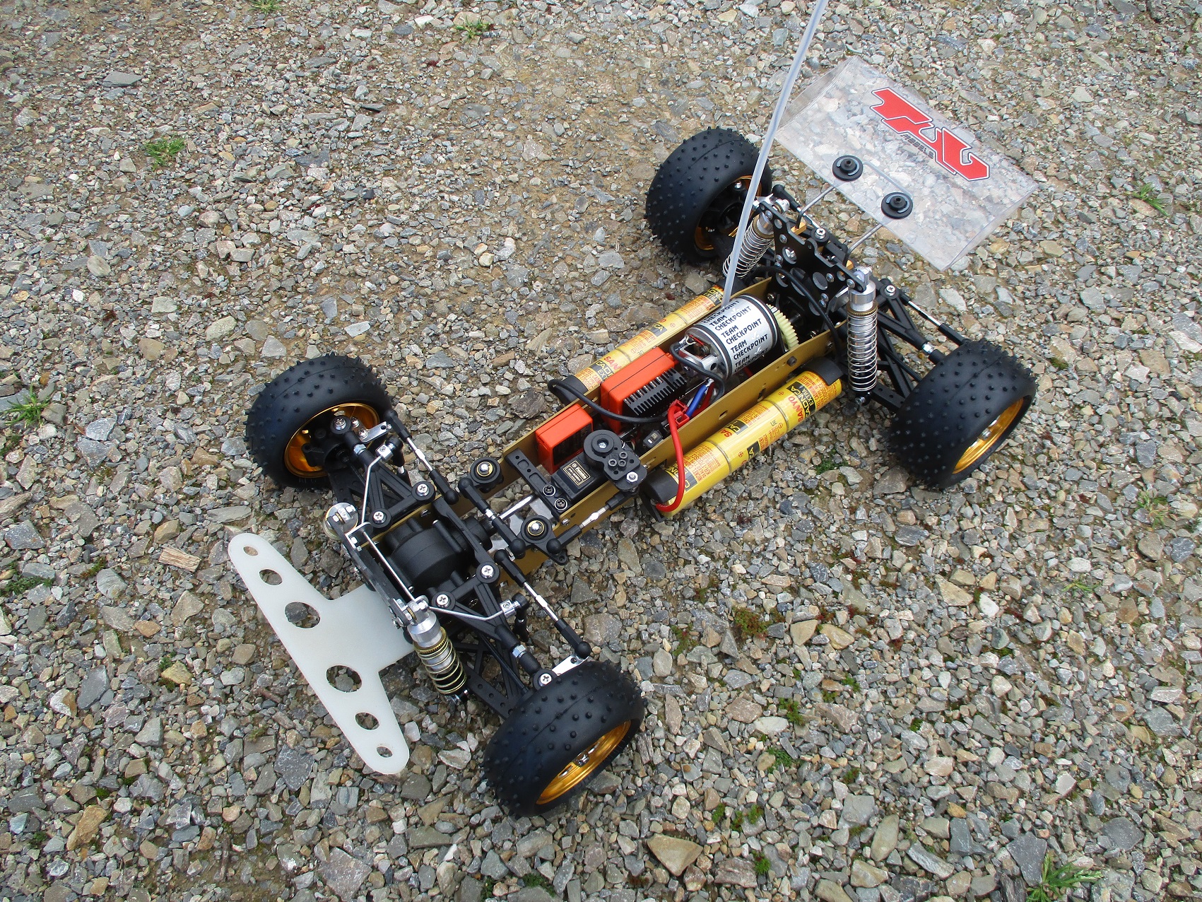

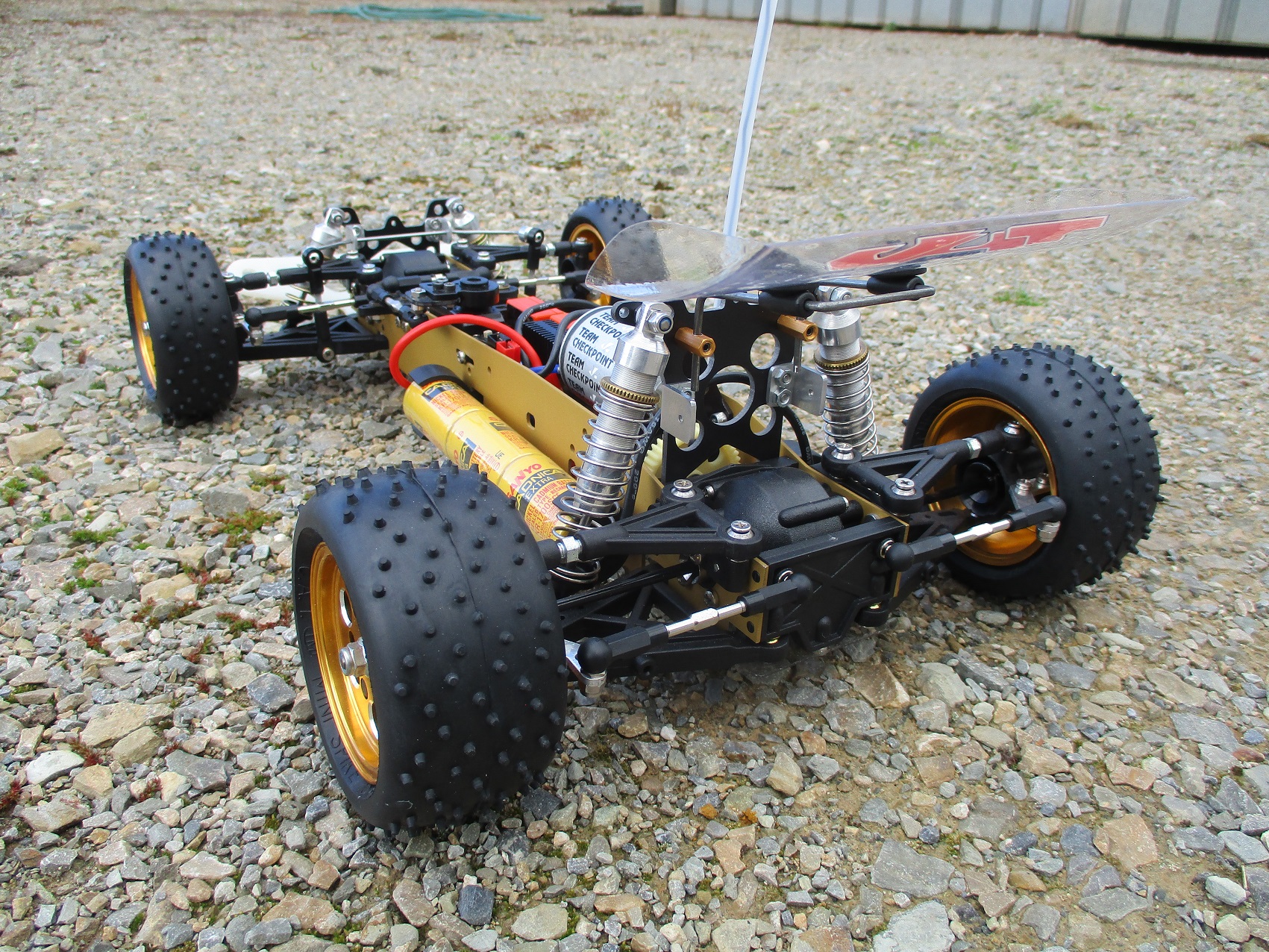

All done apart from a pinion and body. Lots of period correct electronics in it now and all wired up for some heavy shelf action.
The wing's a heavily chopped Schumacher Cat XLS re-release. The wing posts are cross drilled PCB standoffs. As a bonus the anodising matches the wheels.
I'm very happy with how this has turned out and even happier to own such a rare beast.

Re: TAG Pro 10

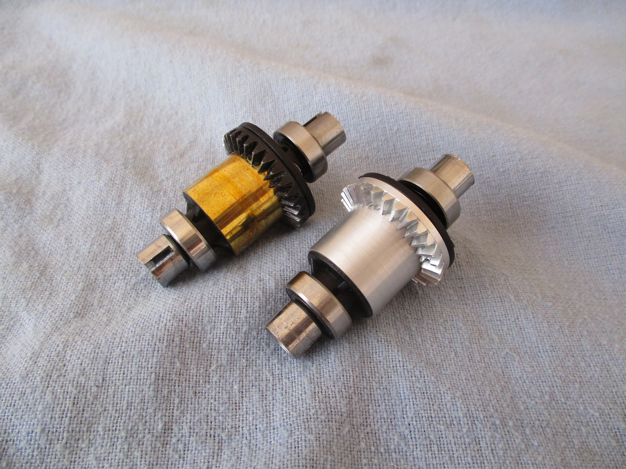

In the optional parts list for the Pro 10 it mentions a lightweight crown gear, lightweight diff output shafts and a lightweight diff box. Fortunately, I already have the lightweight output shafts. After some searching, a pair of lightweight crown gears were found. I had to machine the diff box covers out of aluminium to finish the lightweight parts trio.
Here's the result. The lighter diff is in front of the heavier diff. The brass/steel diff weighs 43.2 grams. The aluminium one weighs 35.5 grams. Both diffs are now converted and installed. Original Schumacher cut spike tyres have replaced the re-release Schumacher tyres. Now I've got to find the optional front one-way hubs.
