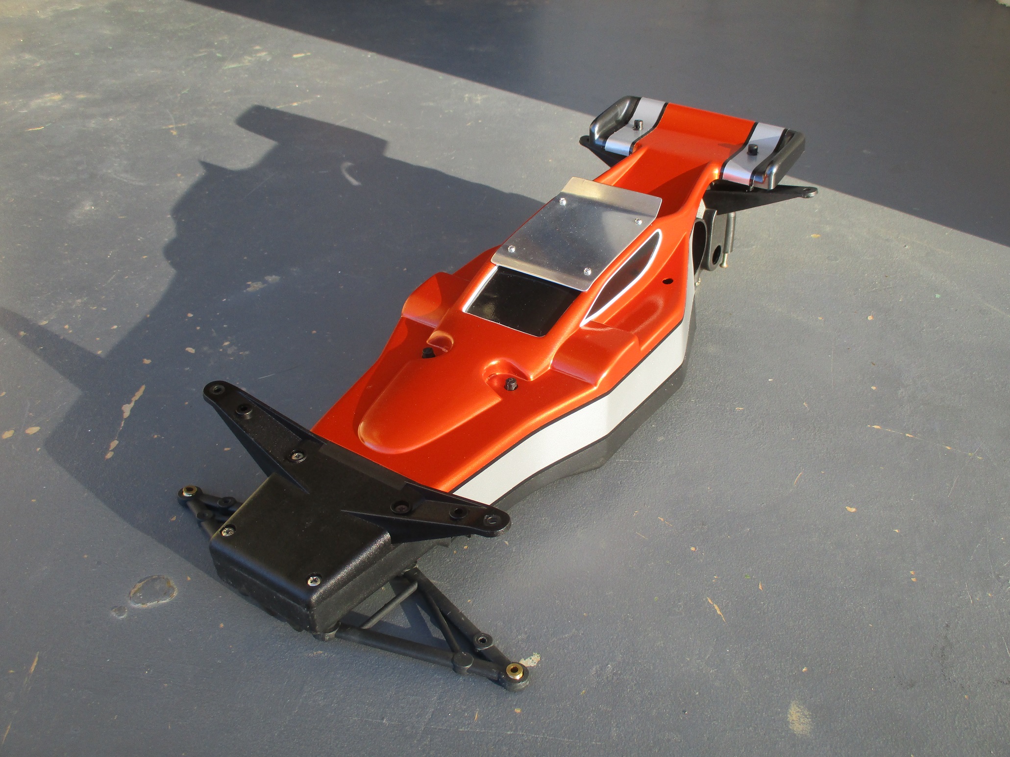

This is how I bought the car. The paint is terrible. The chassis is in really good condition.

I've looked at these when they come up and had much the same response as you , curious , too rare for an organ donor for a Coyote , very fragile looking .
It's kind of got Mcferson strut suspension all round without shocks , odd choice .

Absolutely. The suspension is a strange choice for a buggy. In stock form it sits high off the ground with the arms at full droop. The springs seem a little stiff. If you've seen the two YouTube videos on the Navajo it bounces around a lot on rough terrain. I may have to wind softer springs for it. Surprisingly, it has a fair amount of suspension travel.
